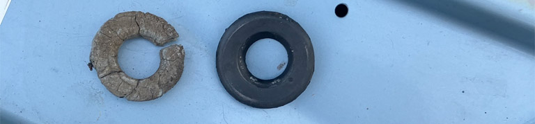

went to PNP for a wiper motor gasket
found this GEM
new grease, gasket, sealant, vacuumed out the debris

Wow, Pick-n-Pull is the very last place on the planet I'd expect to find a good rubber gasket on a 30-40-yo car. Nice score!
Idk why the original one was so bad, I dont remember them going bad. The rubber gasket sits out of the sun.. Im more lucky that there was a 240 in the yard!
