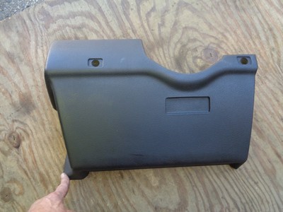

@242Bleek can you elaborate on the drivers side knee bolster? Picture or part number reference? I don’t see I’m that it came with the replacement dash I received.
Also, wondering if anyone has any spare dash receiver grommets that insert into the firewall and receive the dash alignment dowels. One of mine broke upon removal.
Also, I did confirm the heater core was leaking…very apparent after I removed the ac suitcase.
Any dash after 90 or 91 I forget the year uses a drivers side knee bolster. They only come in black too from my experience. They use an additional bracket that mounts under the dash that holds the lower portion of bolster. Here's a link to one.
Your best bet is to match up the interior color with SEM color coat interior paint. As long as it's not brittle you can make all of it look brand new.
Some random pics of the floor work.
@242Bleek it looks like the knee bolster in that link does not come with the additional bracket. Thanks for the tip!
