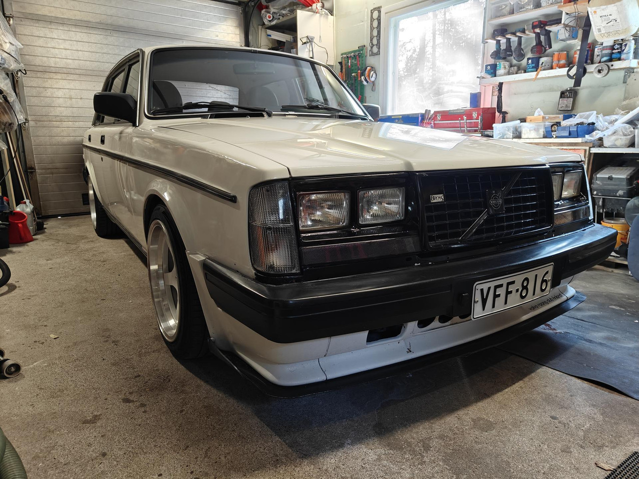

Changed the light setup to H4/H1. Dunno what the wiring should be, but I just took the high beam wire from original H4 and connected it to H1. I also did put bumber trims on, seems fine, but needs some adjusting, glue and paint.

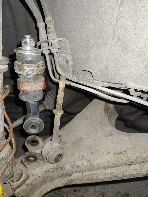

I changed the swaybar end links, and body pushings. I grinded the stopper from end link and made new stopper from long nut that I cut in right lenght for sways being in neutral position. I think that this made the handling best so far with this car. No bump steer amymore (y)

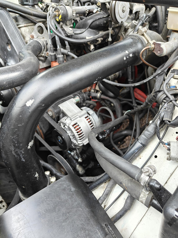

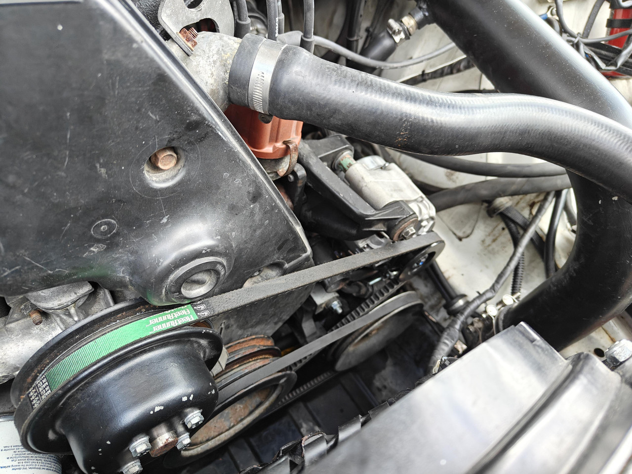

Car smells only after driving, speed may affect, not sure. I discovered that PS pump suction hose clamp was broke and PS fluid came out slowly from there. CI changed the clamp, but noticed that alternator is pushing the hose too much. I decided to change the alternator to smaller unit. Not so long ago I changed one Toyota Auris alternator and noticed how small but goodish power it had. I bought a "Denso style" alternator, made some mods to mounting and wired it to work. Now we have clearance and same ampers that stock had (65A).

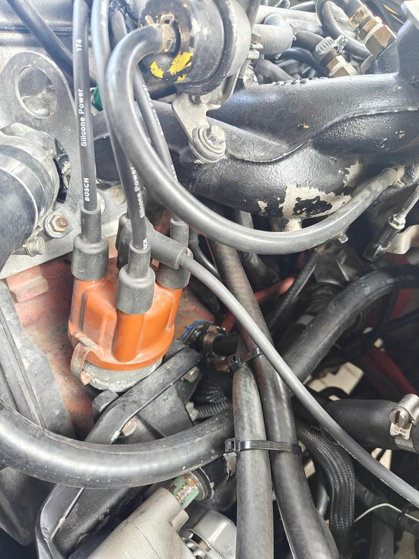

I bought a new PVC box but it can wait a bit. I have seen somewhere a picture where someone had added extra nipple to additional breathing, but I didn't gind it with google search. I want to add an extra breathing point to fuel pump plate that is next to distributor.

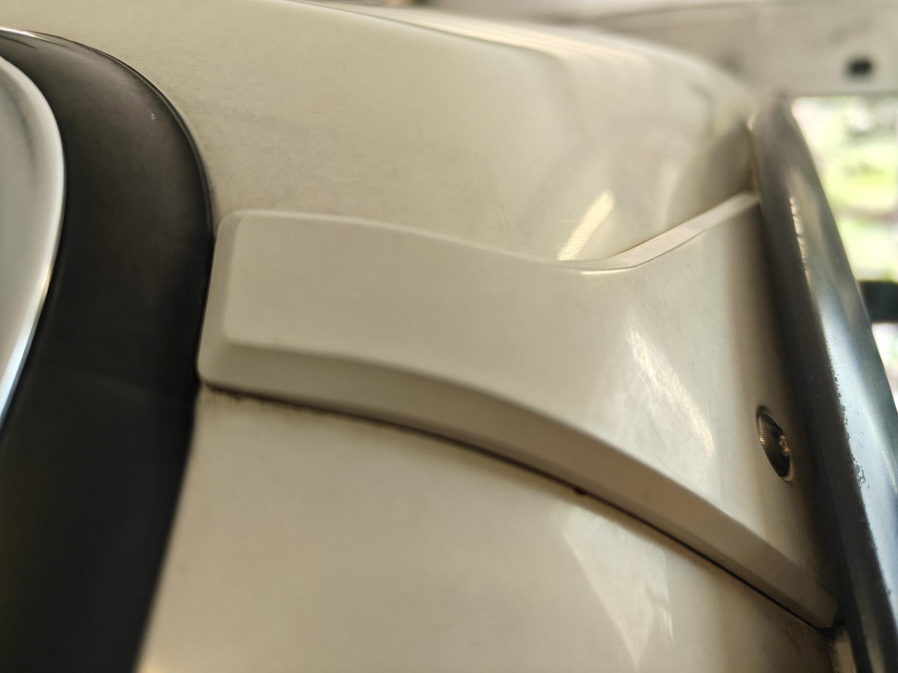

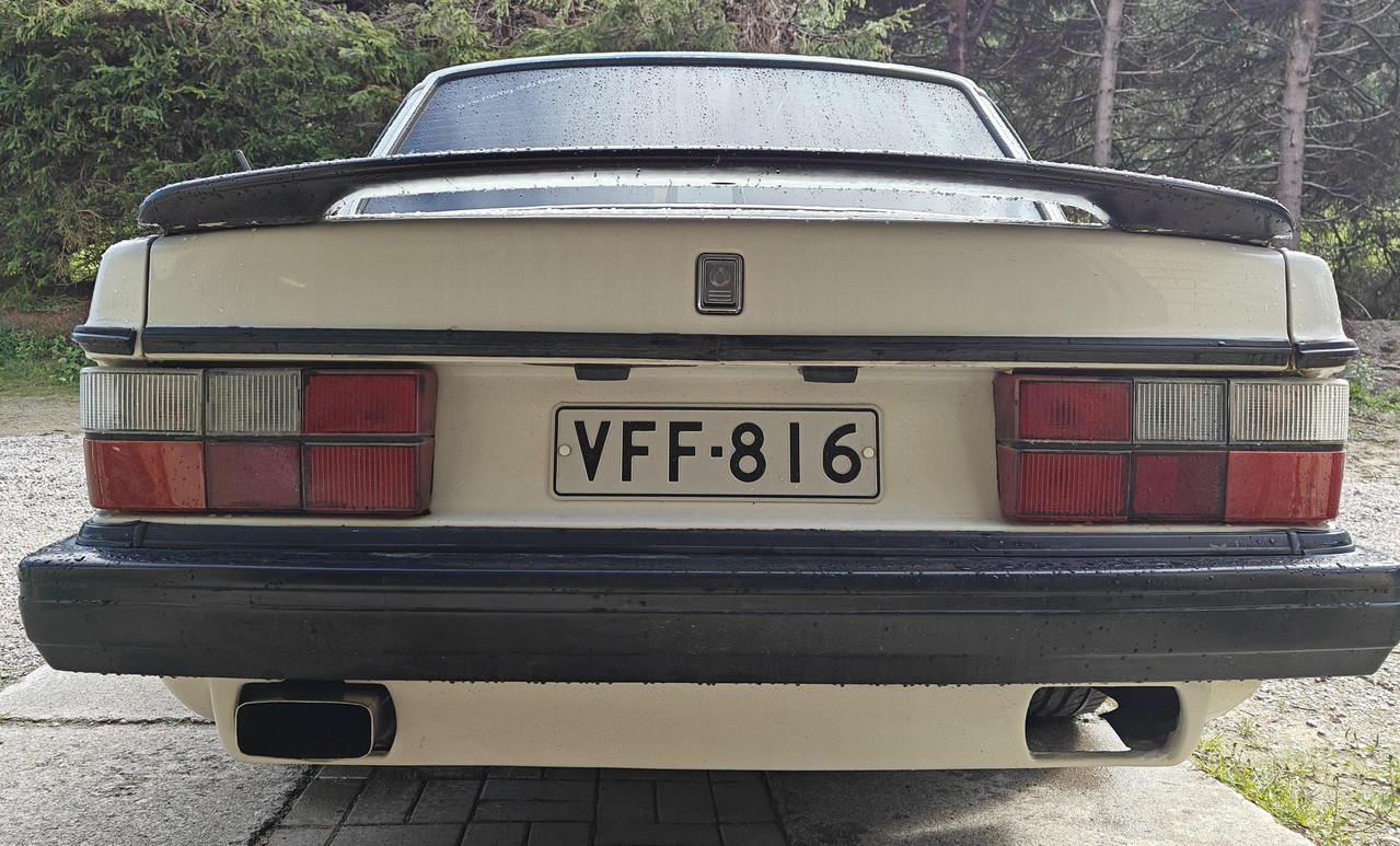

Next I'll reseal the tail lights and make the shine again. Clear turn signal lenses and those tail lights were the first thing that I have done to this car.
I couldn't find the same rear light varnish, and lower out corner lenses may have faded too much, so I need to buy new ones at some point.
I had some color mitch-match on rear corners (there are few different whites still in this car 😝). I sanded the old stuff out and repainted both sides. They came out good enough for now. There maybe a point when car gets a full over spray at some point.

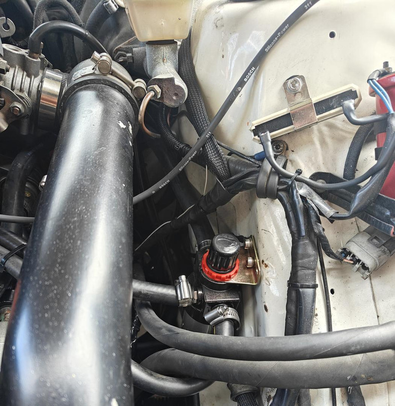

Car has had some oil fume scent still but MOT went fine. I ordered new breatherbox at spring when this saga began. So after MOT I changed the PVC box. Not majure success with smell. Next I added a "catch can", I found that people have used pneumatic water extractor, so I tried that. I am going to use proper catch can later. I drove it and found that catch can catches some petrol rather than oil. Then I did remember that I had an malfunctioning -025 AMM (used part from 960 Volvo). Maybe bad oil causes the smell? I used syringe to suck some oil out and added new. Dunno, maybe that it helped a bit?

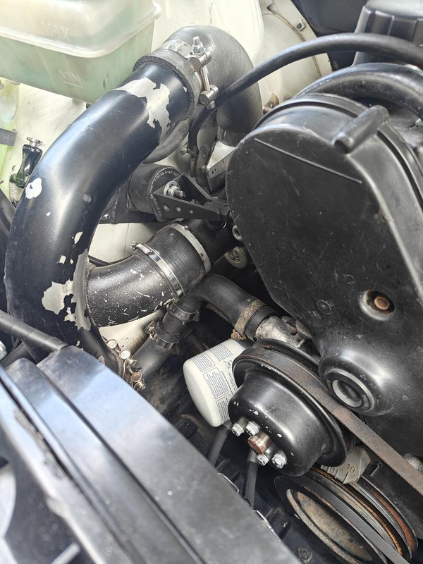

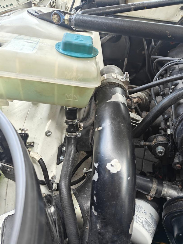

Turbo didn't have a coolant circulation, so I desided to add one. Have used cheap coolant hoses, so there wasn't much pain to cut excisting ones. I couldn't find the mitsu coolant pipes from my staches but I had some Garrett ones. I welded some banjo fittings and T-couplings to circulate coolant to turbo. There were no leaks so i may upgrade the hoses to Do88 ones during winter.
Next I changed new oil and X1R oil additive. Some pulls and it smelled some times, some times not. I added a breathing line from fuel pump flange directly to catch can. Same time I upgraded suction fitment on turbo intake to larger size.

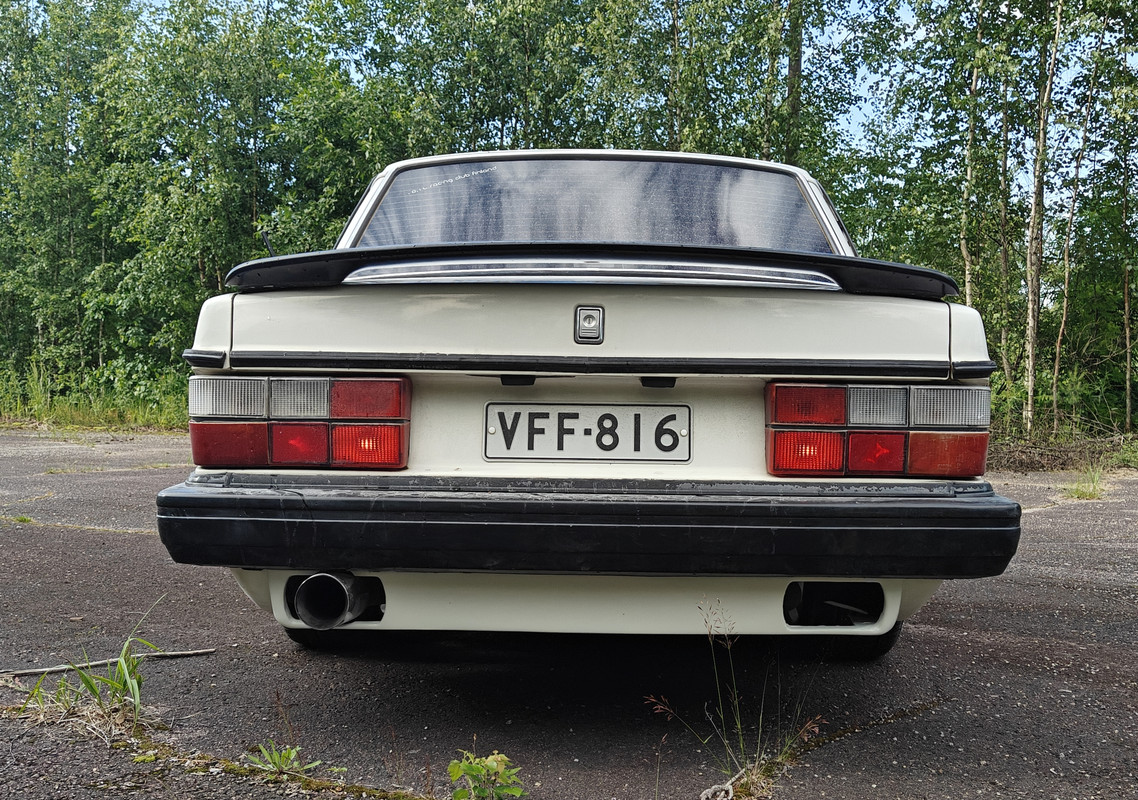

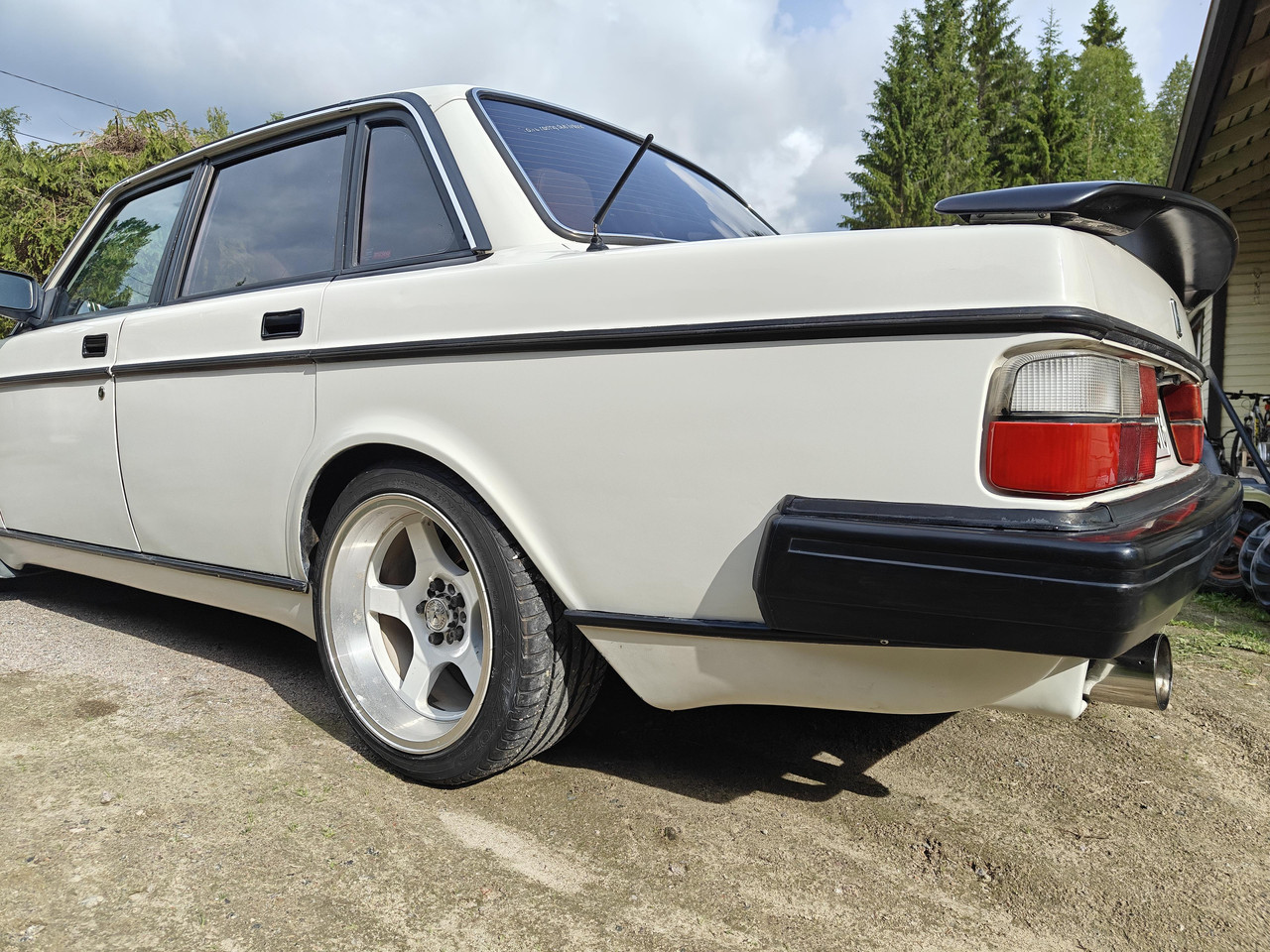

Bought some welding wire that is suitable for stainless. I had some scrap stainless so I tried to do new exhaust pipe end. Skirt needs some love some time, but this boxy end looks good to me.

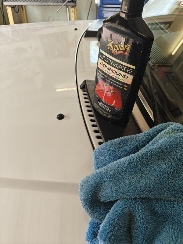

This time I used a Mequiars Ultimate Compound to polish and added somekind of (cheap) ceramic coating.
