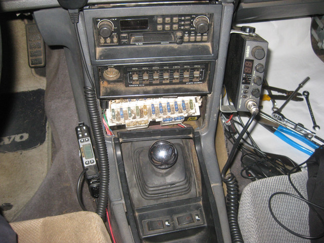

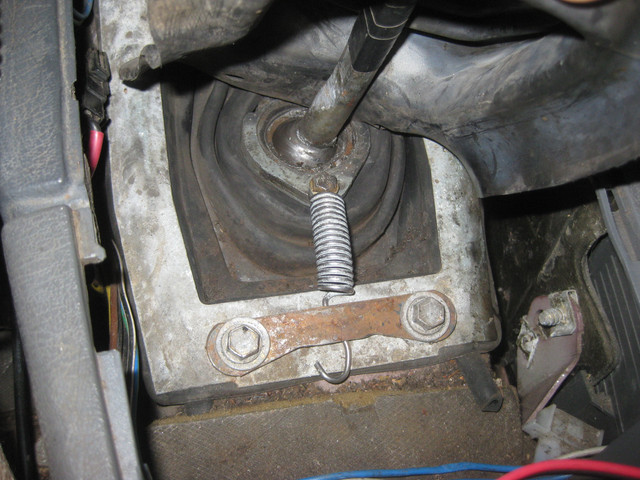

Drove down to Monmouth visited Farm Boy Phil. On the way back in McMinville the shifter bracket bolt fell out, one of two. Made it interesting to get it in the correct gear for all the miles home. Anyway using the stock getrag shift bracket with volvo ball welded to it and had it held up with a bolt and rubber bushings to the tunnel. That ripped out also. I instead now have one spring at the back to hold it up. Works great!

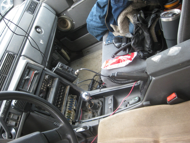

Got my rear speed sensor wire hooked back up and speedo working now after not working for a few years. Got right to this spot and wanted to take a pic but it hung there for miles and miles and miles so I forgot about it, then later looked and it was 25 miles past 550k... Dammit. ha
