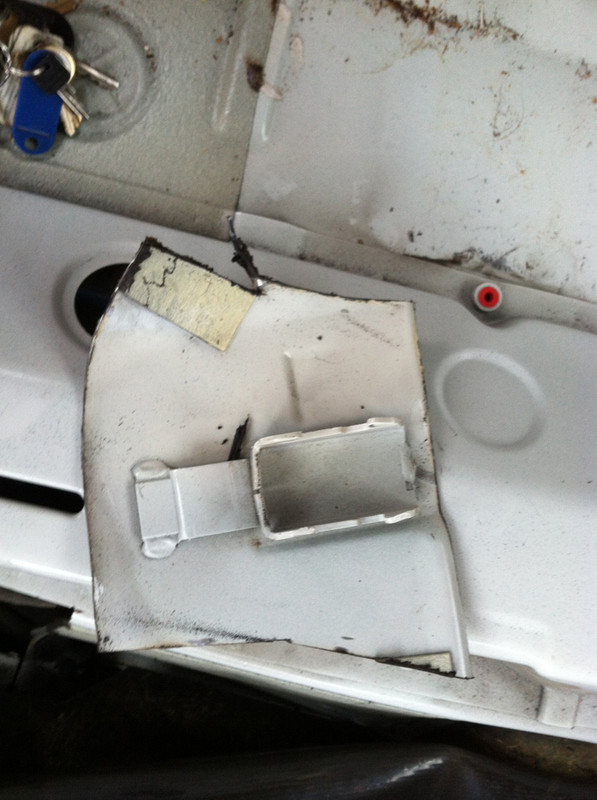

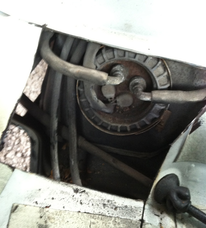

The shortcut / faster options for replacing the fuel pump are:
1. Loosen the fuel tank hanger straps, then use a large prybar (think 2x4 or similar) to force the tank low enough to get the pump out.
2. Cut an access panel through the body near the lower pivot point for the passenger side rear seat, then remove the pump without touching the fuel tank, and rivet / bolt / weld the cut piece of sheetmetal back in place.
I've done the "fast" options 1 & 2 as well. The factory way is good if you want to repair some other things in that part of the car, but is a ton of work for just a fuel pump replacement. Removing so many parts also risks causing other problems while you're in there.
Shortcut 1 works decently, but you need to be careful about prying since the fuel lines on top of the tank are easily damaged. I have only done this method with the car on a lift, so no idea what the logistics of getting the rear of the car high enough off the ground look like or how feasible it is to carefully force the tank down while lying under the car.
I used the 2nd (cutout) easy method to remove the pump on a parts car, and it was super quick since I didn't care about being neat or resealing the opening when I was done. That said, @lookforjoe (Hussein) did that on his XR build, and it turned out nicely so it's more a case of being careful about how you make the cutout. Maybe Hussein has some photos he can share, I can't find any right now.
@Kjets On a Plane This what you remove on either side to access the pump on right side & the crossover (if needed)
I made a finished removable cover, those pics are gone along with all my PB pics
