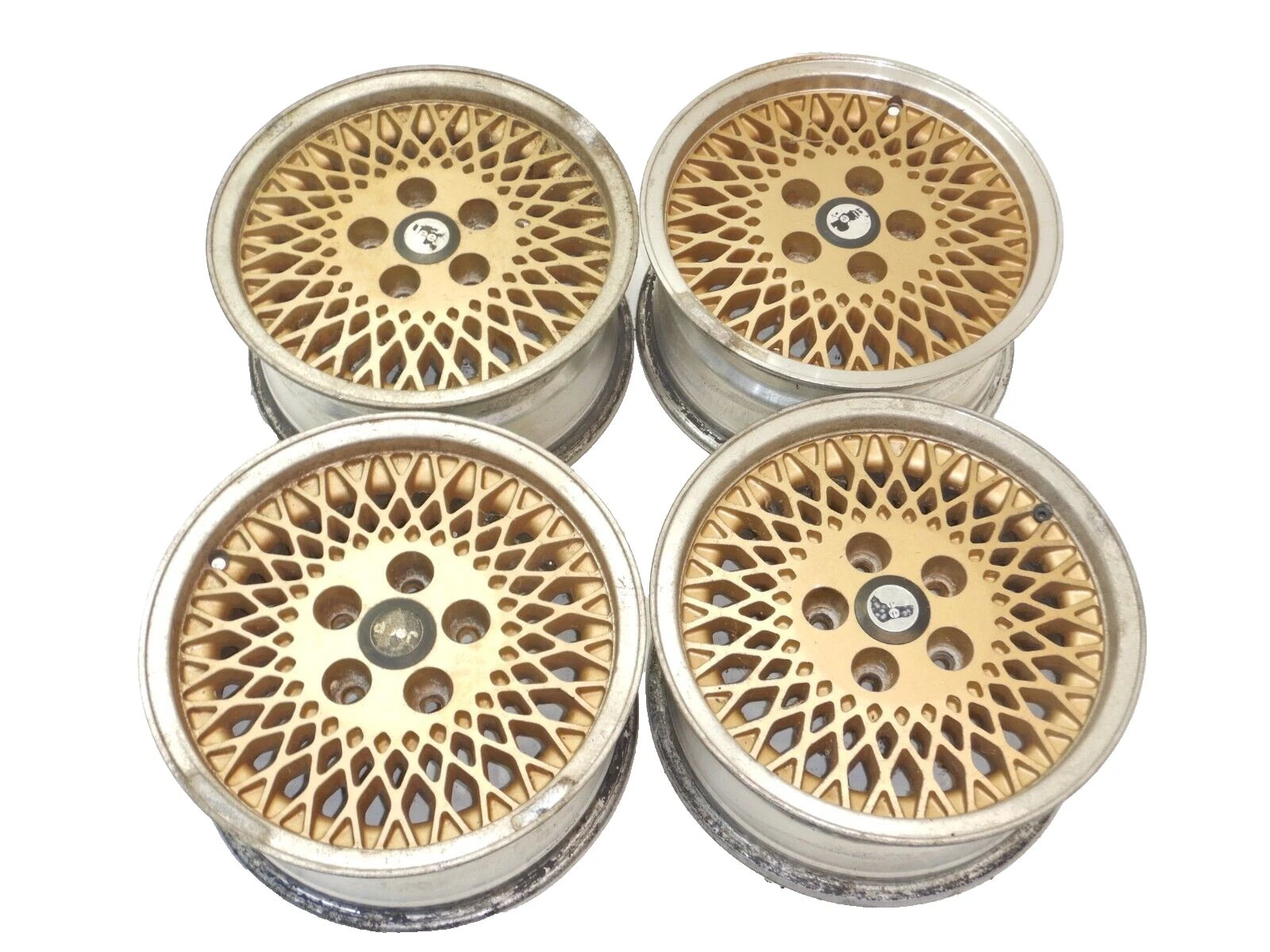

The "middle setup" - I found Jeep Cherokee lace/snowflake/multi x's to be a decent alternative. Can be had super cheap on FB market, CL, eBay etc. They are super beefy and the downright look right on the 240. Only problems - with my new Wilwoods up front you could barely fit a few sheets of paper between the inner rim and the caliper. Also, to obtain the right offset I was going to need to run almost 4'' long studs and 20-25mm of spacer [offset on those wheels is 35-40 ish mm] for the wheel faces to clear the caliper also to have just enough threads on each lugnut catch to feel even remotely comfortable.
