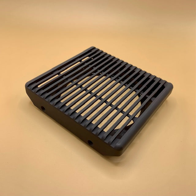

My buddy 3d printed me a set of these. They fit any standard 5.25 speaker and come with covers you can put some grills on or just snap them on to make it look better.
