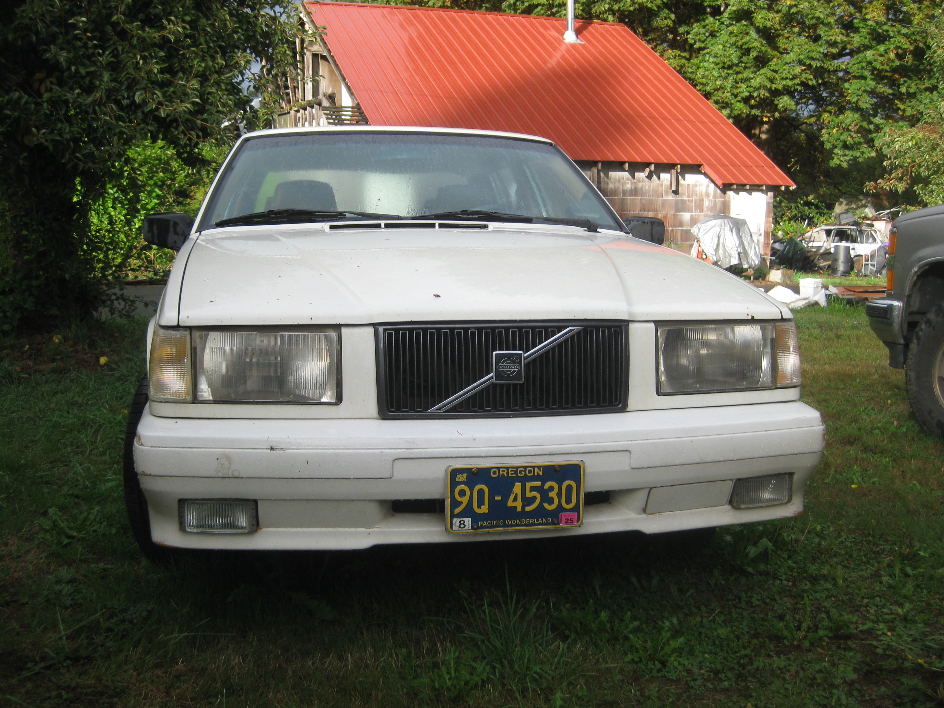

Ohh yeah the se bumper will bolt right on any 1990 or newer 740 or 940 doesn't matter what headlights you have will fit and bolt right on fine. As far as more pointy? No it does not stick out any more then the normal bumper... Uses same bumper shocks.. It looks bigger out more front as the lower valance part of it is more pronounced then the normal one and deeper.. But that is the SE bumper cover part, underneath same bumper.

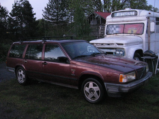

Here are the usa fog with plastic replacement lenses I sold.

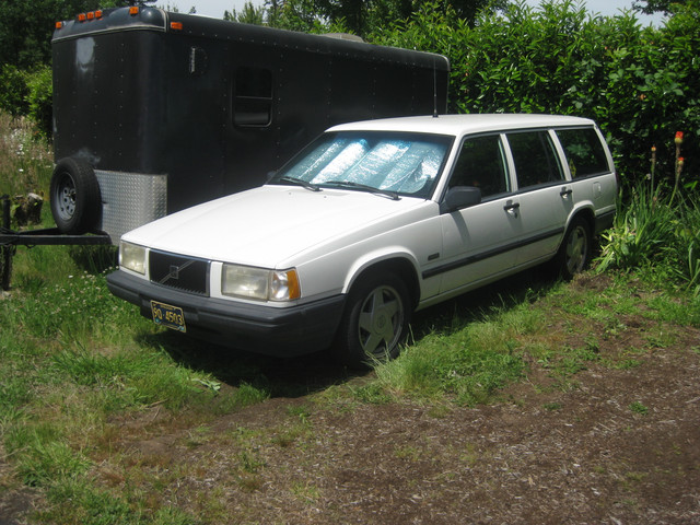

1990 non fog USA bumper and light stock..
Another 1990 non fog USA.
1995 940 non fog usa front!
1991 non fog wife's kids car, he wants me put manual trans in it now of cours..
They sure look all the same length out except the UK one looks further out.. The UK one is the only one I can't actually measure... Personally I never like the fog USA front light front end, probabbsly why I don't have one..
