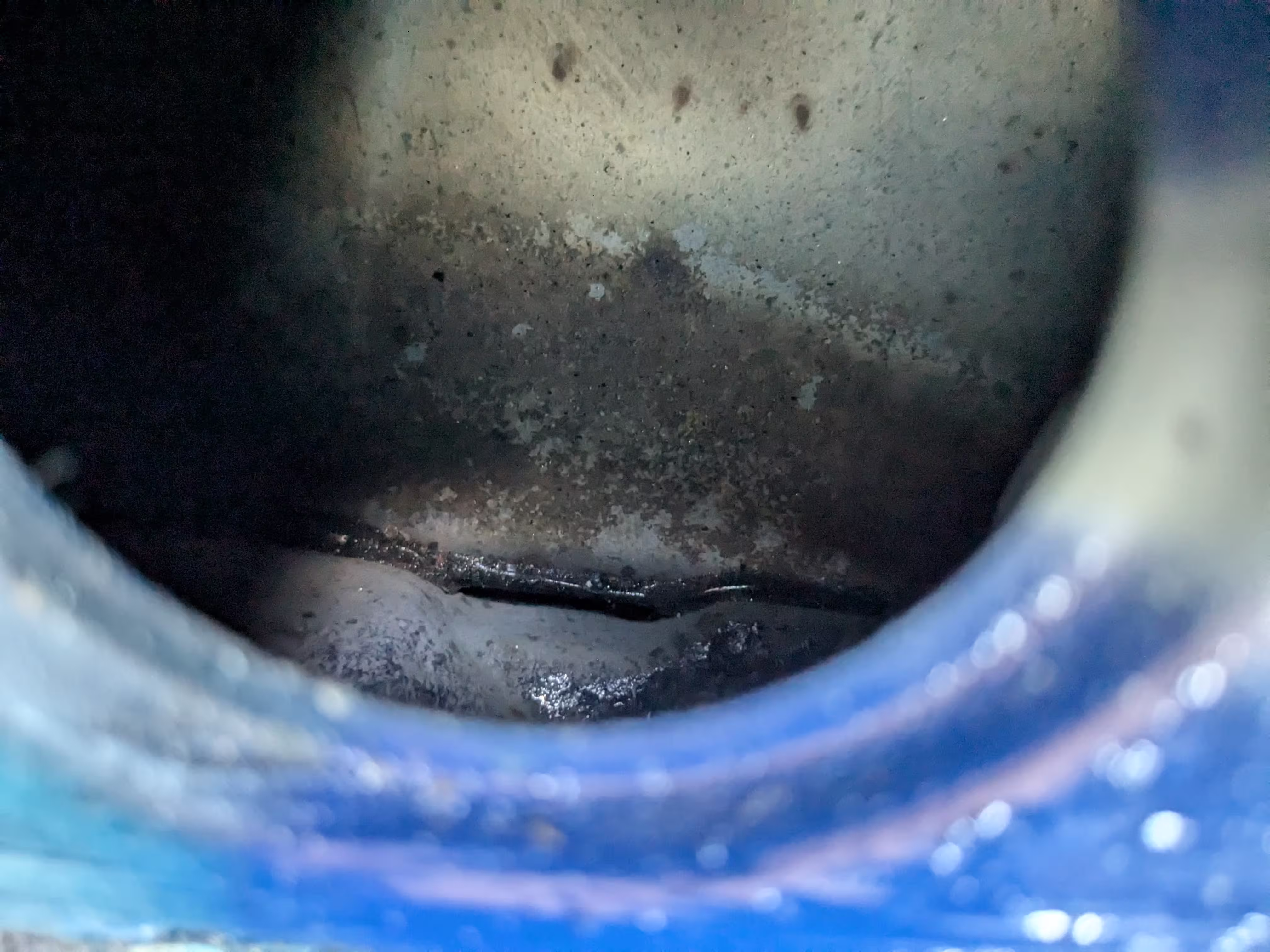

This was a good thought. I don't know what level of corrosion resistance this gives but it's probably better than bare metal.
In the collision repair world we use a weld-through panel bonding adhesive like 3m 8115 for corrosion protection around spot welds (and additional strength).
Make sure you finish up the repair with cavity wax, it'll wick into every little nook and cranny inside the rocker that paint/weld-thru doesn't.
Nice work :cool:
I used Lord Fusor for structural seams such as the roof seam - this just needed to seal the seam - I took a pic through one of the inner rocker openings, you can see that when spot welding it squeezes out & seals the pinch. I will also spray cavity wax in there to finish the job
