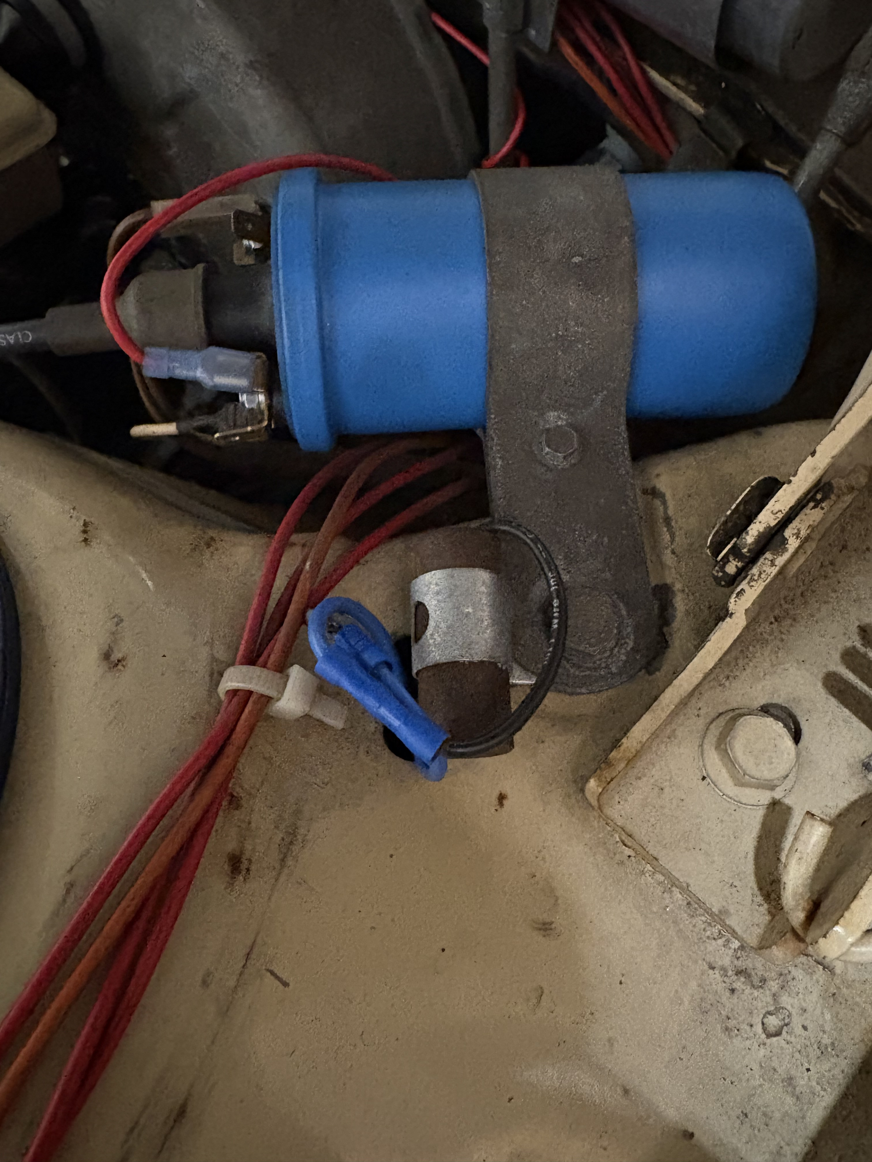

What's the resistor near the coil?
The resistor near the coil drops the coil voltage when running. When cranking, the coil is fed the full +12v from the starter. If you download the '77 greenbook TP12045 from ozvolvo.org/archive/, you can see the resistor on pg 16 (starter circuit) and pg 18 (ignition circuit).
When it's misbehaving, measure the voltage on the coil + (or 15) tab with key on and make sure it's not zero. (It'll probably be 12volts, but might be a bit less due to breakerless ignition behavior.)

This is what it looks like on mine. I think yours is inside your fender well or something if I remember right from previous posts.
Yeah the resistor on my car is mounted behind the grill area. I got it started back up again and drove it back home. It runs great and drives beautifully when it is running. I think I actually caused this issue myself when I recently installed my radio. I have been doing so much rewiring and replacing old wires behind the dash that I've kind of lost track of whats what. I should've been really labeling things better. So my radio I believe** has been draining the battery enough that when I do drive it far enough it doesn't have enough juice left to start the car again. The digital voltage gauge on my dash has been very helpful as I can monitor the voltage more precisely than the needle gauge. Im going to replace the alternator to starter wire and ground later just because I haven't yet. But I can confirm the alternator is still charging the battery.
