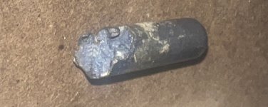

92 Volvo 240 engine chaos- What is this spring from my oil pan? What happened here?

Aluminum wouldn't break like that. That part looks more like a composite material.
I think you’re right. Thanks for the message. It was really stressful just randomly finding that next to my head on the ground. I’ve had enough chaos with this thing.. I don’t need any more.
I’m going to assume something randomly ended up in my driveway and try not to think about it lol.
