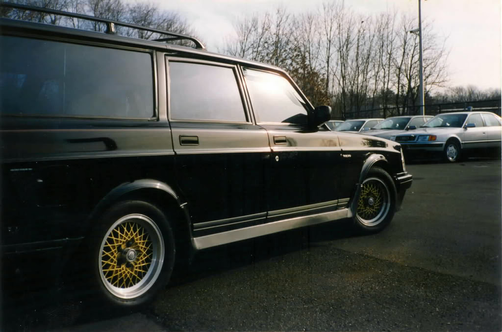

Almost twins. I think I'd go ahead and delete the rack on the '93. Are those the same rims from your black 245 on Matt's '78?
Not bad on the battery price. Was looking at their website and they wanted something like $475 for the same battery.
I was expecting it to be somewhat more. I bought it from Ithaca foreign car, I don't have a working relationship with a garage up here as I did downstate so I was expecting a couple hundred.
The roof rack will go away. I do have the ipd plugs for now.
Pretty sure they are the same MSWs that I used back in the '80s on my 245
