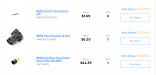

Nice fan conversion.... that 960 fan just about swallows up that 2 series radiator. What temp set points does the BMW contacts close at, presumably low and high?
I ran some Conti belts for a while, and they were crap. I run now OE belts (if you can find them) and real GATES.
I don't recall the values - I'll look it up. The low speed comes on right as the operating temp clicks a tick over normal, and shuts off after less than a minute.

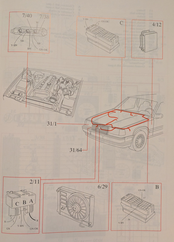

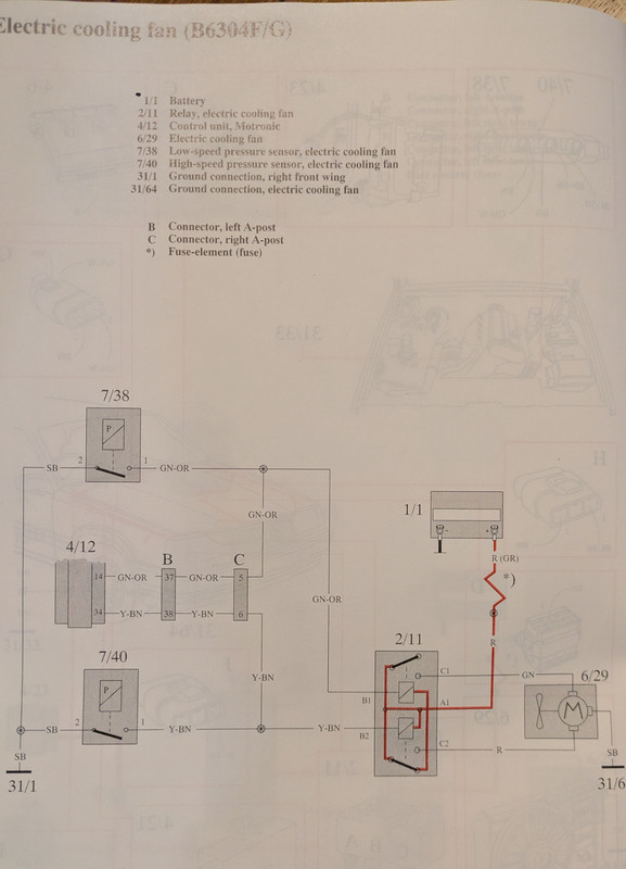

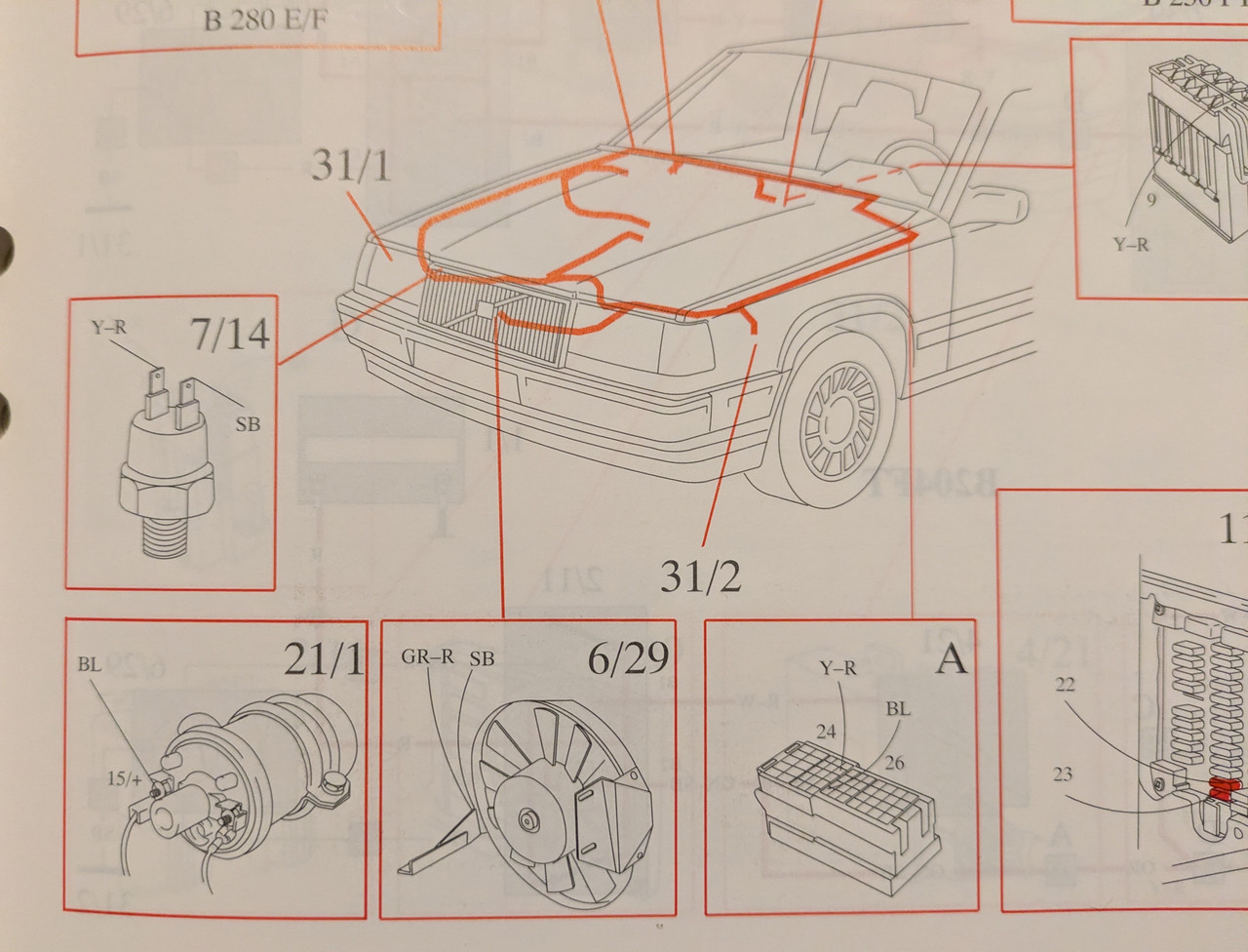

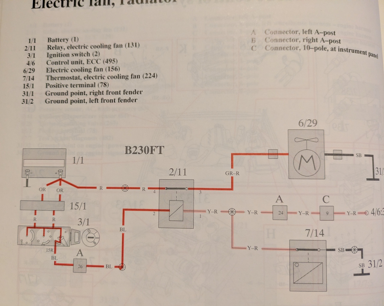

Why do you need a BMW switch? How does the original Volvo electric fan works?
Sorry for my ignorance...
Good question!
The engine management on a 240, lh 2.4 in this case- does not have a provision to control an e-fan. Wiring diagrams below are for the 960, and then the 940 SE. The 960 uses input from the EMS, and the AC pressure switches to control the two speeds of the fan. The 940 SE uses the older style fan in front of the radiator and the radiator thermostat switch. Later versions of the lh24 used in the 900 series turbos, incorporates fan speed signals (grounds) to govern the two speeds of the fan.
Using an external (to the ECU) thermostat to control the two speeds, is the easiest solution for cars that do not have it integrated into the EMS- which is going to be the case for any car you would be adding this fan to.
The exception here would be if you were also converting the 240 to a turbo, and using the 940 turbo ecu's that have the fan speed controller.
Volvo never offered a switch of this type, so looking for an alternate manufacturer that used it was required.

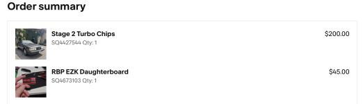

Bit the bullet on RedBlockPowered chips for the swap. Stage 2 -
I have the 025 3" MAF (thread with some discussion), 954 & gold EZK. Either 15g or 19T will go in. Stock turbo cam - have to look into these listed options

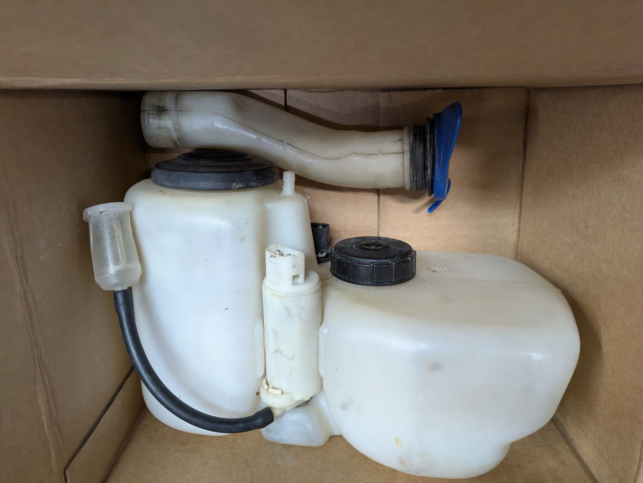

Washer tank arrived, thank you @ 2manyturbos :)
Will be used when I do the +T install
example install - Matt LeRoux's Black '93 245 LH2.4 B230FT

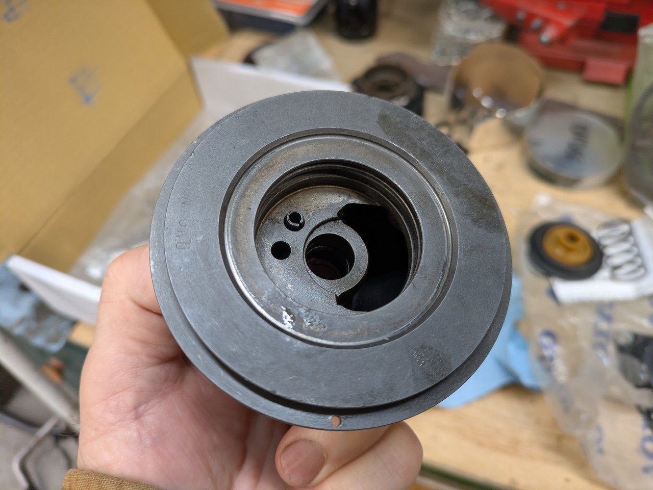

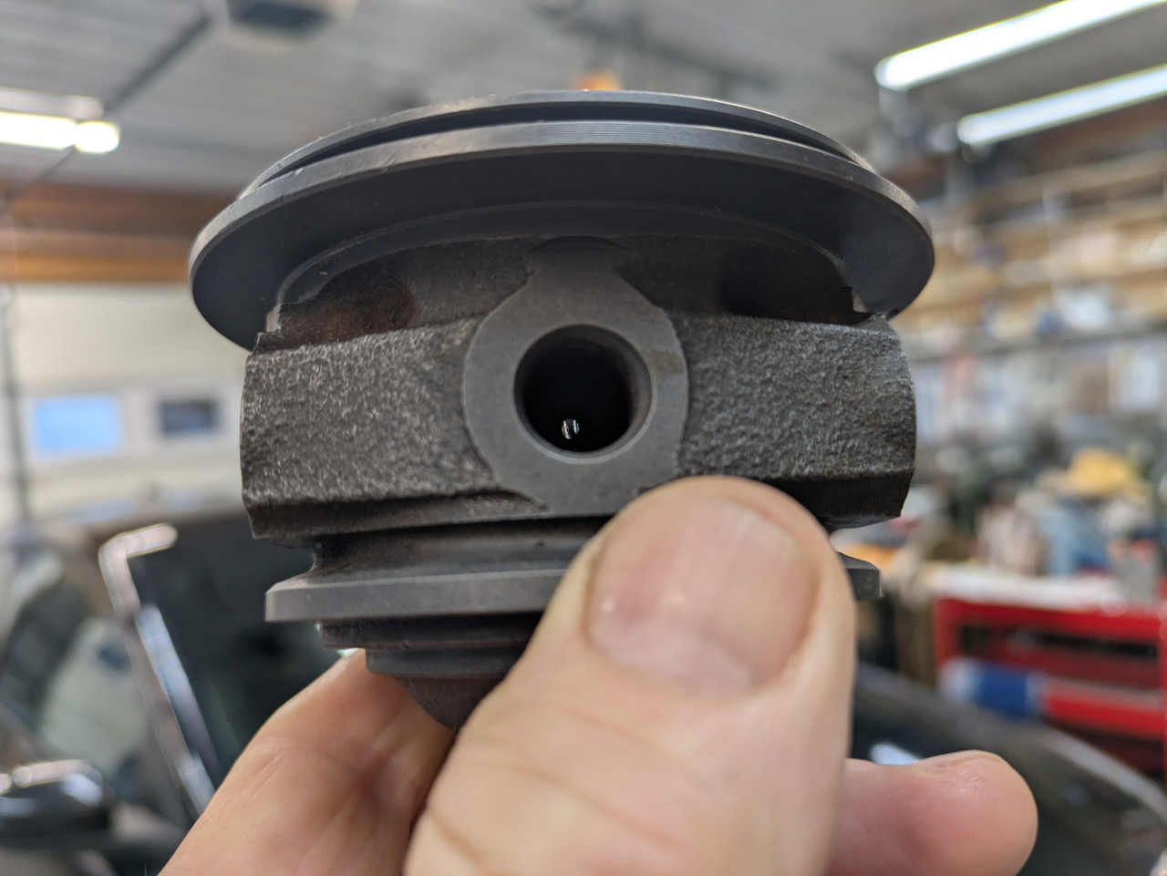

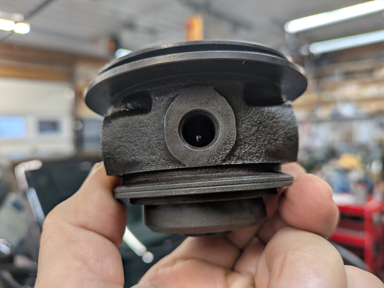

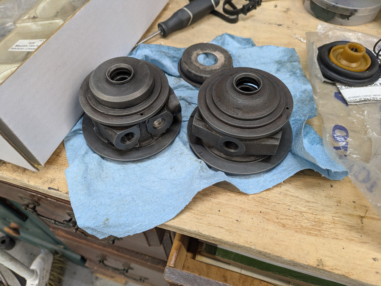

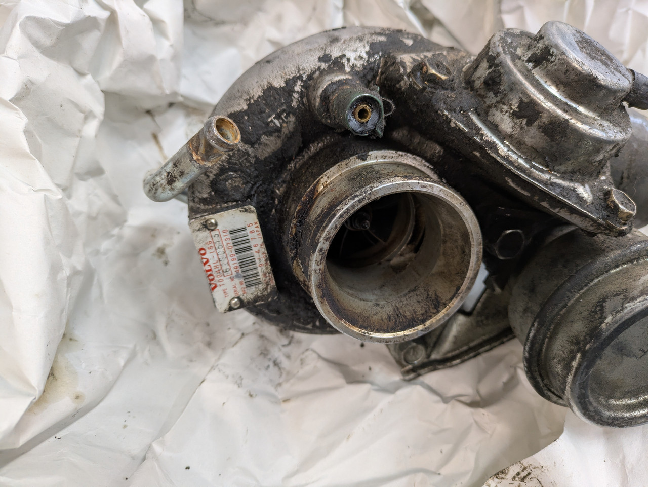

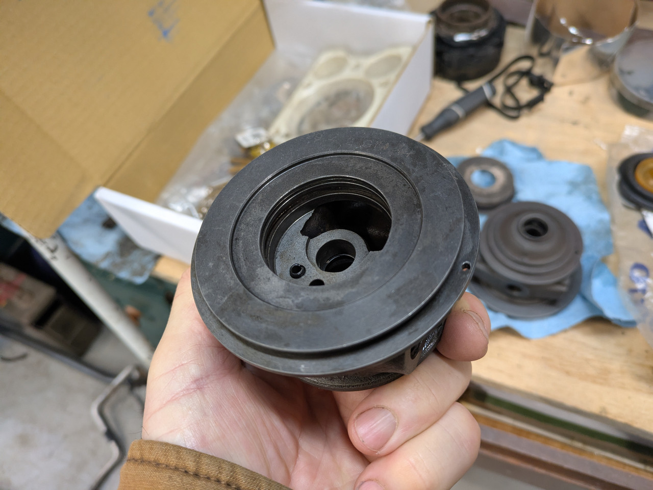

Cleaning up a couple of TD04HL cartridges.
What's critical is that the oil passage is clear - light visible com ing through
Get yourself a U-sonic parts cleaner if you don't already have one. Such a joy to pull out those sparkling Swedish parts before reassembly.
Lots of used medical grade cleaners on eBay; a lot of bang for the buck.
I don't - I'll have to look at that. My go to is a bucket of gasoline 🤪
