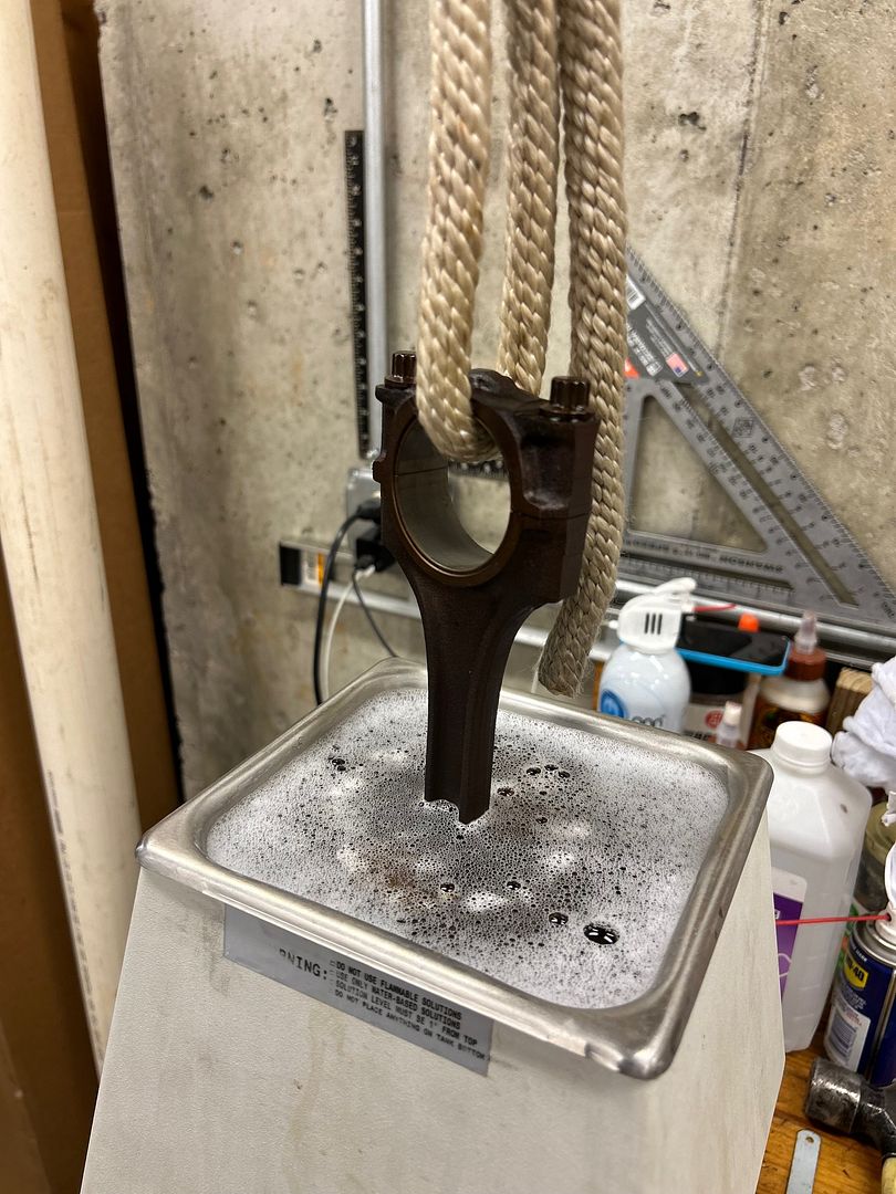

Get yourself a U-sonic parts cleaner if you don't already have one. Such a joy to pull out those sparkling Swedish parts before reassembly.
Lots of used medical grade cleaners on eBay; a lot of bang for the buck.
You can put gasoline in an ultrasonic... works even better!!!
What capacity should I be looking for - the sizes are all over the place. You're saying NOT a new Chinese one, look for a used one? I need a little more detail if you don't mind :rolleyes:
I'll send you a pic of what I use once I get home..... enjoying sunshine and gulf breezes at the moment. Made in Pittsburg, medical application, they are on eBay regularly.

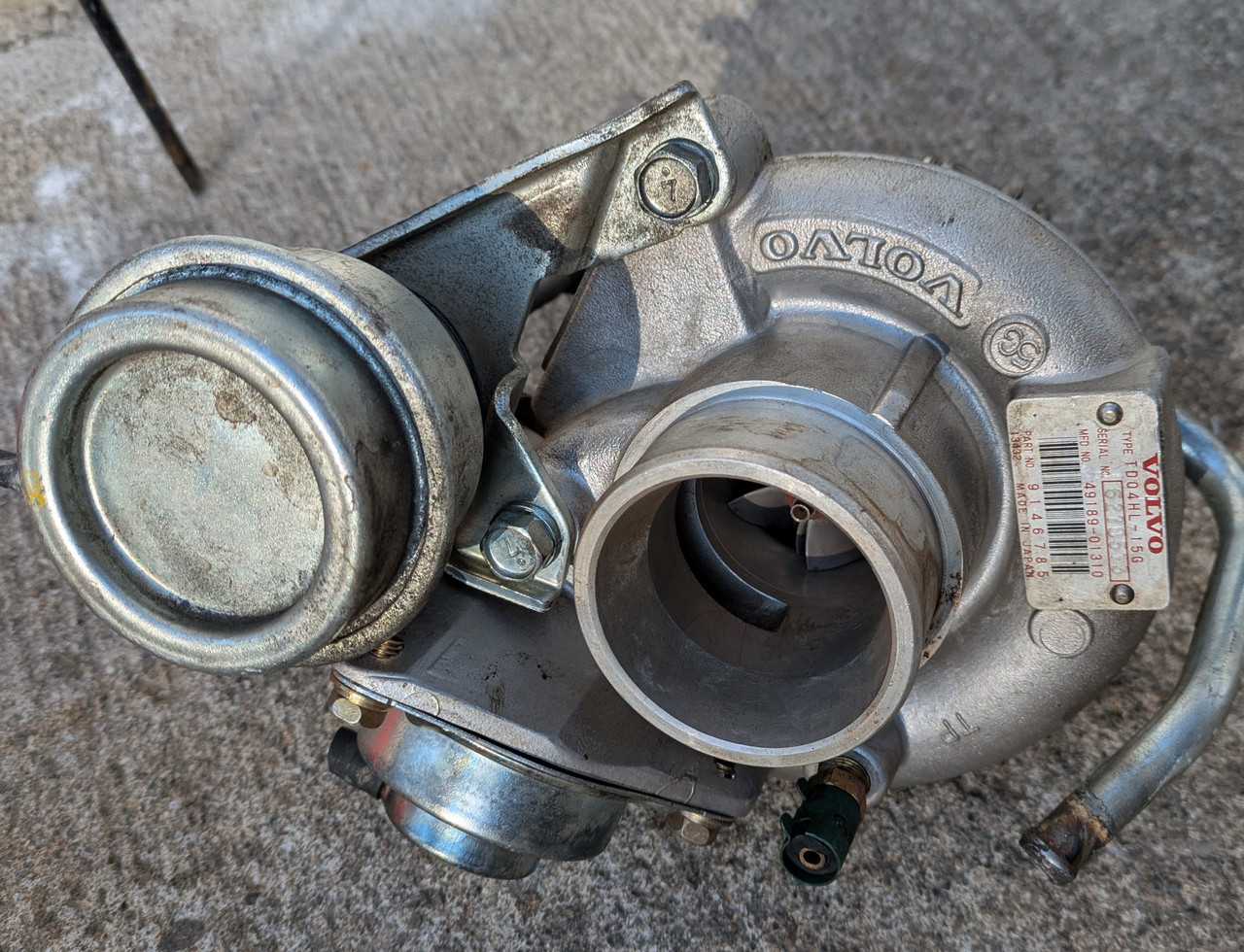

Rebuilt the 15g cartridge this afternoon. Quick & easy as I already had a CHRA I had thoroughly cleaned prior to this.
Washed with gasoline remove the oil coating

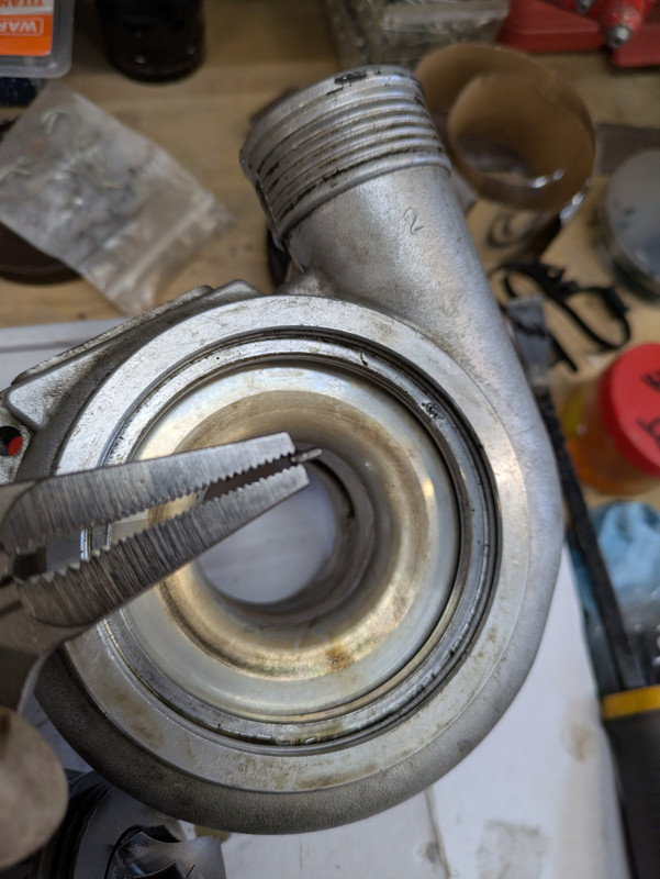

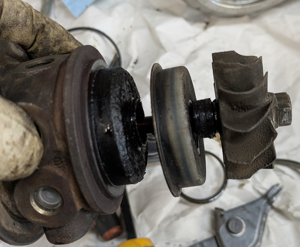

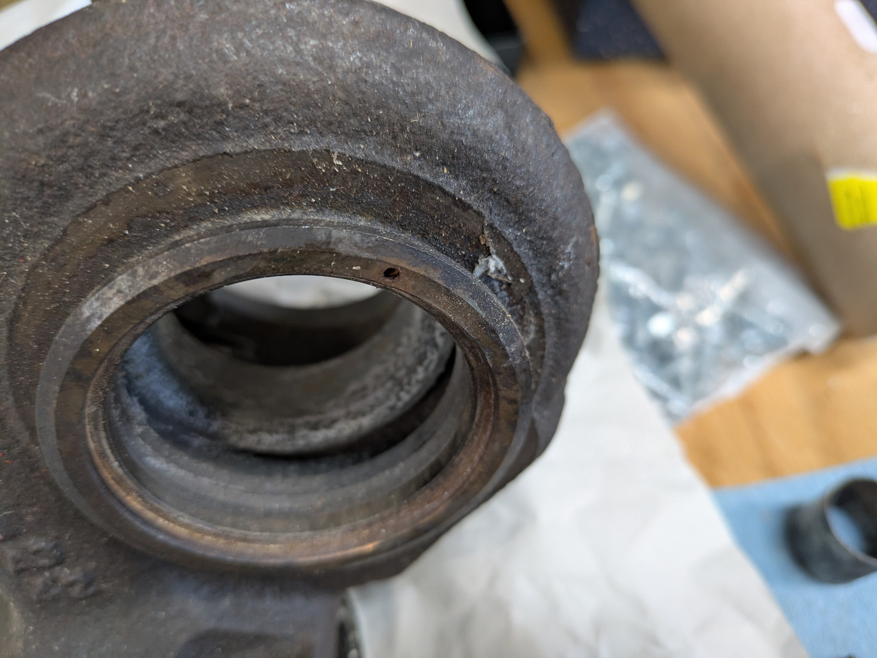

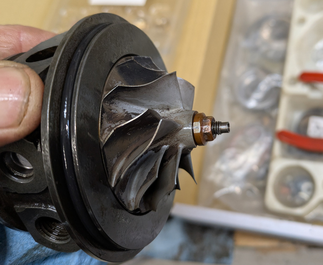

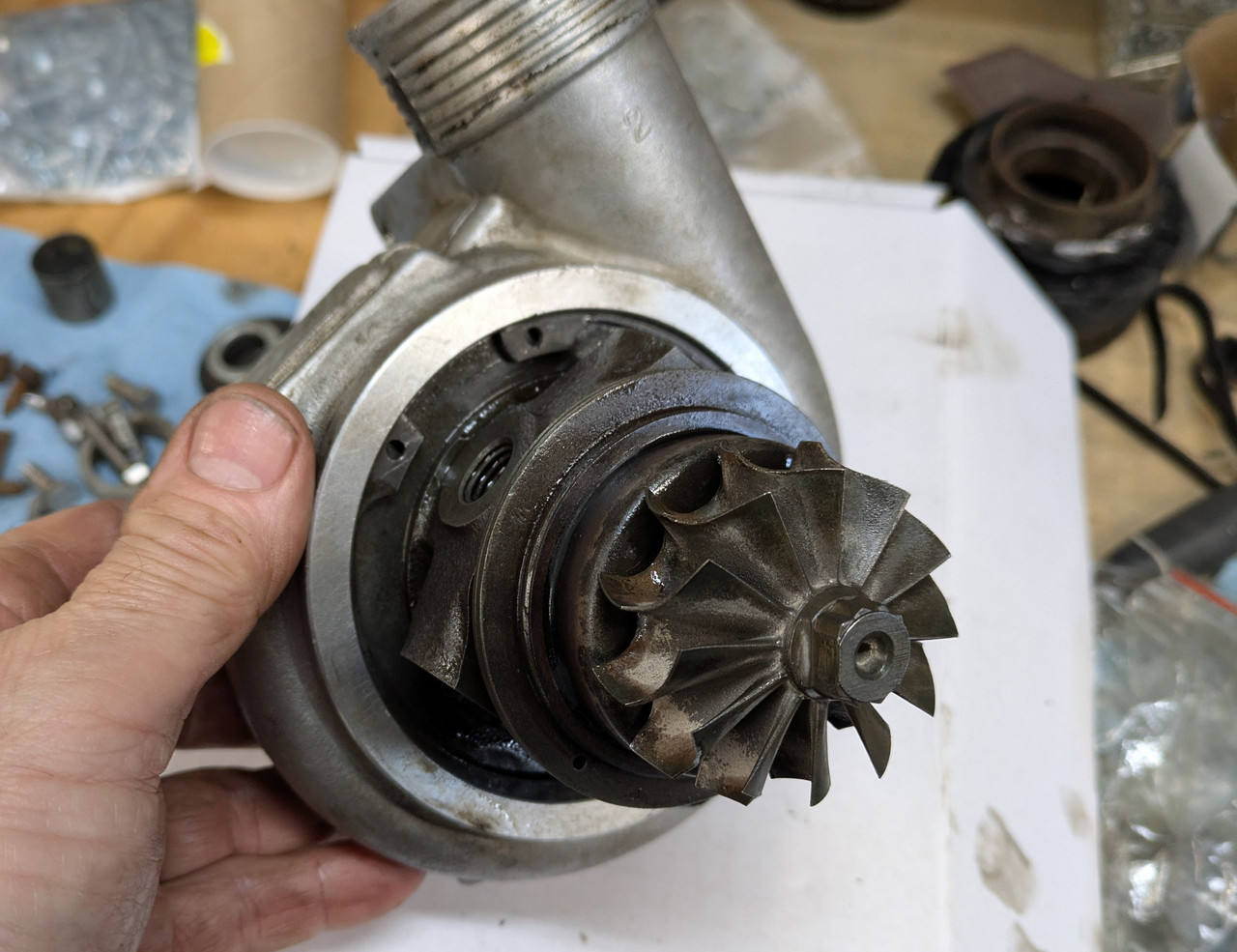

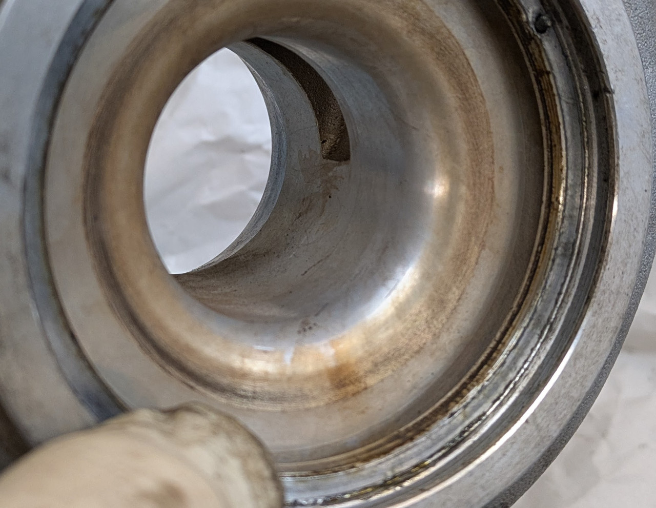

Housing removed, no wheel marks, which indicates bearing failure was not the cause of the problems with this unit
Mark the shaft, nut and wheel, so it can go back without re-balancing

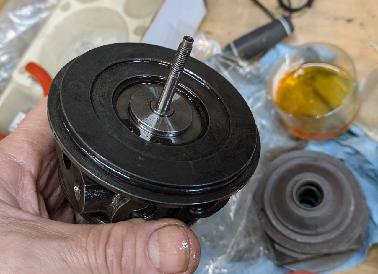

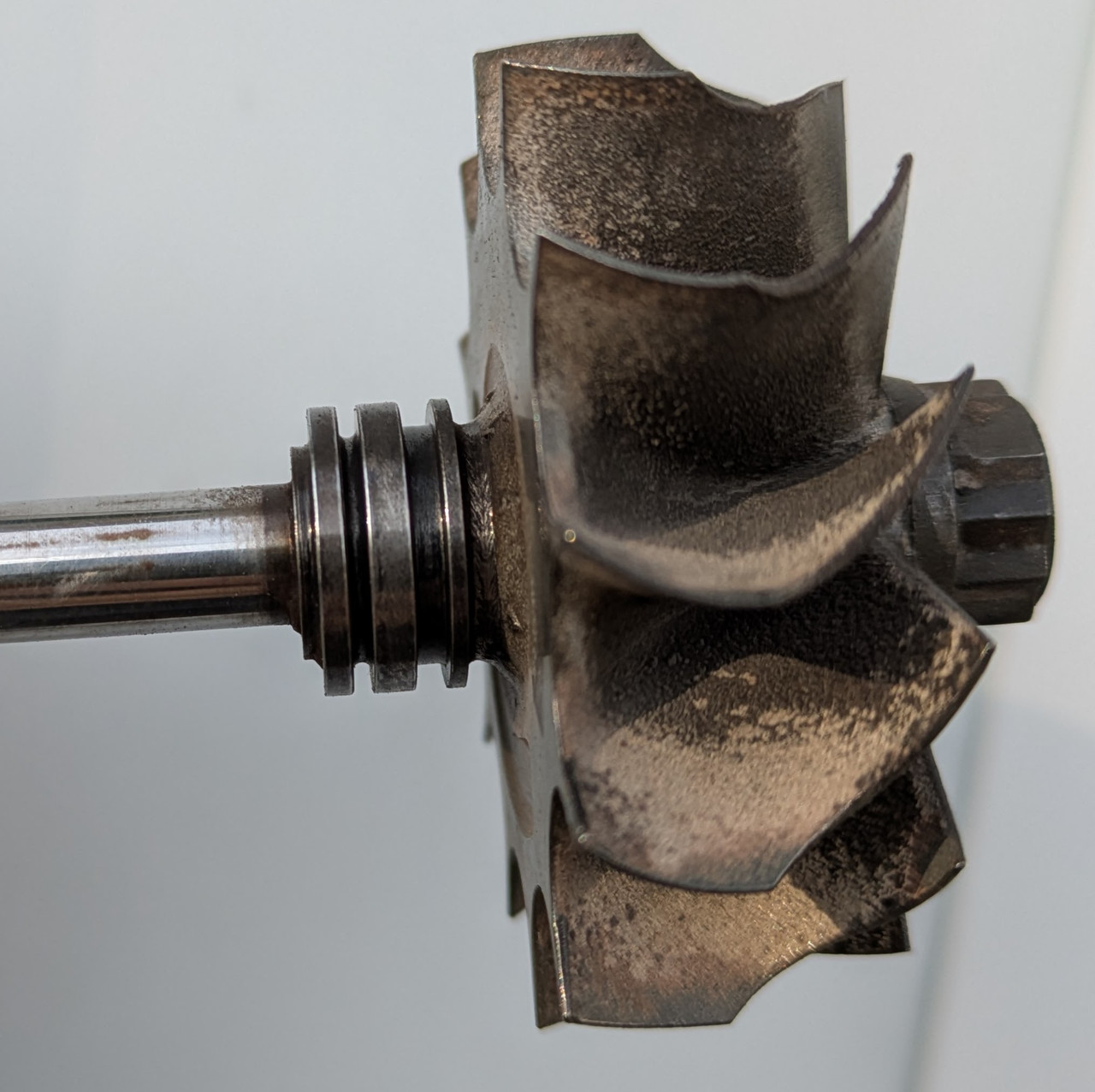

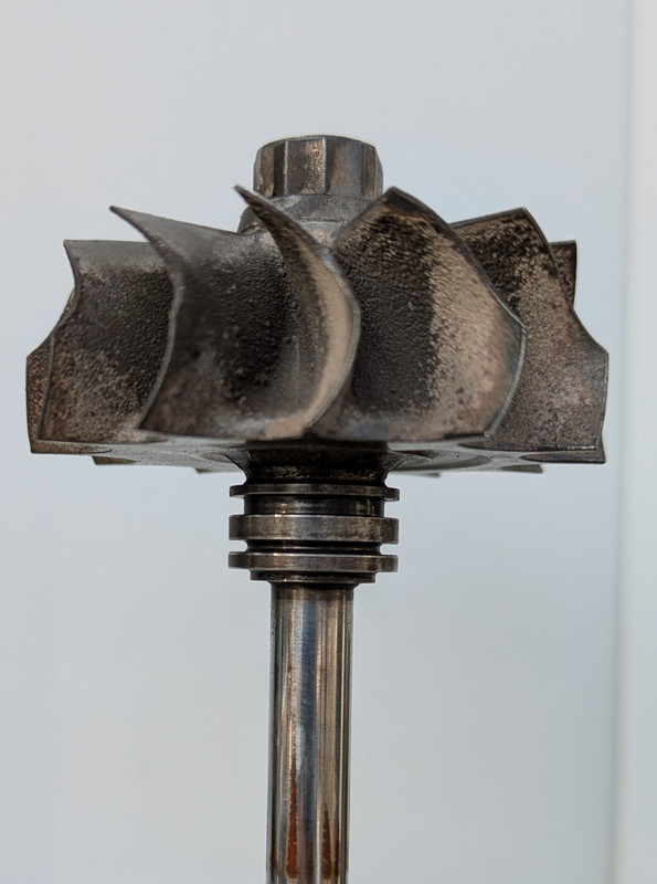

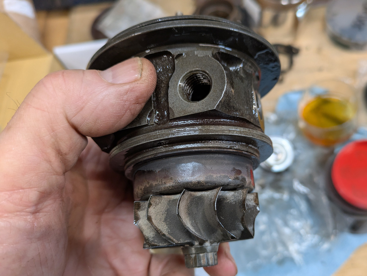

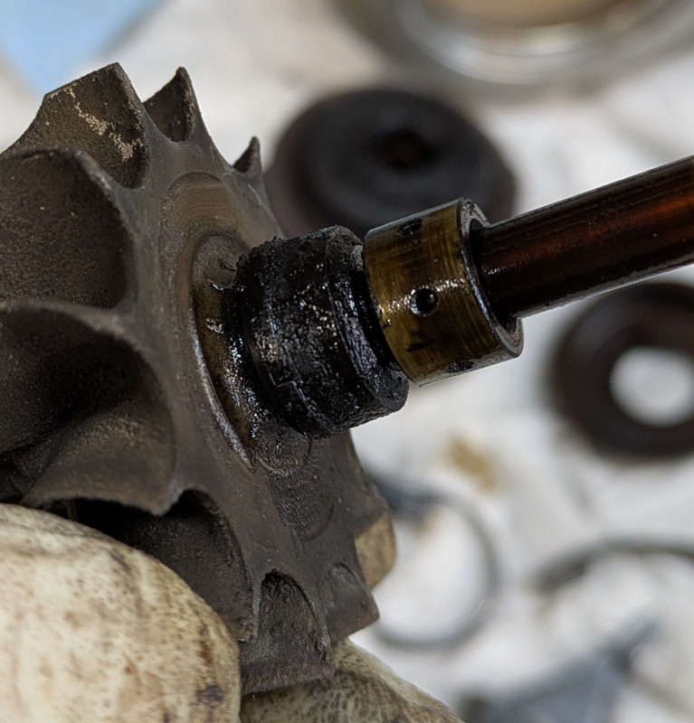

wheel removed, impeller & shaft tape out of CHRA - obvious oil control ring failure here

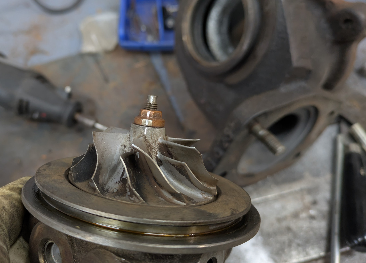

removed all the coking from the impeller shaft. Both the oil control ring seat & the forward groove need to be completely clear
New oil control ring installed one shaft, new soaked bearings installed, impeller pressed (by hand) back into the CHRA

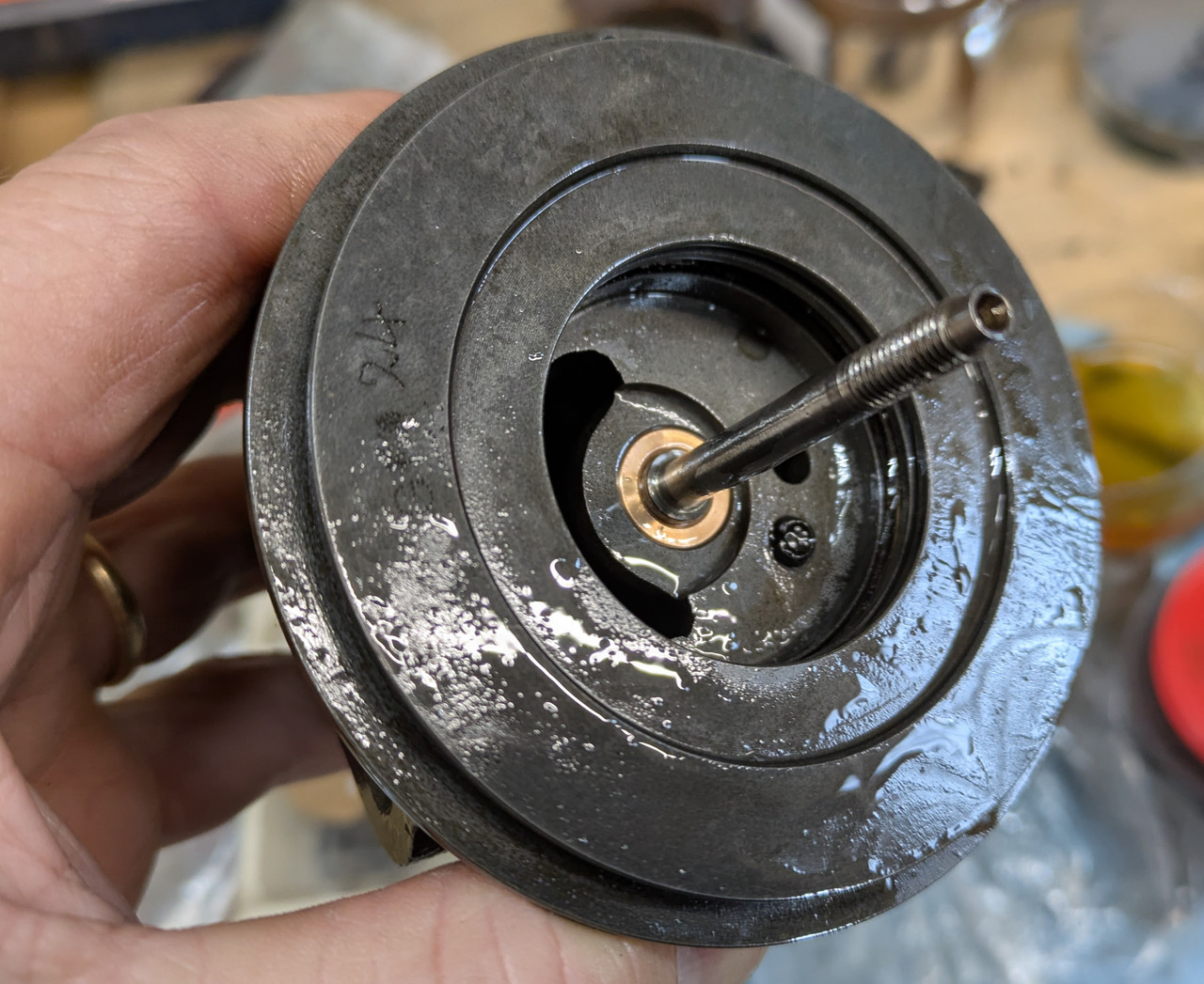

Thrust plate & spacer installed, new oring installed

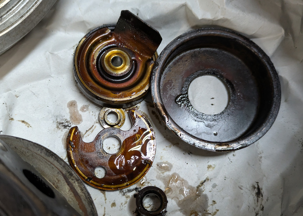

Old parts for reference

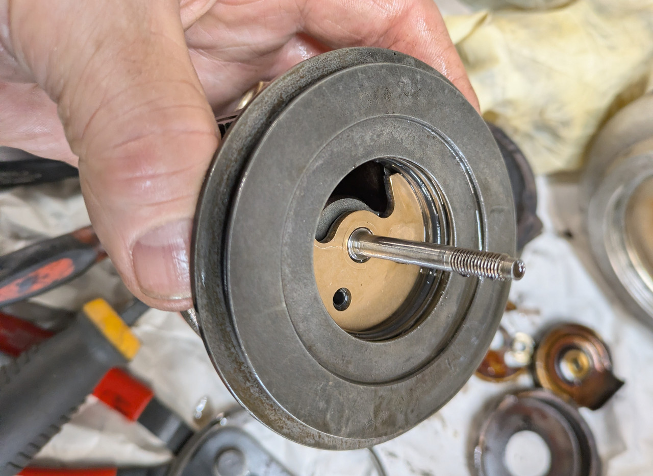

Oil slinger, forward housing w/oil control ring & carrier installed w/snap ring

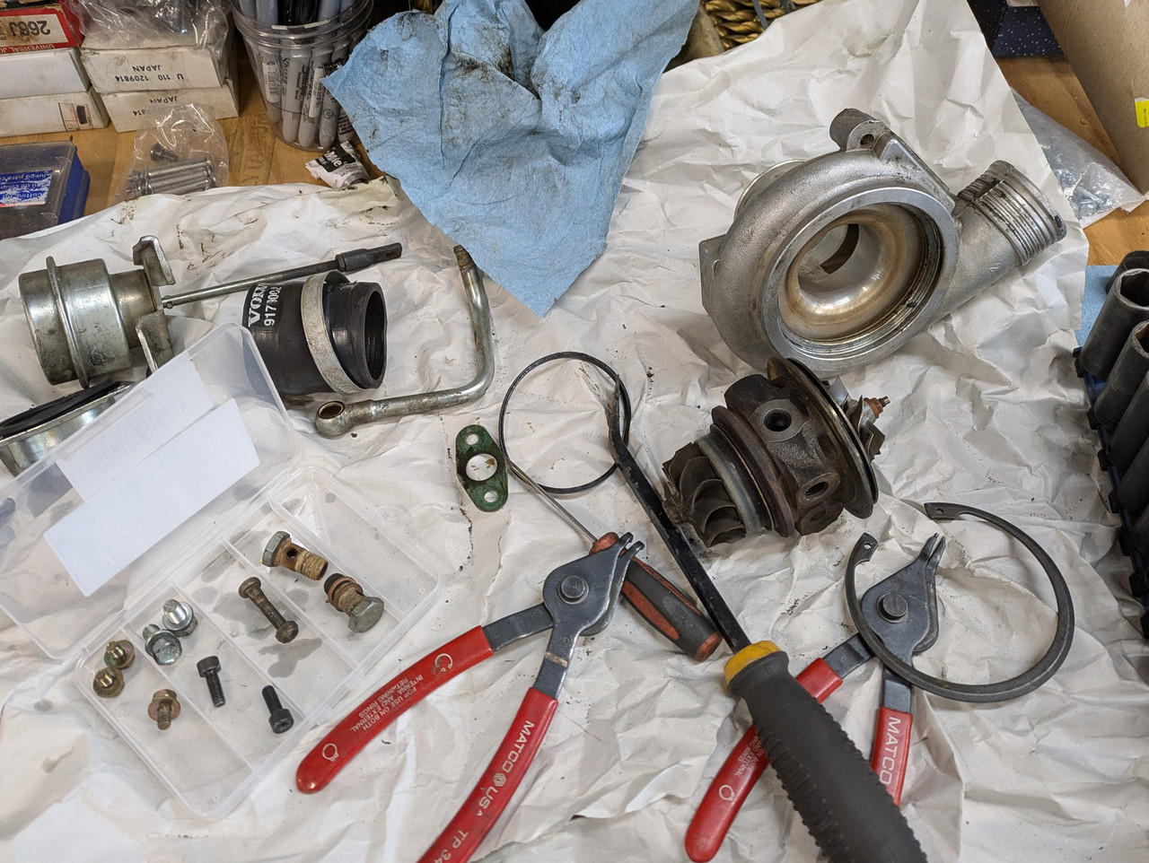

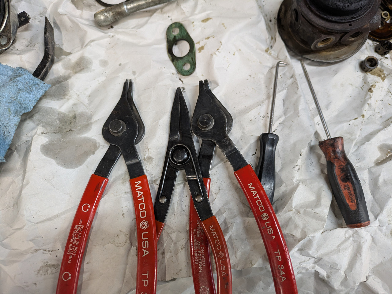

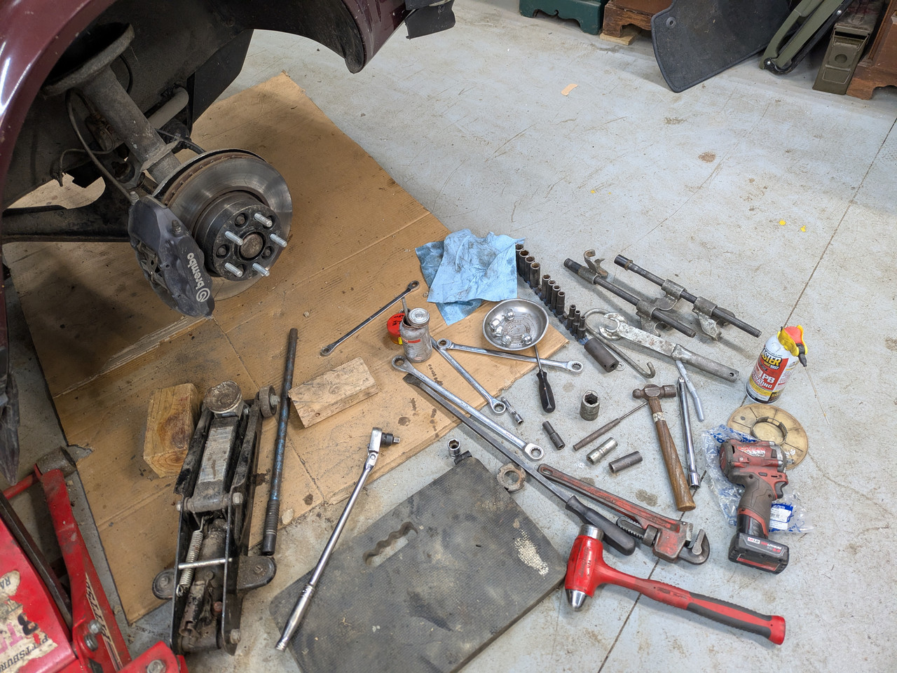

Tools I find extremely helpful in the job

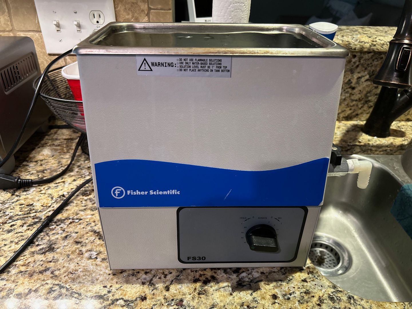

Here's a couple pics.... I have one large, on standard size:
Depth are identical, around 5". You buy stainless baskets to support items so nothing contacts the bottom. Simple Green HD, I cut it about 5 to 1 with hot water. Cleans like a dream.......
Thank you - can't tell from your pic what volume/ capacity your is - there is a wide range & prices range into the $4-500 range (!)
OK - the 3.7L 130W FS30 goes for around $200 used on eBay, without any basket. Larger capacity 10L Vevor 180W units go for about $120 - I'm wondering if the Fisher unit is substantially more reliable? There are also many of them for parts on eBay.

Pulled the alignment pins from the angle flange WG housing and compressor housing, so I can reclock for the RB install

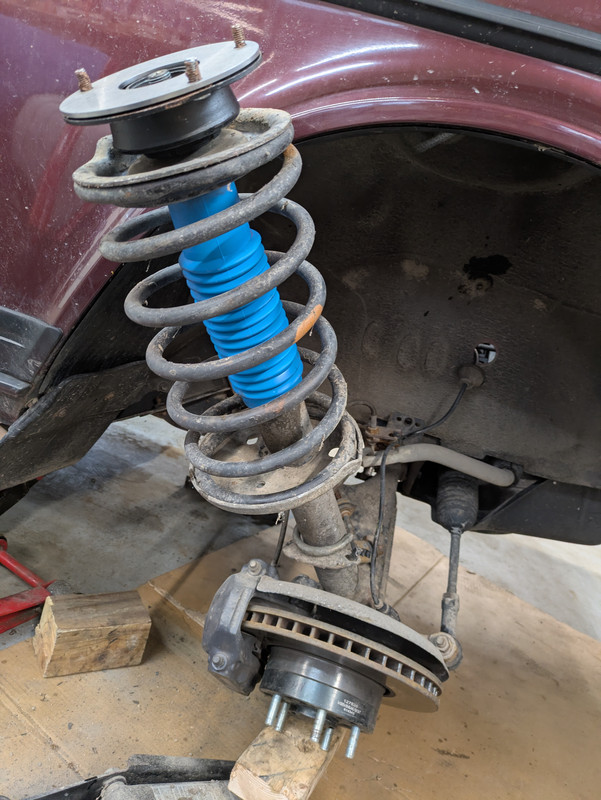

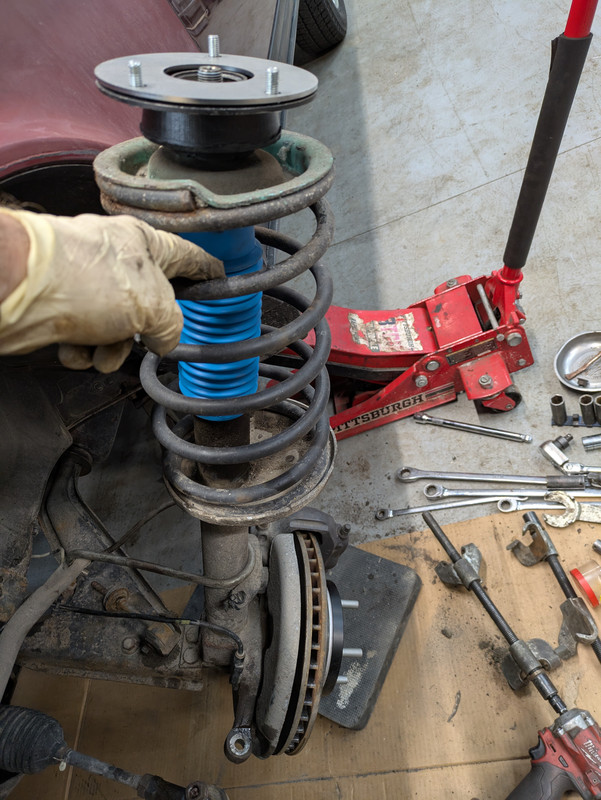

Put the Bilstein B6's in yesterday (FCP) and the strut mount reinforcements from off here (forgot the name)
Wrapped that up today with the B6's for the rear. Should be better for the upcoming turbo setup than the stock hydro dampers I removed.

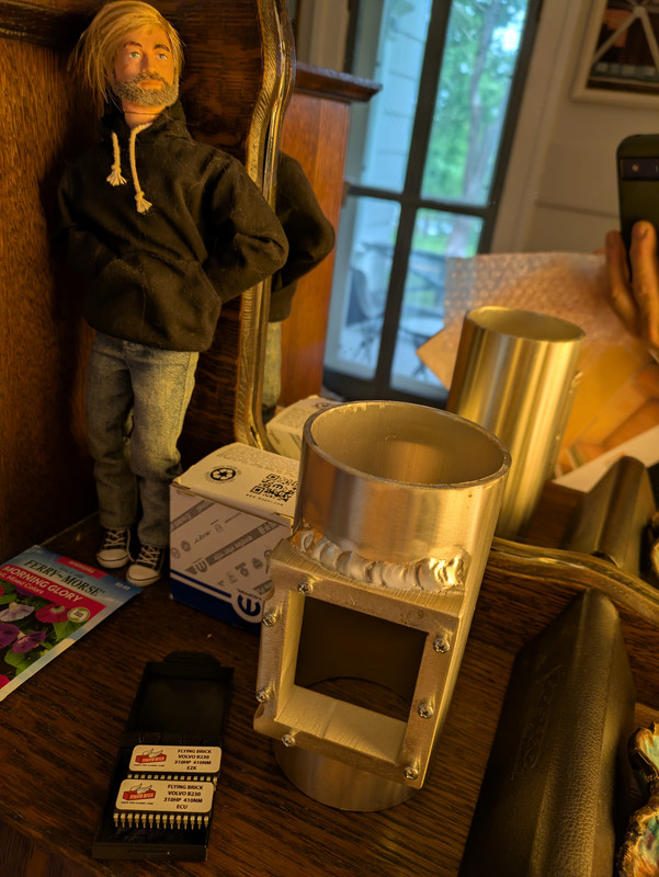

3" MAF housing finally came from Flybricks (took almost 2 months) - with this I can take the guts from a 016 MAF & not worry about finding a hard to come by Volvo version
I also have to chip files from Simon, so I can also try those out when I finally get to the Turbo install
