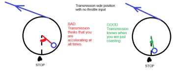

Just in case it helps you visualize what's happening inside the transmission:
The kickdown cable is connected to a spool inside the transmission which looks very much like the one up at the throttle body. It is buried in a slot next to the valve body so if you take the pan off you may need a flashlight to see it.
This spool controls a valve which tells the hydraulic logic inside the transmission how hard you are trying to accelerate. The more input it sees, the more it delays shifting.
I forget if it rotates clockwise or counterclockwise, but basically you are trying to adjust it so that when there is no throttle input, the spool is just barely not resting against its stop (i.e the transmission also is showing no throttle input, but there is no slack in the cable and it will see even small throttle inputs).
