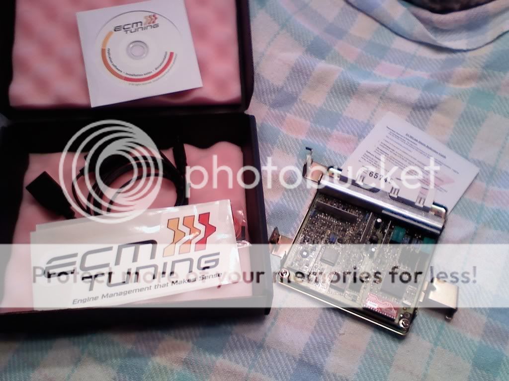

Well thats the code name for my newest project. Ill start putting all my tinker builds here. I had a few more parts show up on Friday and one package that should have....but will be here Monday. Thats whats starting this thread and what I have been keeping under wraps for a while now.

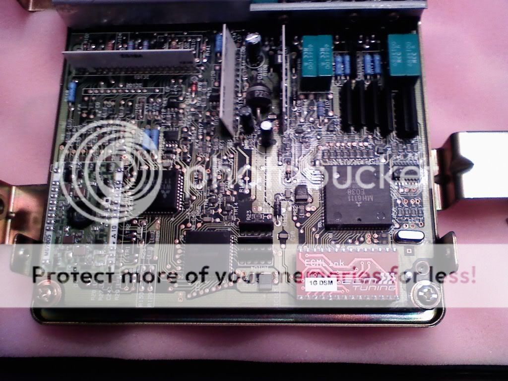

I am intergrating a new engine management onto my 940. Ultimately Im not happy with LH and need something I can program. To keep the long story short, my dyno tuner knows Mitsu.....and I know the Mitsu world can really make big power. So ended up ripping into a 1g harness from a 1st gen Eclipse. Alot of late night tweakin to get the harness all buttoned up and the decision to run the latest V3 ECMlink http://www.ecmtuning.com/ , im very close to getting the current motor running on the V3 before the 16v Turbo swap.
Heres a quick summary....I chose to run the full version. http://www.ecmtuning.com/wiki/prodcompare
Im diggin the anitlag....dual table and e85 option, along with stock maf...gm maf, but Ill be running SD and that gets tuned using the stock maf....rather cool
I only had to mod the cam angle sensor onto the Volvo dist....and rework the Mitsu IAC so i can still run the 960tb.
Ill have more info on my build....but all things are coming together. Ill toss up some random pics of what I have so far.

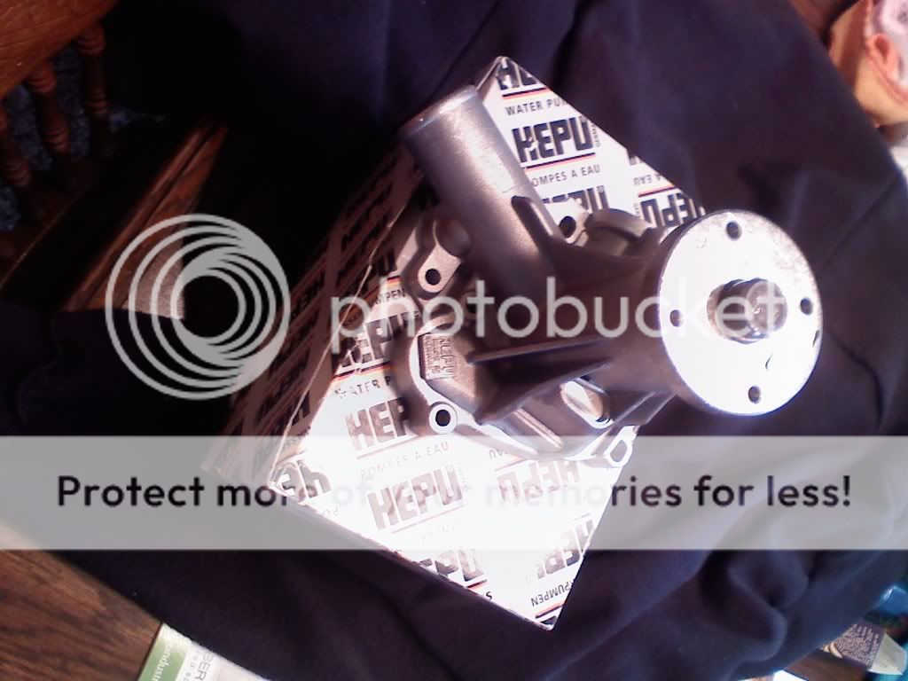

Dales brakes and adapters

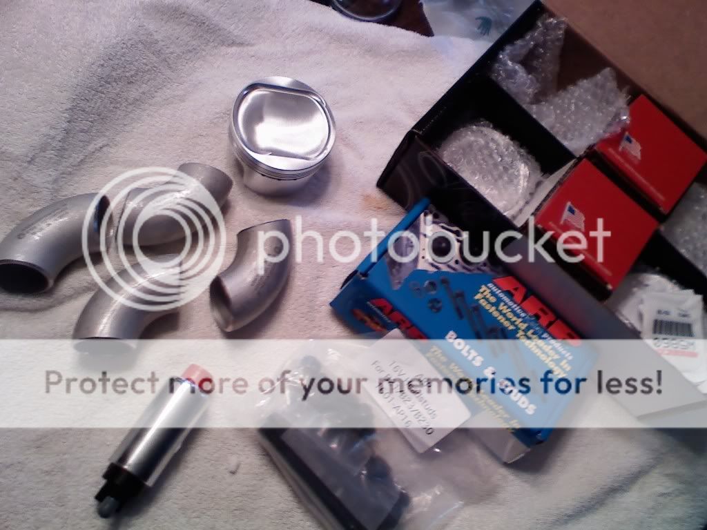

Looking to max out the ported (alot) evo3 16g. English has one running 456whp. Heres the start to my hotside.
Goodies from RSI and Ace stainless

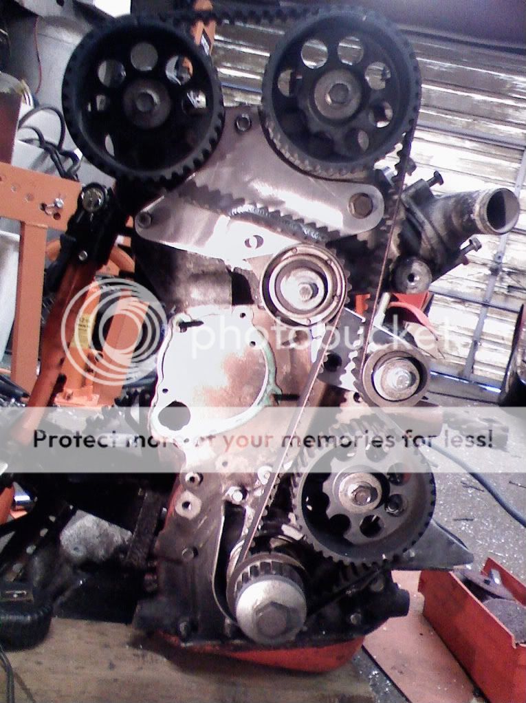

And my on the cheap timing belt setup.

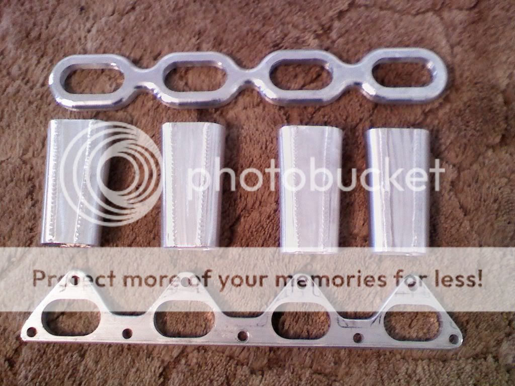

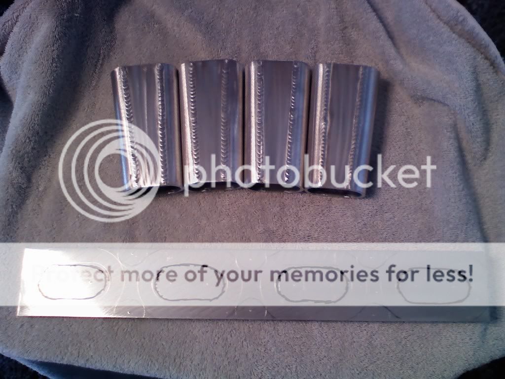

Im working on a straight, tapered runner 16v intake with a target power of 7000rpm, the dyno will tell, but the intake program calls out for that.
Well see......I have some other intake obligations to finish up on, then its no holds bard to get a Motor in for the IPD garage sale.......Thanks Cameron for the challenge!
