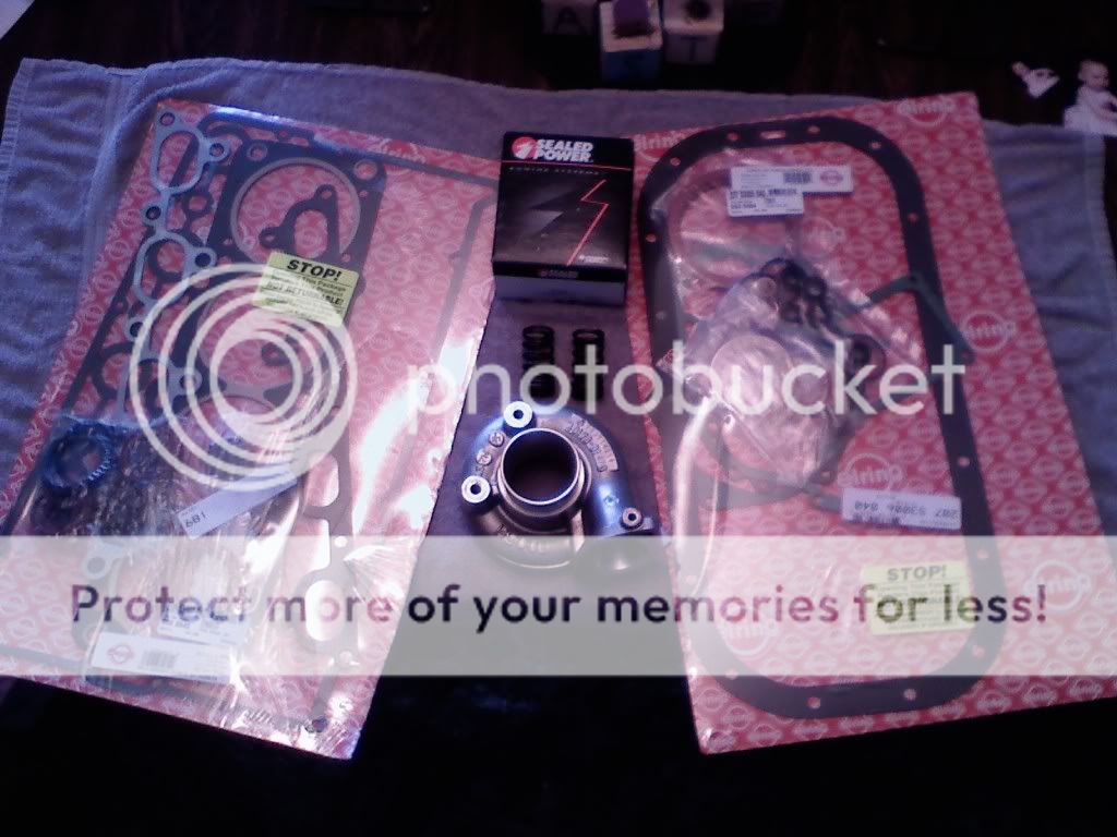

Got my gaskets today...topend 16v and bottom end 8v in Elring.
Also got my VS1632 valve springs from Yoshi Fab....Thanks Josh....your swag is pretty cool too.

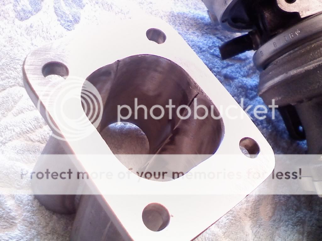

And I got the cold side of the turbo ported today.....things are all coming together.
