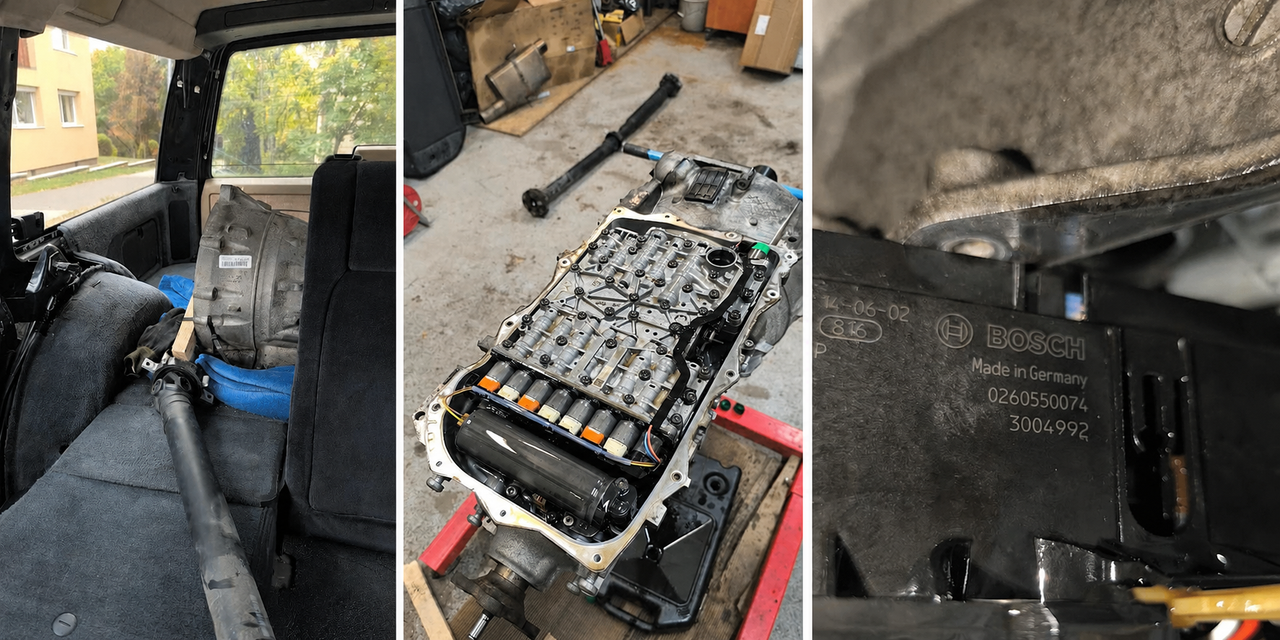

And it seemed to be a simple swap, Maxxecu already had pretty stable support for it (this was around September, 2025). You can buy all the brackets for it from Sweden, no need to custom make anything... I'll let you guess if it was easy or not.
No, it wasn't.
Maxx only supports some specific versions of the box, was contemplating going with CANTCU instead, but I couldn't find the extra 1k+ EUR for it in my wallet :rolleyes: . So started hunting for the correct transmission. Found one out of a F11 530d. Bought it together with the driveshaft.
You either need to open the transmission, remove the valve body and check the bosch number on the brain, or have a flashtool that can read this information. I don't have the tool, and renting it from Maxx dealer costs money, so I made the obvious choice to remove the valve body. Got lucky, TCU was supported. Put it back together with a new ZF pan and ZF fluid.

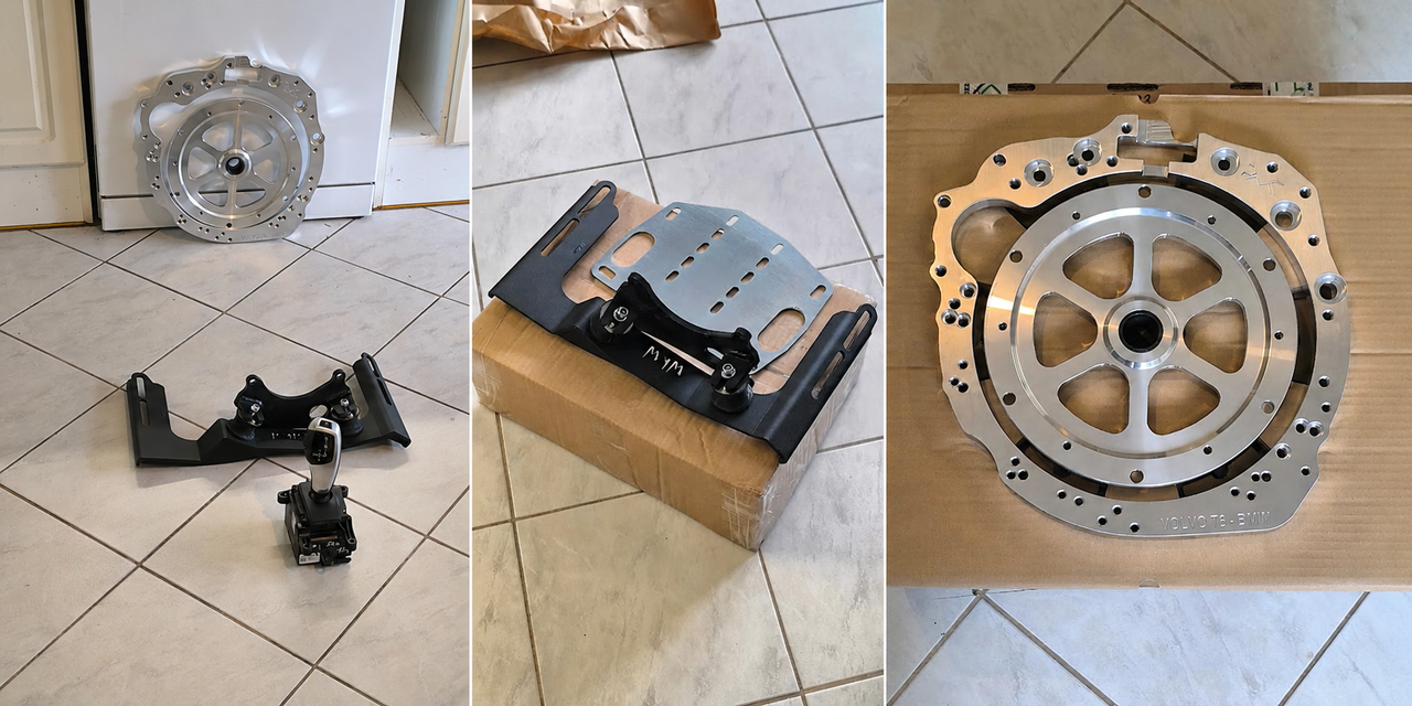

Went shopping. PMC whiteblock to n57 8hp adapter, MKM 8hp transmission mount and driveshaft center bearing plate thingy. And a BMW f1x shifter

PMC adapter needed some persuasion, but eventually it fit. Starter hole was also too small, not pictured

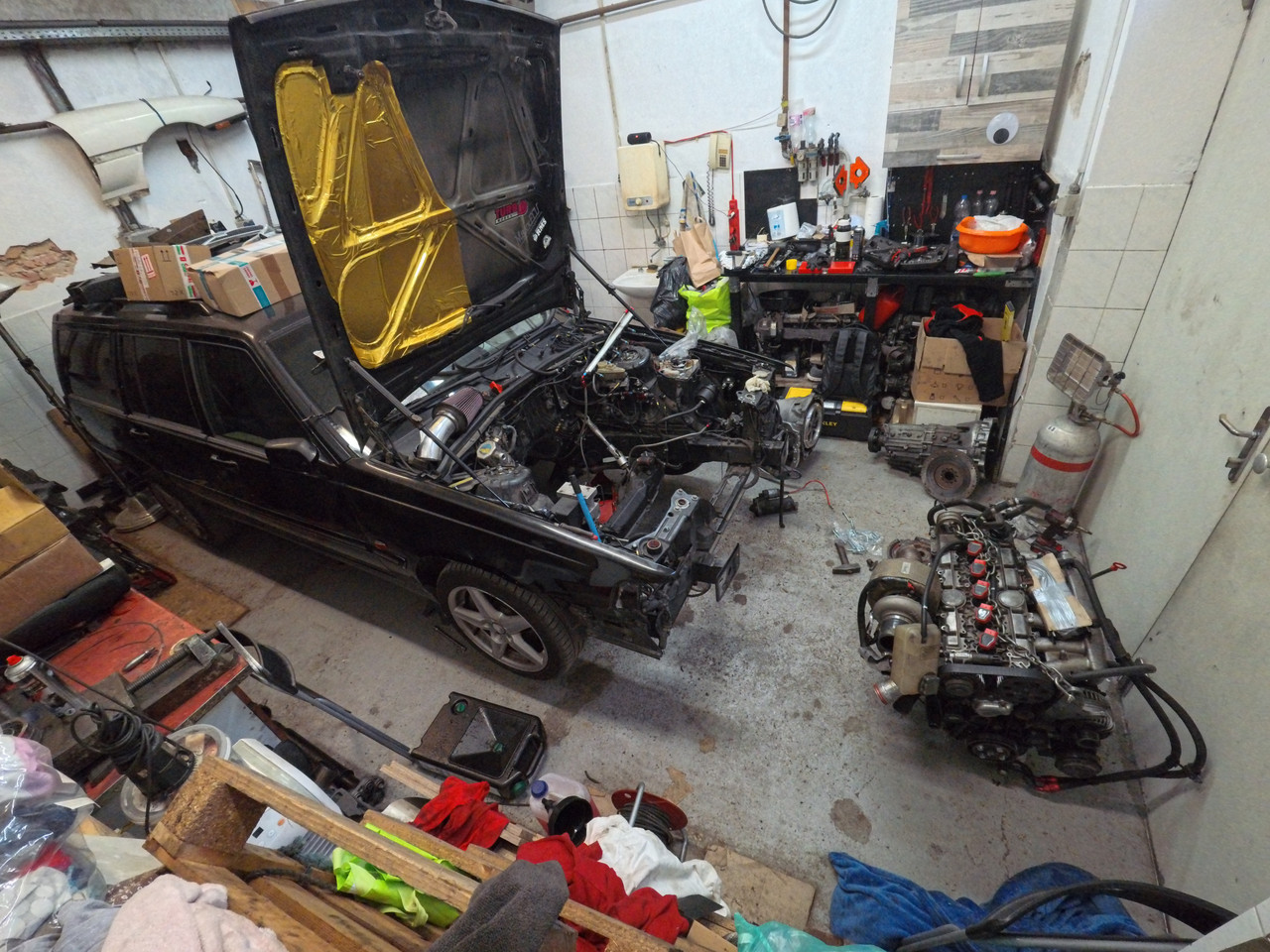

Engine and transmission mated, they can all go back into the car
And this is where the problems started.

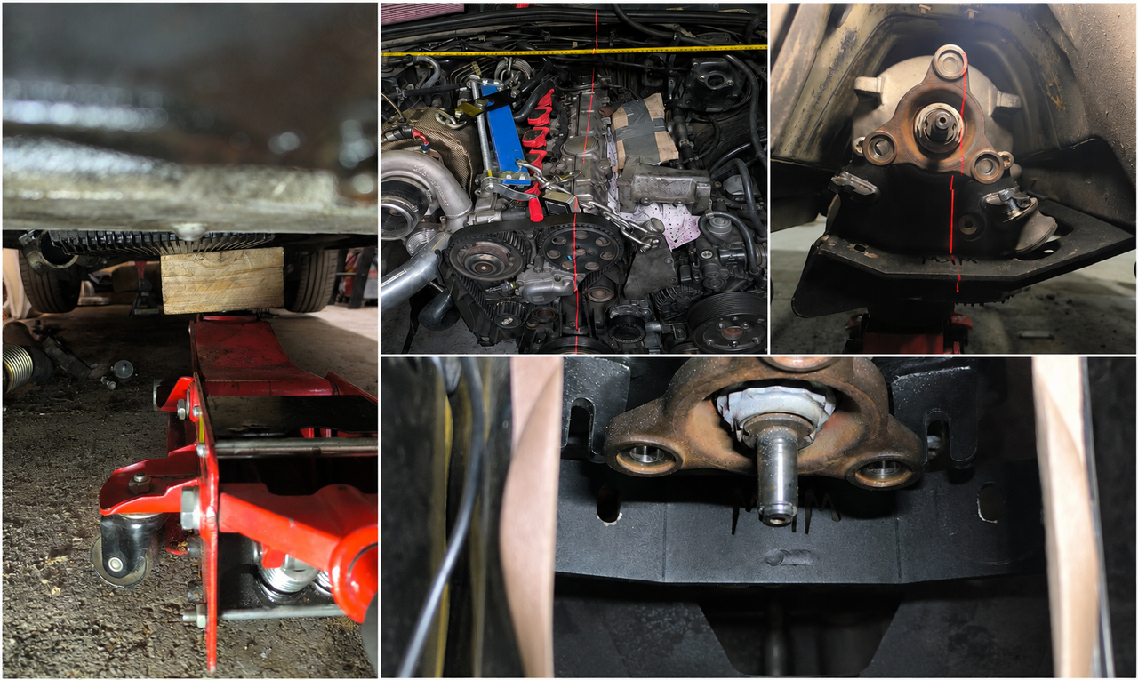

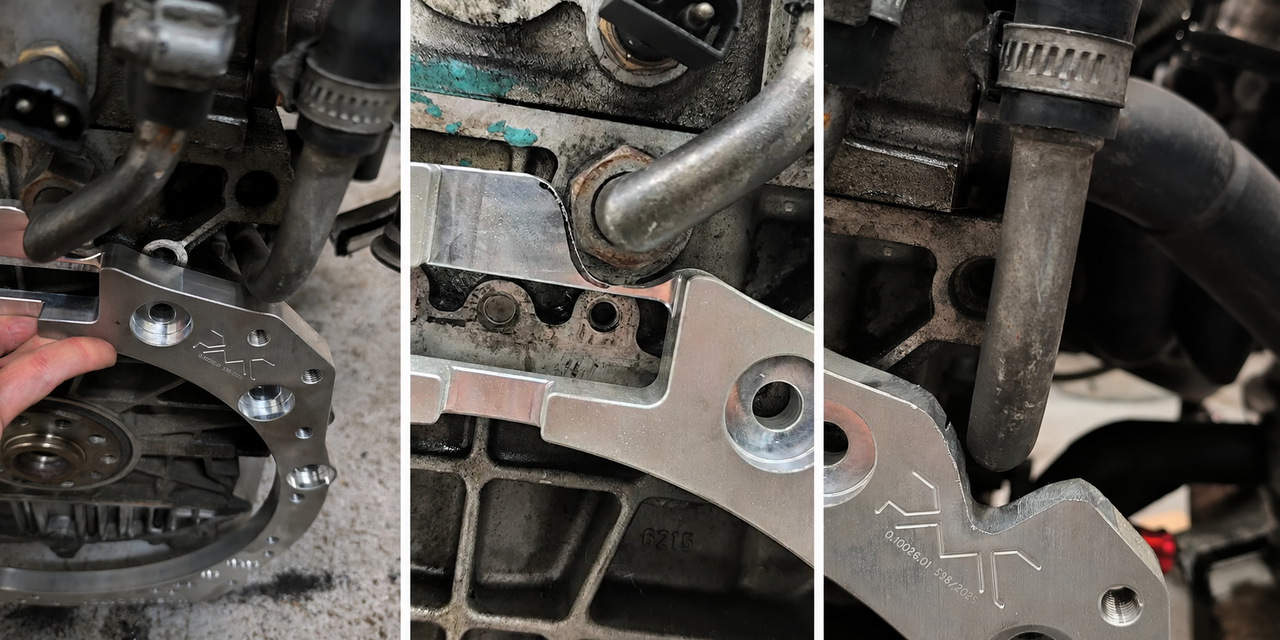

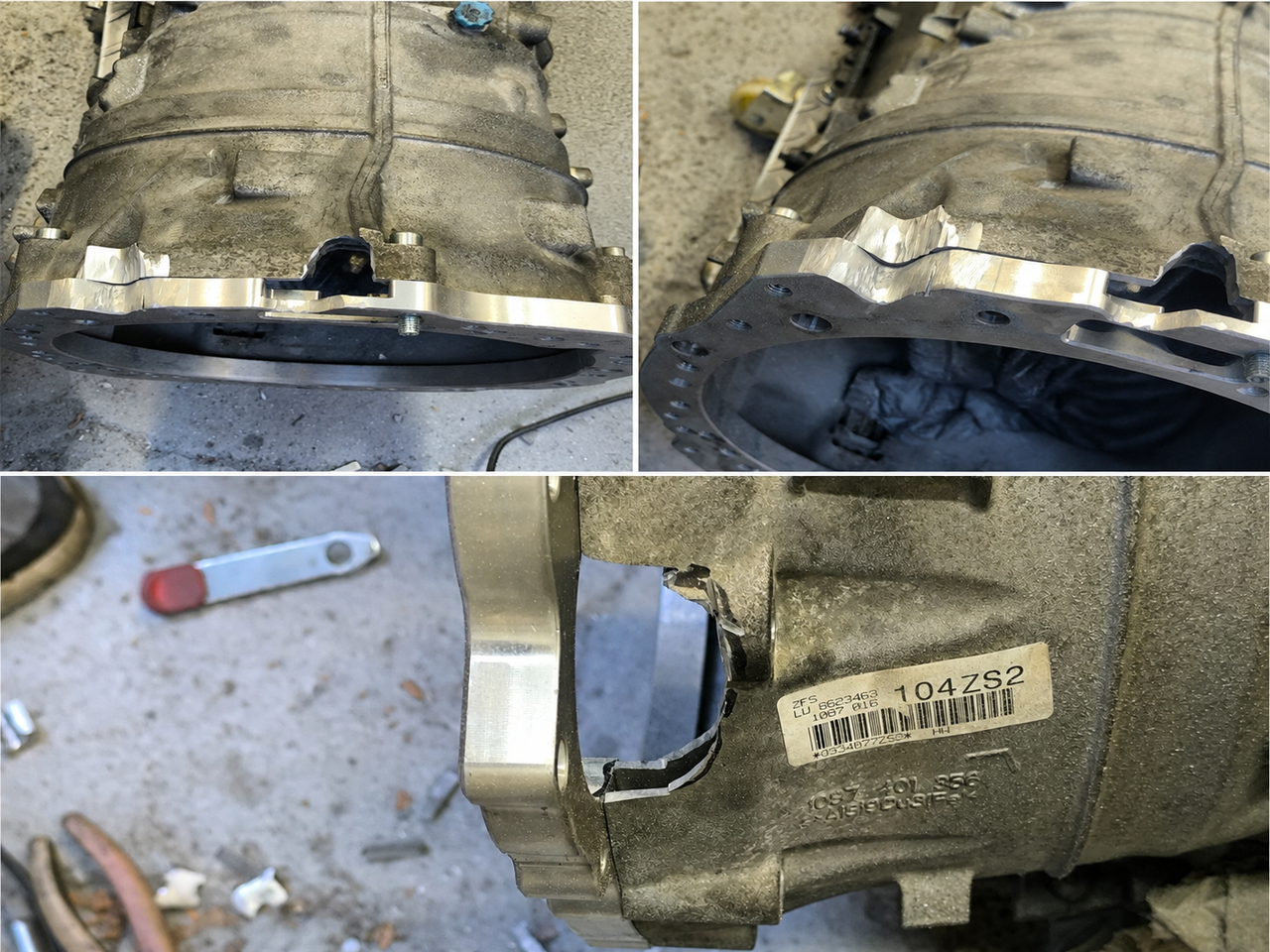

PMC designed the adapter with the FWD oil pan in mind. The problem with that is that the FWD engines lean 8 degrees, RWD 12 degrees. PMC said they indeed used a complete FWD package because people will make custom oil pans anyway. Not happy with that, but also not totally incorrect. Finding RWD sumps is getting difficult, and it would be helpful if this were more apparent on the website. They apologized and told me they will update the description. They haven't done that yet.
So currently there is 4 degrees of rotational difference between the engine oil pan and transmission oil pan. Also, the MKM transmission mounts are not lining up, but also partly because of the next problem
Problem #2

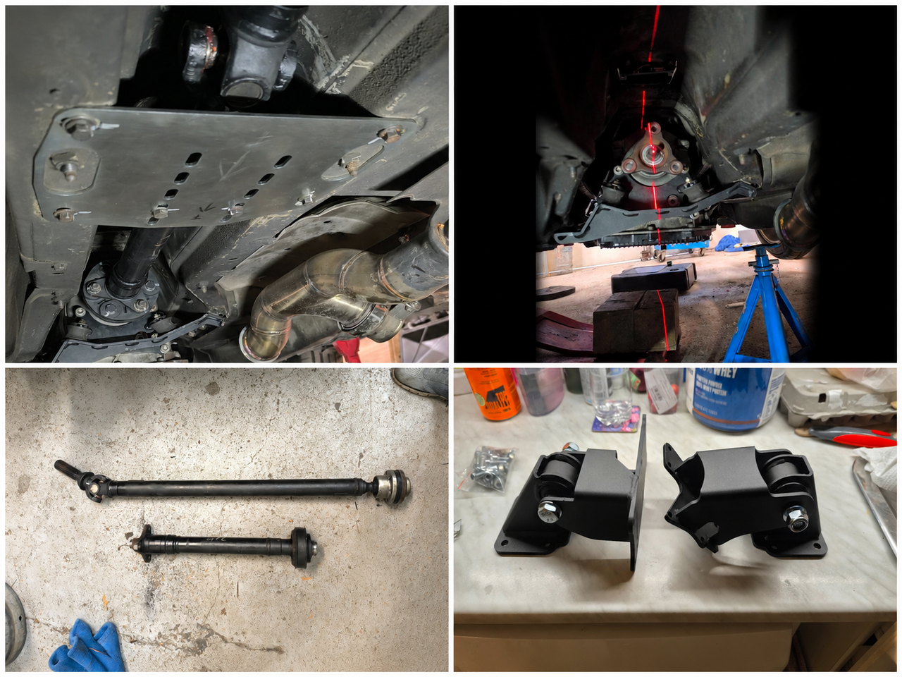

A few posts back, I was soooooo proud of the engine mounts I designed. Well, those are f*cked and holding the engine a bit sideways
I have no solution for the PMC adapter; it is what it is for now. I drilled new holes in the MKM trans mount.
Engine mounts were tricky. Tried to modify the ones I had, but that didn't work. Went back to MKM to bought their engine mounts as well. I really don't like how stiff they are, but I didn't want to make new ones from sketch. Not happy with how much vibration they transmit, so in the future I'll rework my design.
In the meantime, I got the BMW and Volvo driveshafts welded

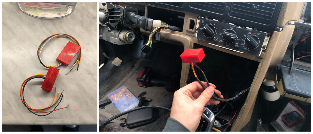

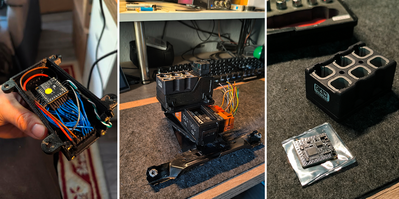

So now, everything is lining up great, driveshaft is straight. Wiring was easy as Maxx and trans communicate via CAN.

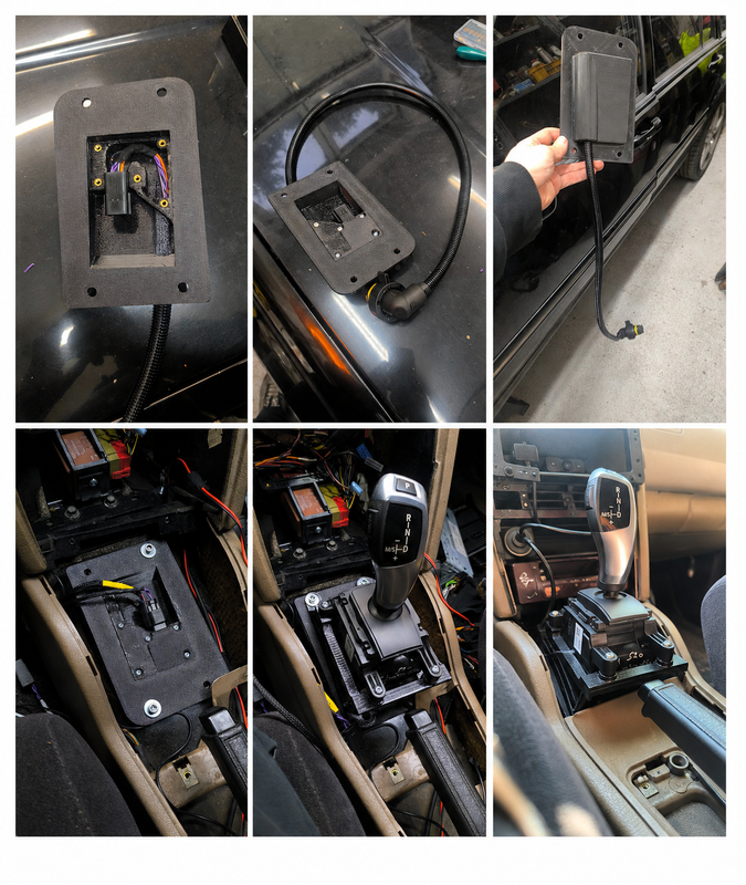

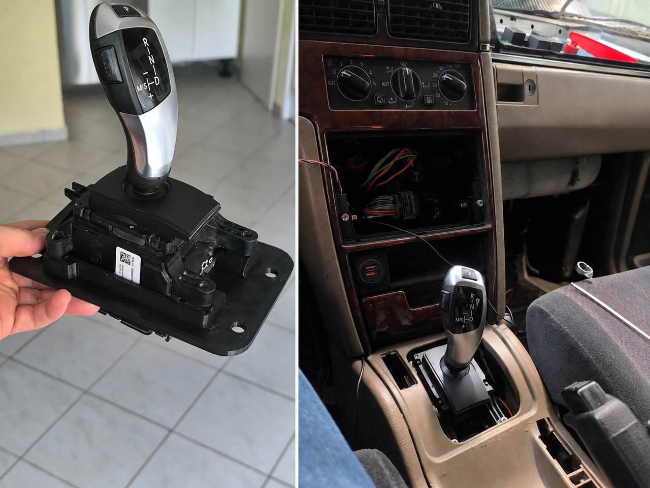

The first version of the shifter adapter was a bit stupid. I didn't consider that the gaps around the shifter would let all the noise and smells into the cabin, plus it sat uncomfortably low within the center console. It might look good in the picture, but it was really awkward to reach the shifter
While I was there, I eliminated a bunch of relays from the center console that are no longer in use. Printed a new holder for what's left. While I was still there, I realized that I ran out of I/O on the maxx and still need to wire in cruise control, paddle shifters, and want to add a few more sensors and switches. So I went and bought a Canchecked CFE18 CAN i/o extender and a Canchacked 6-port CAN hub. Designed a housing for them to be one unit. This will have a place on the new relay holder, but a few other things need to be done first. Currently the unit sits in the glovebox.

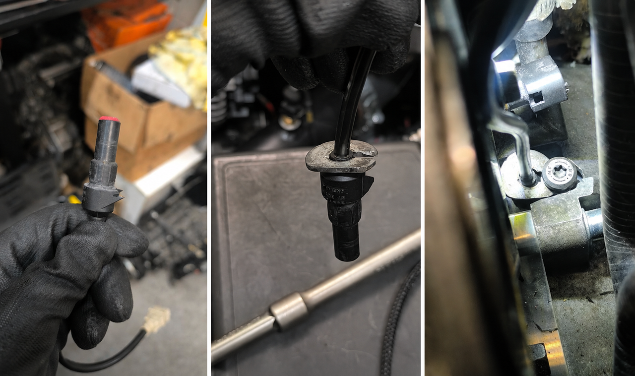

Except I failed to realize that the auto flexplate requires a different crank sensor with a different bracket. Had no RPM signal.
The problem with that is the transmission is now blocking the crank sensor bracket, so can't remove it while everything is in situ. And there is no way I'm gonna pull the engine and separate it from the trans just for this. Even though I have the other style bracket and crank sensor.
Hackity hack! :ROFLMAO:
Measured how deep the sensor should go, and hacked away enough material to reach the flywheel. Than needed to come up with a hold-down solution. An assortment of nuts and washers did the trick and got the engine started, finally.
Obviously, this was temporary; I did have some hiccups and random cutoffs, but in general, it worked.

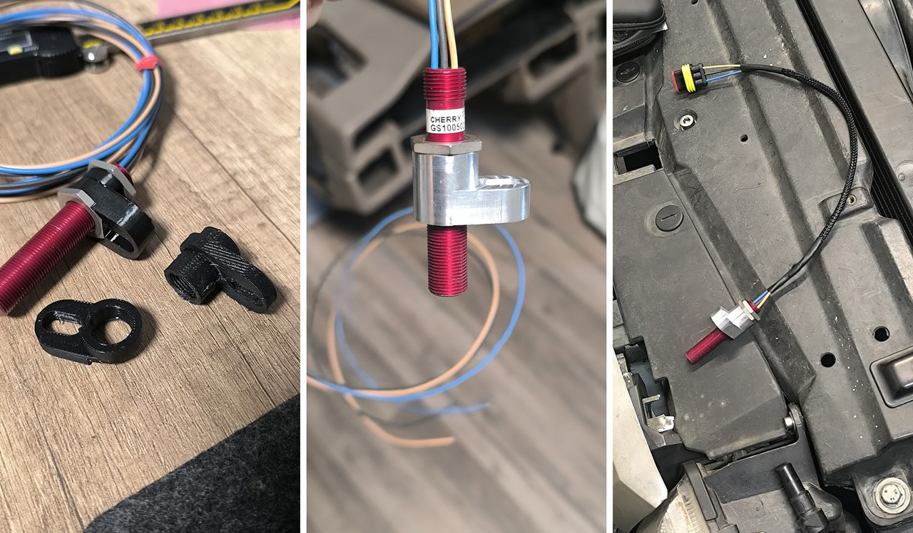

The solution was to buy a cherry red HALL sensor. Printed a few mounting solutions to see which would work the best, and got the correct one CNC-d

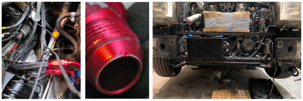

I did install an external trans cooler. AN10 lines, Temu Racing thermostat ( :rolleyes: ) and a 19-row cooler. Not so sure about the tstat, but so far it works. Bought an OEM audi/mahle unit, will replace once it fails.
I did have a huge trans fluid leak, but it was my mistake, dropped the AN fitting, it got damaged, ignored. Was leaking like hell.

  • BMW shifter. Can't explain, hate the thing. It sat too low, don't like how it looks. Hope maxx team will eventually provide support for the JLR rotary knob shifter, or I'll make a push button shifter sooner than later
  • the bracket for the shifter was letting in noise and smells to the cabin. I made a new adapter, keeping in mind that in the future I won't need the shifter. So it's now a passthrough for the wiring and a separate cage that holds the shifter higher. The center console plastic needed "some" trimming, but it was broken anyway

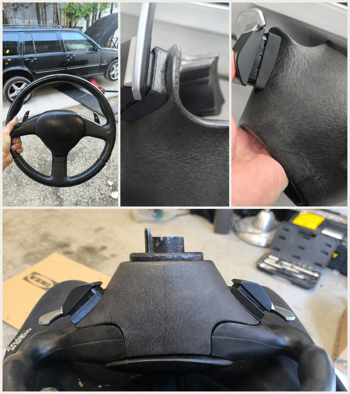

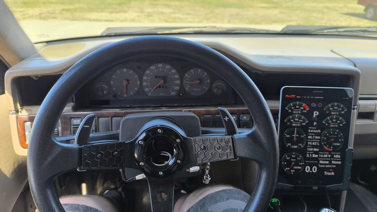

I really wanted flappies on the steering wheel.

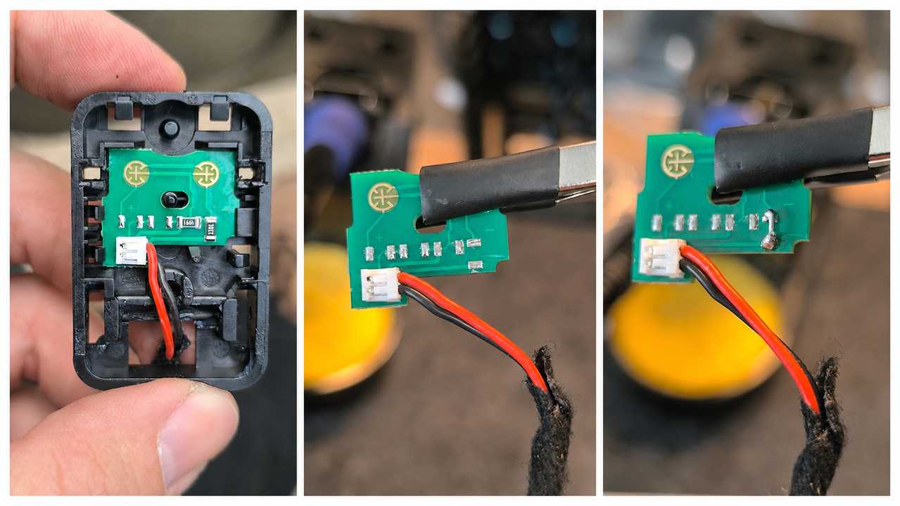

Bought a set of BMW paddle shifters, like $30 on aliexpress. Designed a holder/bracket for the steering wheel to mount them.
Needed to hack them a bit, these are not simple pull to ground switches, I assume voltage dividing is going on. Didn't want to deal with that, removed and bridged resistors and voila' they are pull to ground now.

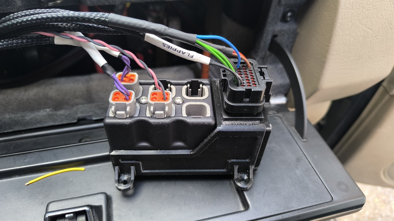

Since my car has no clockspring, getting the signal from the paddles to the ECU was tricky. Thankfully SPLeinonen created the wireless wheel gadget the solves this issue. You can transmit 4 buttons worth of data over air. One red box is sending the other is receiving. Awesome thing.
Sooooo much better now, daily driving is a joy. Yes, the manual was fun too. This is also fun in a different way. Would I go back to manual? Don't think so.

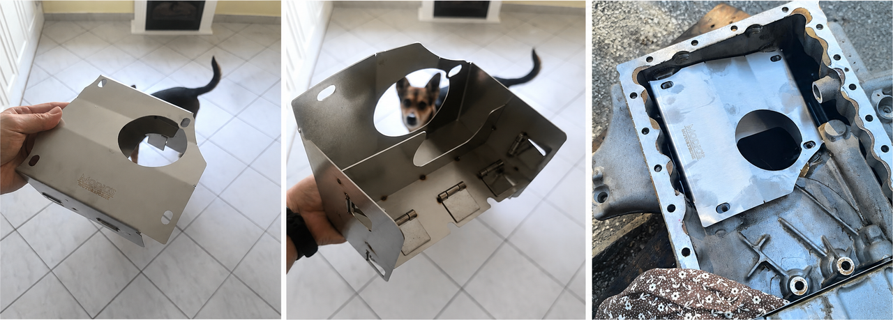

1. Oil pressure issues.
From the previous trackday posts you might remember that I was loosing oil pressure when cornering hard and the oil got around 100 celsius (which is nothing, shouldn't be a problem when running 10w50 race oil).
I dropped the oil pan for the 100th time to install Modigs Motorteknik's baffle plate

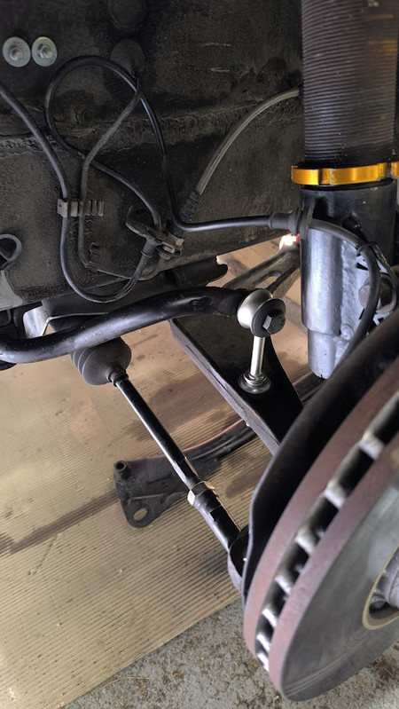

2. No swaybars
Due to the custom coilovers, I have no mounting brackets to install endlinks. The plan was to weld some tabs to the coilover sleeves. Then I looked at what the 7/940s had and copied the idea. Swaybar endlink from a 940 upside down and a hole drilled in the control arm. The suspension engineers amongst you are probably saying this is not that great as the motion ratio is not the same and the swaybar will act weaker, or something like that. Yes. But still better than nothing. Still nothing in the back :/ Maybe thats a good thing, helping put power down with the open diff

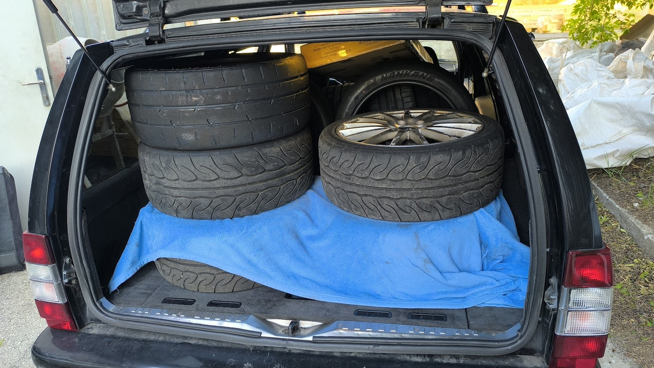

3. Tires
Used to run a really old set of Yokohama AD08R tires (not RS!). Great tires, but mine were way past their best. And 225/40 18 is a tad too small for the car. Managed to get my hands on a set of used Nankang CR-S tires in 235/40 18. I put the silver wheels back on the Alfa because they are only 8" wide, Nankang recommends 8.5" wheels for this size.... Guess what size wheels were on the Alfa :D Got some adapters made from 5x108 to 5x112. Was hesitant to add unsprung weight, but these adaptors are some special AL-MG-SI blend and really strong while being light. Changed the alignment, running now close to 3 degrees of camber and 0.2 toe out.... more on this later.
I think it looks great.
Got to love wagons, 3 sets of 18s fitting nicely in the back :)
4. Paddles for the track steering wheel.
Was a quick print the night before the trackday, nothing spectacular

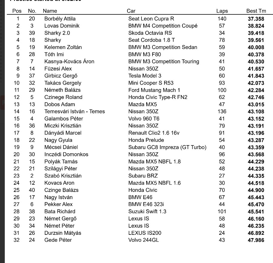

As usual the day was awesome. Previously my best was 43.8xx on this track, now its 43.152. Great success.

Front swaybar made a huge difference.
Oil pressure... this is still a problem. Same as before. Nothing changed even with the baffle plate. The only thing I noticed was that the problems start when the oil reaches 94 Celsius. Coincidentally, this is where the oil thermostat opens. Huh. I have a theory that the oil level drops when the tstat opens. Also, I might have the wrong dipstick. For starters, I'll remove the tstat and see what happens.

I have to say i'm generally not a fan of automatic gearboxes, but this T6+8Hp made me impressed during full throttle accelerations. :cool:
Sounds really mean and the shifts are crisp! Loved it!
Btw I was the other Peter on the list with the worst time :lol:
I had even more troubles with oil pressure, even with 10y/o winter tires. I just tried to have fun.
