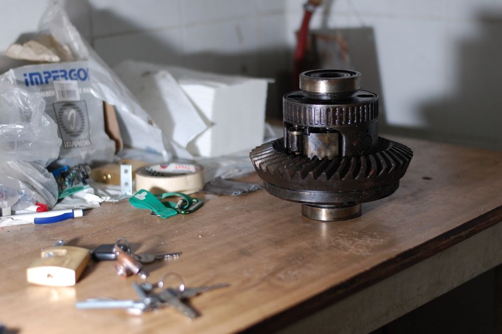

Last November I bought a 1041 axle because of its G80. Plan was to swap it in and be happy with it until I figure out the MK1 IRS swap.
See? G80, wohoo...

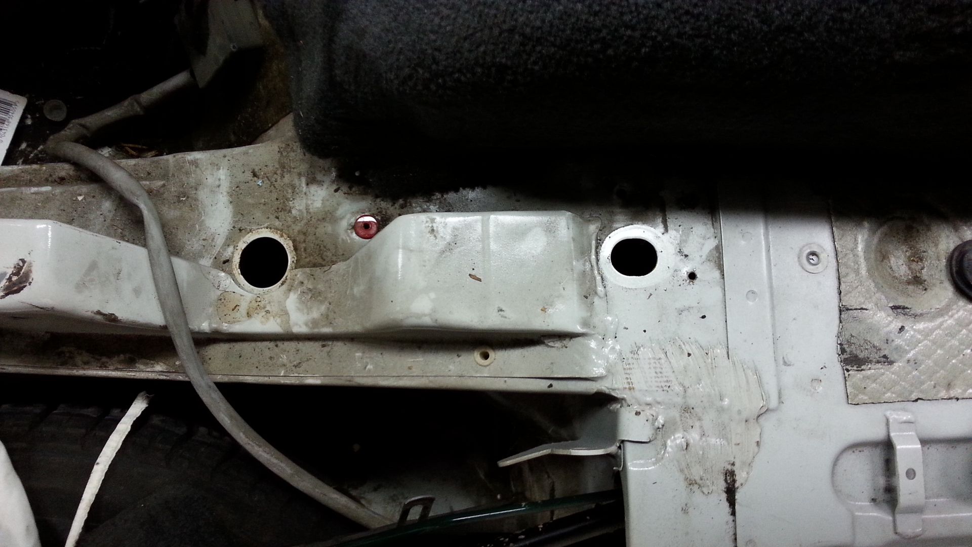

Again for the rear brackets there is only 1 hole (out of 3) on the rail. Worry not, drill and some bolts and be done. Or not. The middle bolt goes trough the subframe mouting point. So I drilled a hole for it. Went to the trunk to find "the other end". There are service holes on the rails, but not for the middle bolt. And since it is a wagon, the floor is different. There is no access for the middle bolt. Grrreat.

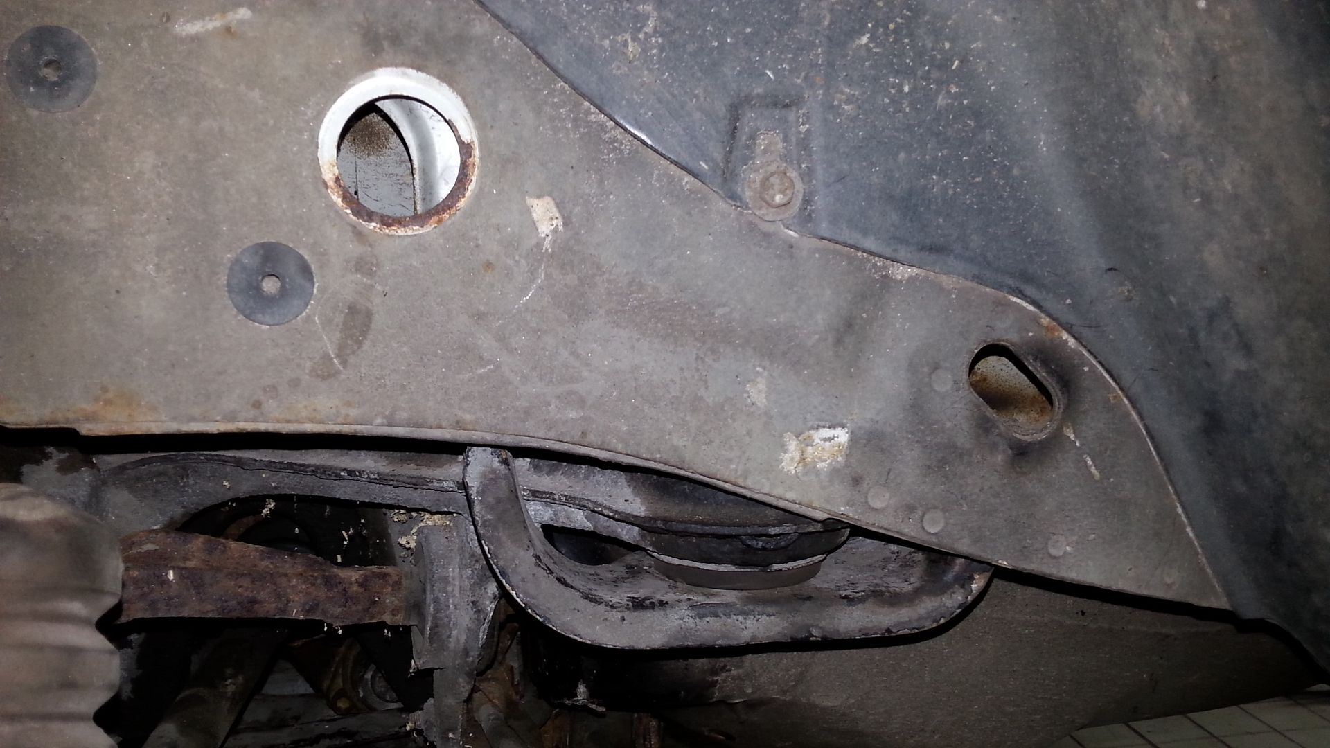

This is the "setup":
see the two service holes? Those are great!

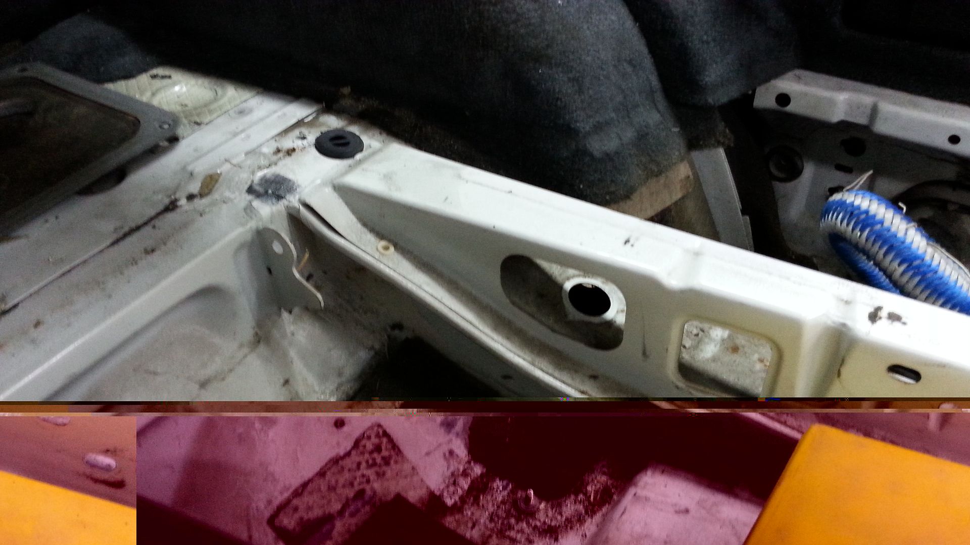

Same from the trunk area, driver side:
Pass. side: (dying phone... sorry)
So, I have no access for the middle bolt, I can't weld a nut on the rail, cant put a nut onto the bolt or anything like that. I have to cut open the rail/floor to gain access.

Oh yeah, the best part!! 1041 G80 doesn't work in the 1055(?) MK1 IRS. The halfshafts were wobbling around in the diff. This discovery was a bit demotivational...
Found a G80 that fits, Greg modded it

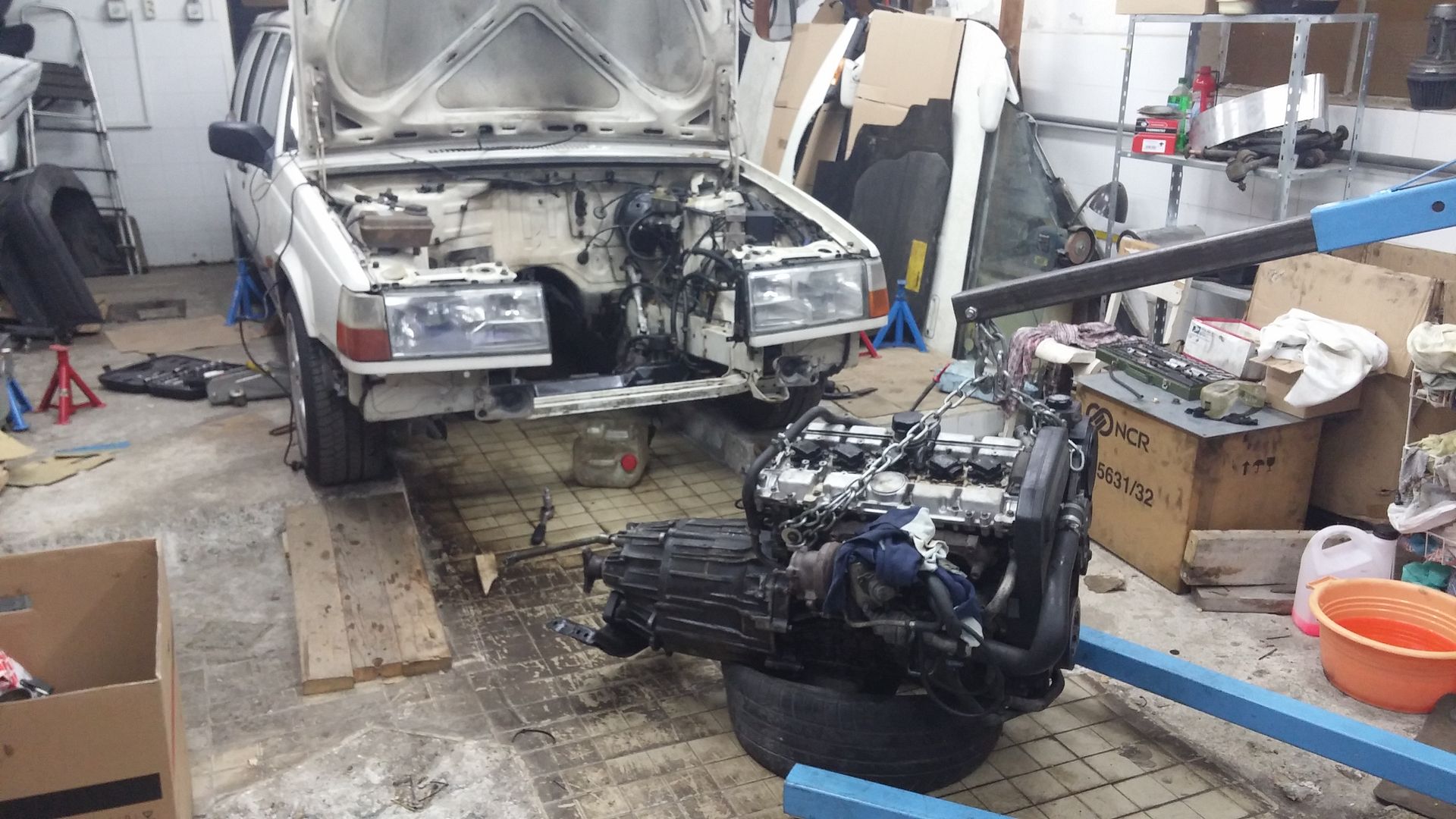

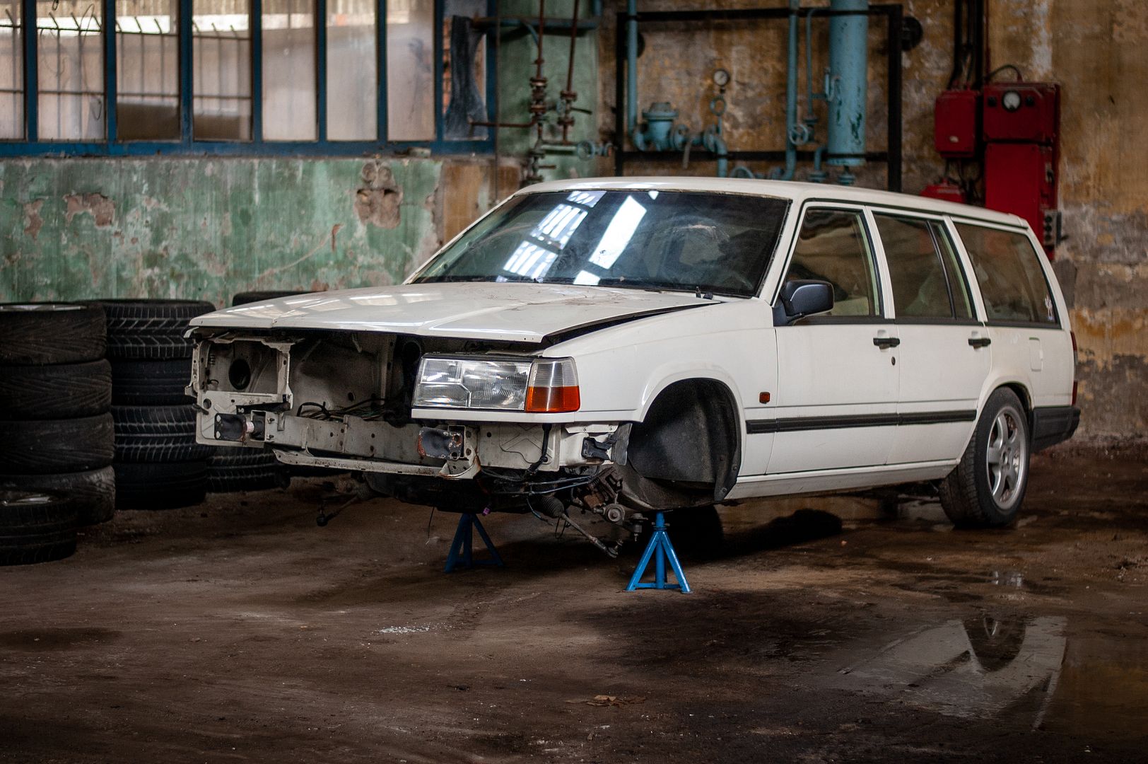

So, that didn't happen. Spoiler alert, 945 went to Volvo heaven, but things had happened before that.
Things were looking good for a while, bought some stuff:

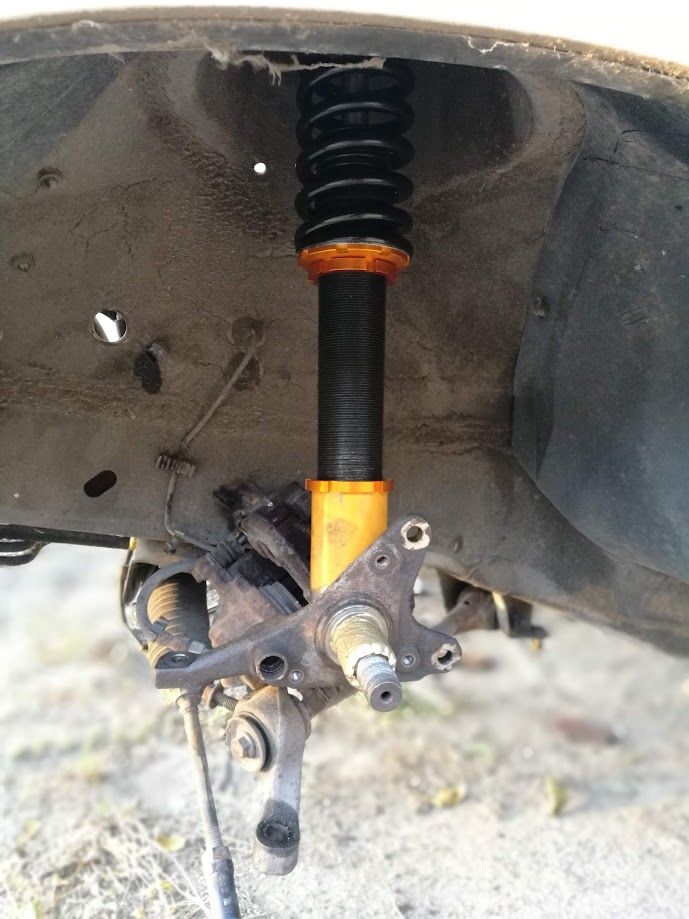

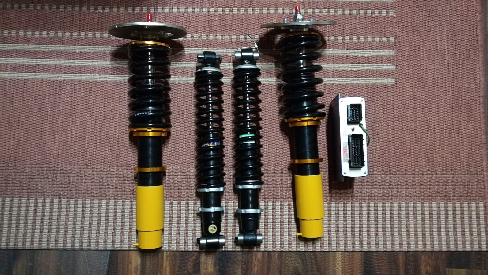

GAZ coilovers from classicswede. Remember this car received a MK1 IRS rearend, and at time I believe there was no rear coilover option.. so I bought the one made for the live axle.
VEMS was also acquired
Desinged mounts for the rear coilovers, similar to what Kaplhenke sells
Installed everything
Sitting pretty, without an engine

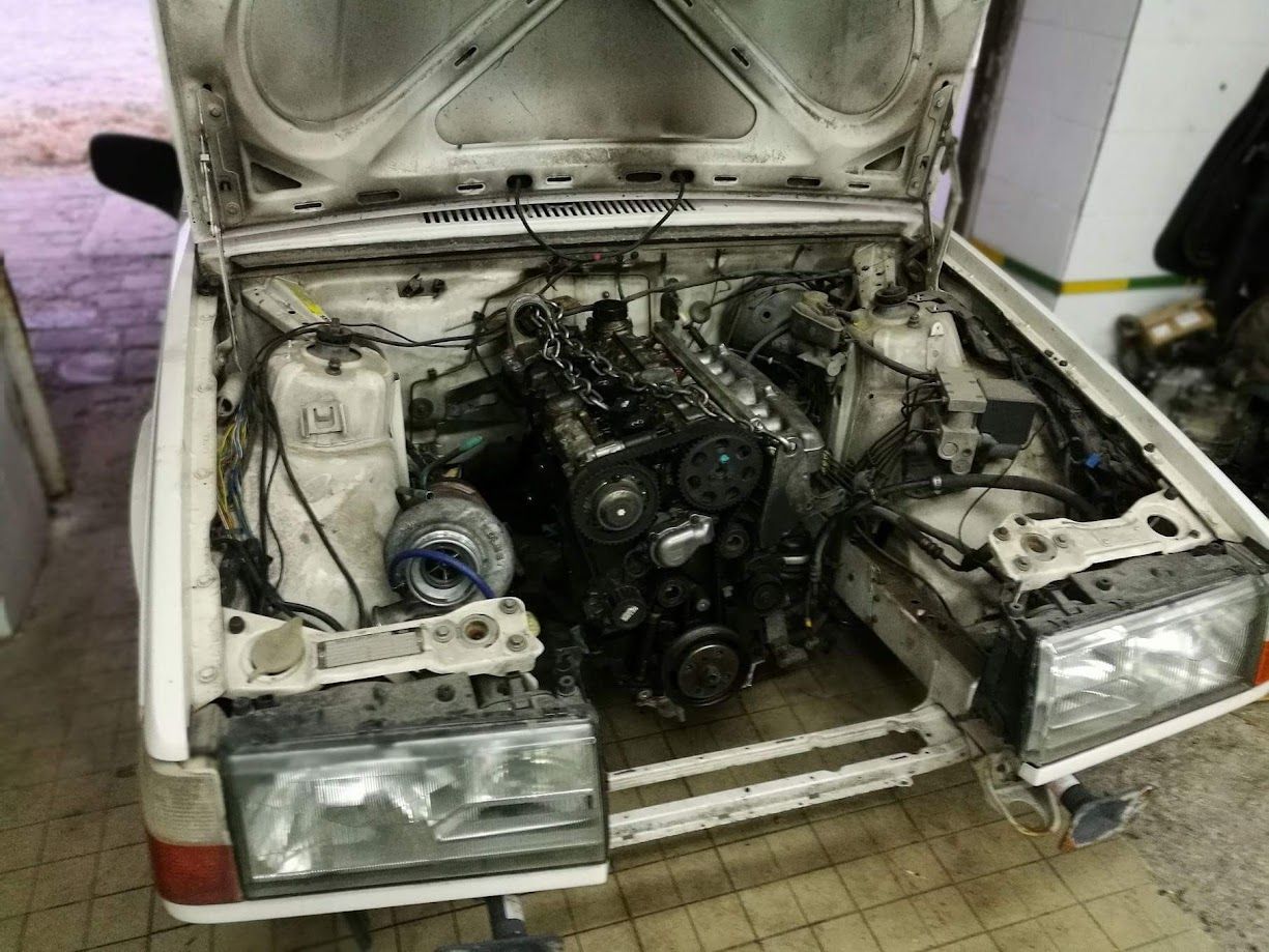

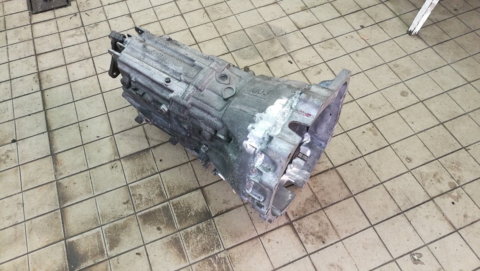

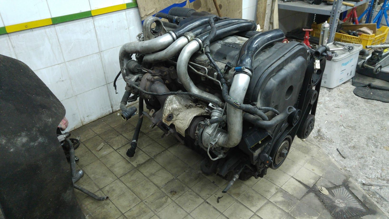

Ditched the idea of a off-brand engine, so bought an early T6, BMW GS6 transmission and custom clutch setup

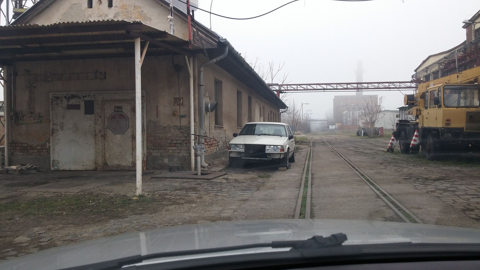

Turbo is a HX40W off of a Volvo truck. Waaaaaaaay too big. Kind of stopped at this point, was sitting like this for a while.
Than it sat like this for a while

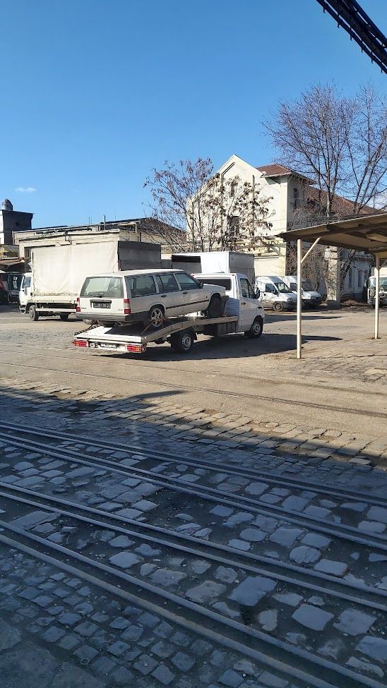

For some reason I thought buying another 960 is a good idea... I'm sure I had my reasons... but still don't know why I didn't just finish the 945.
Anyway, 965 here it comes.
Still had plans to turn the 945 to a dedicated track car while keeping the 965 mostly stock as a DD. I had to realize that wouldn't work, so, 945 went bye-bye :( Obviously saved the coilovers and the MK1 irs.
