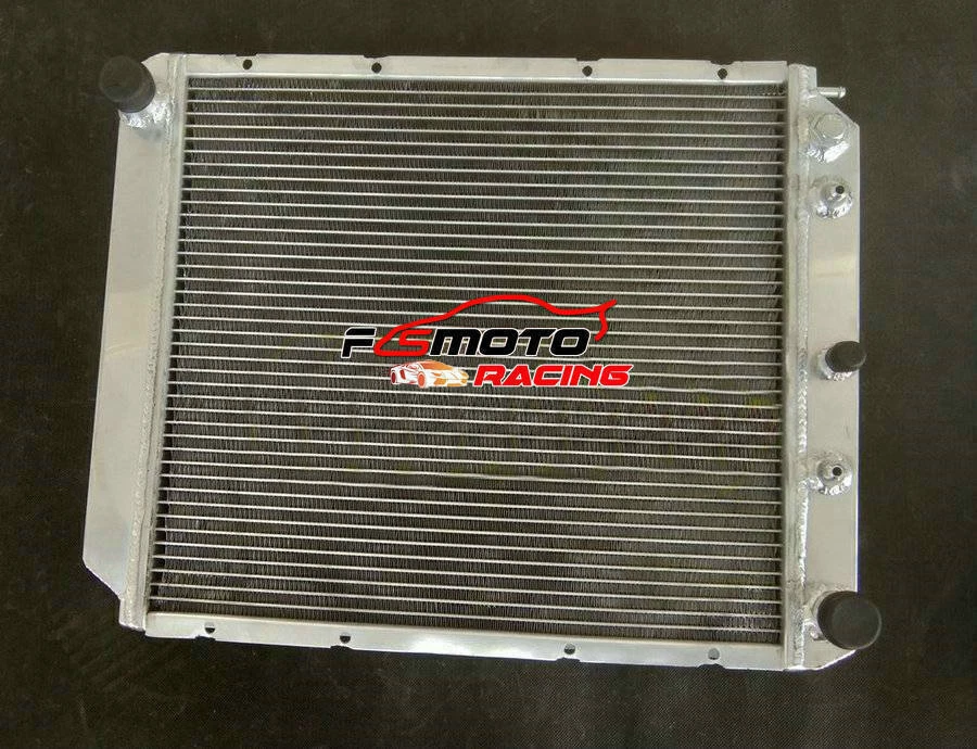

I need to replace my radiator on my 91 745Ti as the all metal one I bought on here is already failing. The end cap solder started leaking and I had to get it fixed, and when the shop was cleaning it they were able to easily blow out some of the vanes.
Ideally I would like to go for an all aluminum 3 row radiator,
I found this one on Ebay and it looks to be what I'm looking for. It is about 3/8 narrower in the core than my current all metal one.
The core dimensions for it are 17 3/4"×16"× 1 5/8", it's advertised as 3 row, it looks like it has all of the correct connections for an auto transmission and for the temp sensor, and it's only $190.
Just curious if anybody has any experience with this company, or if they see a warning in the listing I didn't catch, or if they have a better alternative.
https://ebay.io/m/Lv2NBC
Looks like the ones sold on Ali Express/Temu etc...
No personal experience as I got the "Tropic" rad from speeding parts. Very happy with that.
It looks like one i bought from ebay, but i’ll have to dig a bit to find it.
The only bad thing was it was banged up by the time i got it, so they refunded $60.
I went with a couple of those ebay/amazon ones on the Dodge, had to return both due to either completely fubar'd cores or failed welds. Ended up with a Griffin. Keep in mind, some of the 2-core's actually flow more than a 3 as they have larger cores. That Griffin is 2 1" wide cores, vs the 3 1/2" wide cores, with the same fin density.

I would be worried about internal welds leaking into the trans cooler on those china radiators
