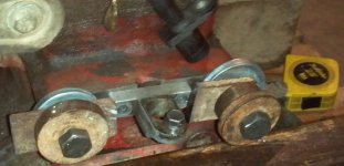

When I converted my '85 GLT to LH2.4, I used a hacksaw and a coarse metal file to cut a notch for the CPS in the original '85 AW71. Pictures here.
That's a great write up, just the info I needed. Looks like you could have used a hole saw then cut with hacksaw to hole ?
It's soft enough metal that you could use a hole saw if you have one that's the right size. I rounded the corners slightly and tried to smooth the whole shape so that there weren't any obvious places where stress cracks could start.
