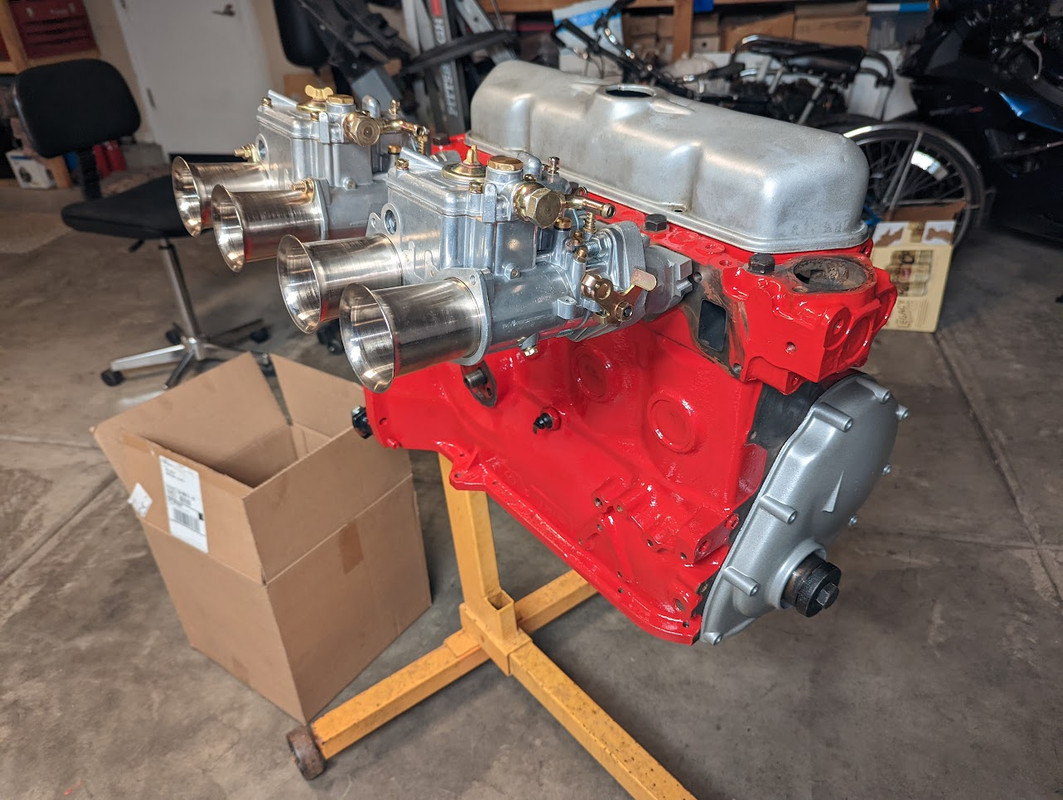

I've pretty much finished rebuilding a B20 for some more power in my Amazon, just needs covers and pan put back on but now I'm questioning cam choice. I've got a used D cam in it now, but can get a new (reproduction) R cam pretty cheap locally. Info seems to be a little sparse so I've got a few questions. The majority of my background info comes from this 1800philes article, so any differences in thinking from this collection of information would be nice to know as well.
My specific questions:
  • Would an R cam be too much for the motor to the point of uselessness or hinderece?
  • Will running a R cam require aftermarket valve springs or changes to the valve guides/stem seals? (as hinted to in the linked article)
  • Has anyone ran one and gotten an estimate of where the power band is? (For example is it useless to run with stock lifters/pushrods only to 6k RPM)
To give some useful information the motor is:
  • 75 B20f
  • Decked block for flush piston/deck clearance
  • Elring 419763 Head gasket to match F combustion chamber shape and have .8mm ~.032" squish
  • Head shaved to either 50 or 52cc, I have forgotten but the result should be 10:1 compression,
  • Hardened valve seats and valve job, obviously Kjet ports welded closed
  • Some portwork done to address F head restrictions
  • Will be running Chinese Weber knockoffs, assuming they function
It's going to be a fun motor in a fun car, I've got enough volvos to last me the rest of my life and I'm young enough to deal with it not being the most "daily drivable" low end torque. I just don't want to waste the time and money if it won't help, or miss out on gains for cheap while it's still yet to be sealed up
