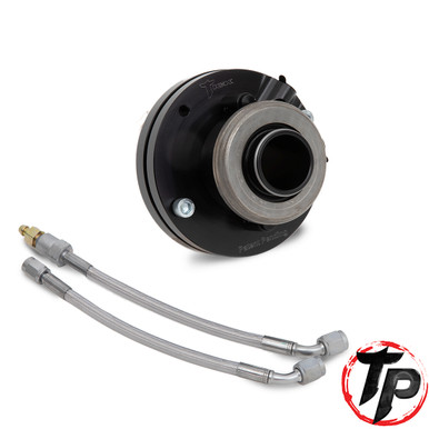

This winter I am going to upgrade the slave cylinder/TOB. The current HOWE bearing does not use a spring and has inconsistent pedal travel/engagement. Tick finally released one for a LS/TKX
I'll probably switch to a twin disc as well. https://www.tickperformance.com/mcl...IKQ1MCLU0LGvQnJgTEmN2m06IHw_uDYULOGS0RUkWJWb4
I might look over your shoulder and copy your homework on the clutch slave. Mine is vastly, hugely improved with the smaller master cylinder, but the engagement point is inconsistent. Sometimes down low, sometimes in the middle. It's using a stock Camaro T56 slave currently.
Tick should be able to get you setup. The parts are pricey, but I know their stuff works as it should.
