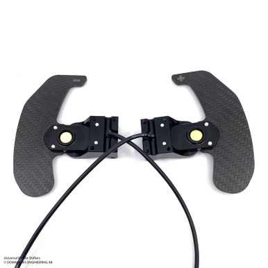

For shifters, Ill plan on using paddles from DomiWorks and keeping my clutch pedal to add a clutch position sensor for various functions.
This system should integrate well with my Haltech Nexus.
