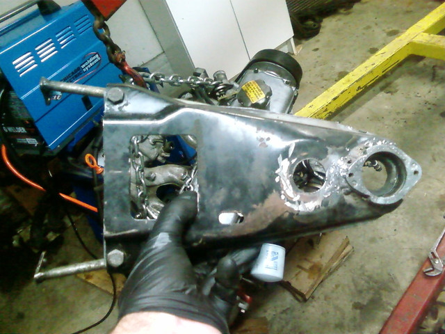

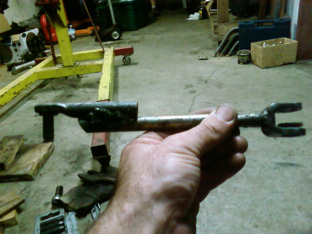

If your using a bmw getrag 265 transmission you also have to use the getrag throw out bearing when you use the redblock bellhousing you cut the middle part out with a hole saw so the getrag input shaft housing goes through it and the volvo throw out bearing does not fit on that so you have to use bmw throw out bearing. Then you have to modify the volvo clutch fork open it up a little bit so it fits over the bmw throw out bearing. As far as a flywheel any redblock flywheel will work with right sized bmw clutch disc. Dog dish LH 2.4 flywheel takes a 228mm or 9 inch clutch disc. Other then that stock LH 2.4 flywheel, other options are custom ones, either flat flywheel modified with LH 2.4 holes and those usually use a 215mm clutch disc or 8.5 inches. Or some aftermarket flywheel. I use JohnV custom billet steel with 240mm saab pressure plate and 240mm BMW z3 clutch disc with lh2.4 holes. There is a thread on here were I have the measurements of the Front half of the driveline you'll need custom made for this swap. What I did for the shifter was use the BMW shifter but welded a volvo shifter ball mount on it further back so it was in the correct location for the 740 or 940 shift hole. Then I welded the shift rod from the bmw getrag to the volvo rod to the correct lenght. For the tranny mount I used a 90 degree angled metal with hole and bolted that to the two bolts on the back of the tranny low and then I could use the stock volvo tranny mount and crossmember.
