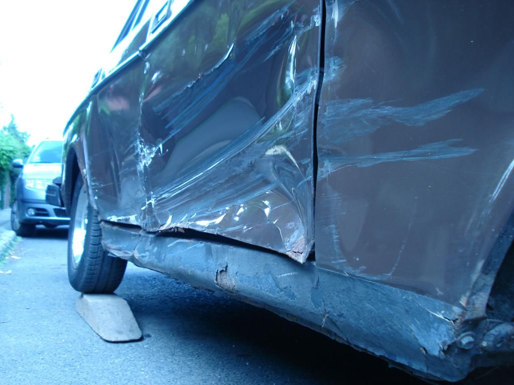

dude, what happened to your car? amateur drift attempt failed?! kuldell uzenetet Zora -nak. el akarja adni B21ET motrot.. ha erdekelne..
Naah, a car ran into its side at the near end of the previous ownership. Thats why it was so cheap. I bought it like that. :nod:
B21ET, hmm sounds good, but i don't have that much money to also buy an engine. Right now i hope i can put it back to road before summer ends... Then I will use it with this stock eng+trans combo for a while, because its in usable mechanical shape.

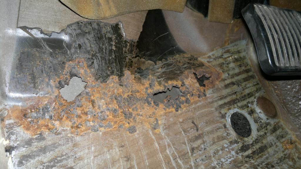

Gutted the interior to fix these nasty babies. :clap:
Drivers side floor is the worst, but all can be saved nicely. :nod:
Yep, thats the lower seatbelt mounting point...
Passenger side is better.

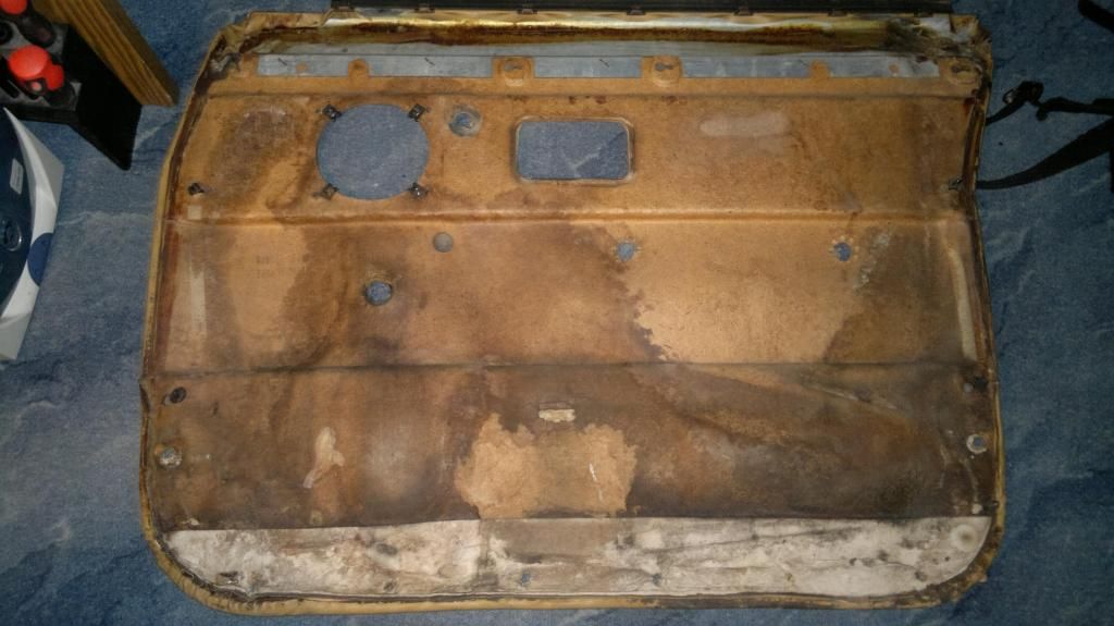

I want to keep these rare old tan door cards, because they really fit the car and i like the patina on them. Of course they have some little cracks but nothing serious. The drivers door card had a nasty soaked panel, which i will change to a better one. Its already in progress, i just have to clean them well and glue the leatherette onto the "new" panel.
Old
And the new panel
