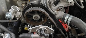

Cam Angle Sensor (CAS) for B230FK into Volvo 240
Speed signal is very clean. Cost of everything pretty low (sensor + connector $50, aluminum components $30). In black, everything is now also quite inconspicuous. I'm still considering integrating the sensor into the OEM cover.
Best Regards, ludi

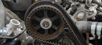

Looking to add a camshaft sensor myself and this looks very neat, how did u end up doing it with the marking on the cam wheel, so the sensor could pick it up?
I have drilled an M6 thread into a web of the camshaft sprocket and use a screw (a more suitable one than in the picture ... ;)). It is even easier in an adjustable camshaft sprocket. I would change all but one screw to stainless steel. Then you have the same effect and it is well balanced.
Best Regards, ludi
