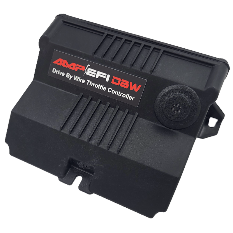

Has anyone used this controller, or one similar, for DBW control?
I'm a huge fan of microsquirt for it's cost, but the firmware doesn't support dbw control. I was looking into making a h-bridge driver board with some simple logic, but this hits the sweet spot where it's not even worth my time at this price point.
I want to dig into the safety side of it a bit more, but it looks like an easy enough controller to integrate into most systems.
