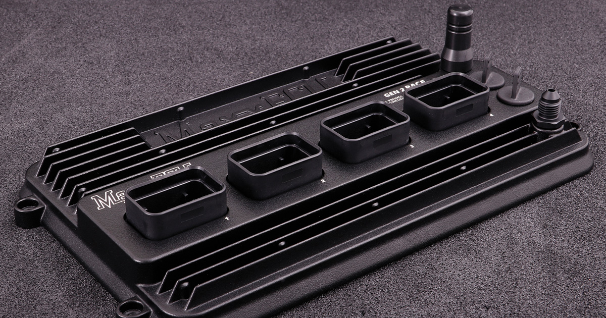

MaxxECU just changed the connectors on the new Gen 2 Race they released a couple weeks ago. I imagine we'll see the same on the rest of the lineup soon.
The superseal 1.0 connectors are a huge upgrade over the Molex CMC.
