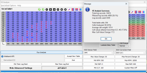

How does this compare to the TunerStudio veAnalyze capabilities?
Edit: here are the percentage changes that the default VE Analyze setup wants to make:
I mostly interested in how accurate (or not) this tool may be. If it is accurate I'd like to see how close I got by hand tuning my heap. I can tell you I stay +/- 3% on EGO pretty much everywhere except for my hot idle. I haven't incorporated an idle valve yet either, so I'm not too concerned about hot idle yet.
It's Pretty F'ing accurate....
Making my ego correction as aggressive and closed loop as possible did wonders for my tune. Yeah I probably shouldn't be at 120% correction during hot idle, but I've tried and failed to tune that out. I also have a problem with my flex sensor pulling about 3% fuel during wot but the ego just throws it right back in. If I could enter closed loop immediately after starting my car would run PERFECTLY.
The idea is to make the ECU not work as hard, if you get the EGO to calm down your base table is close to what the car needs, ego doesn't have to work as hard. Basically the tool gets you to where you could drive safely in open loop....
