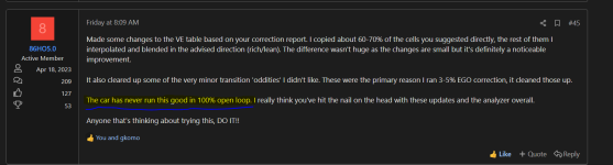

Thanks for running my old tune & log through your analyzer. I compared the results from the default TunerStudio VE Analyze and your results - they're similar, but certainly not the same.
I'd need to dig into the log file to see why some of the weirder changes were made, e.g.:
VE Analyze changed the 90kPa row, around 2600 rpm from:
1800 2200 2600 3000 3500
68 67 68 73 71
To:
66 65 _63_ 72 71
while your analyzer changed it to:
67 65 66 73 71
Maybe 90kPa/3000rpm didn't get enough hits on box and the VE for the rest of the row is wrong (way too big)?
Other comments:
It looks like your rounding is wonky - for MS2/MicroSquirt, the VE table only allows integers so values like 82.4 and 79.1 get truncated to 82 and 79. I think MS3 allows at least 1 fractional digit, but why does your analyzer keep to mostly integers?
I'd like to see some additional graphs
- a graph showing hits-on-box for all samples
- a graph showing hits-on-box for just the qualified samples, or simplified to green/yellow coloring for well covered regions.
- a summary VE change graph showing just the non-zero deltas, maybe with the qualified sample region lightly shaded?

So to clarify what I'm actually doing: VE table correction, only No timing changes, nothing else. MBT/timing is a completely different beast you're right that you can't do that reliably without a dyno...
On the GIGO that's honestly the part I've sweated the most. There's a lot of filtering happening before any data touches the table. Post-AE cooldowns, post-fuel-cut cooldowns, off-throttle non-cruise gating, neutral-AFR rejection, wideband delay correction all of that exists because raw logs are full of cells that look like they need a correction but are really just transient artifacts. Feed it a log of someone bouncing off the limiter with a half-dead O2 and it'll basically refuse to touch the table, which is exactly what it should do.
So that's what it is: a more careful pass at the same data TunerStudio's already working with No magic, not a dyno replacement. It's aimed at people already running iterative log-and-tune cycles. If that's not you, totally fair not everyone needs it.
The whole reason I am building this thing is cause of what you are saying the tuner studio software really is shooting in the dark , I really wanna tell you more about what the tool does but I feel like I'd be giving away too much info. But... The filters it has a lot to do with that, I feel like tuner studio is averaging in fuel cuts accell enrichment widebang lag etc, my tool does pretty darn good at reading and presenting steady state fueling for averaging....
Because I am dealing with tables like this, and my tool is a designed to be a multi pass tool, I am confident enough to try these fixes on strangers cars I am not confident enough to bump a cell more 10 ve points like tuner studio will... I'd rather make multiple small passes rather than throw the kitchen sink at it,. On integer tables it's intentional decimals truncate anyway. On 0.5-resolution tables I'm being conservative on purpose because I'd rather make small whole-number passes than chase noise to a tenth

Thanks, those new graphs are a big help understanding what regions were well covered by the log, and what cells were changed. For the final graph, I'd try using a green background for cells that weren't adjusted (OK as is), instead of the dashed green border.
