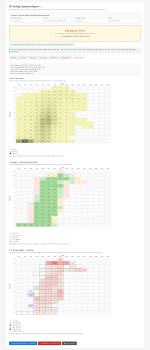

Here is the report below with heat maps and everything , it is a .html so just double click it and it will open in your default browser, your tune needs a bit more work. Perhaps give me a couple more passes with the tool if you want....

What is the context of these charts? Is this my original tune vs what you sent me?
This is what it looked like to my tool each time before I touched anything.
