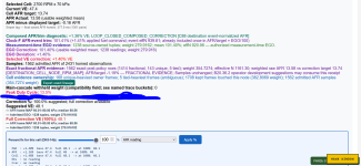

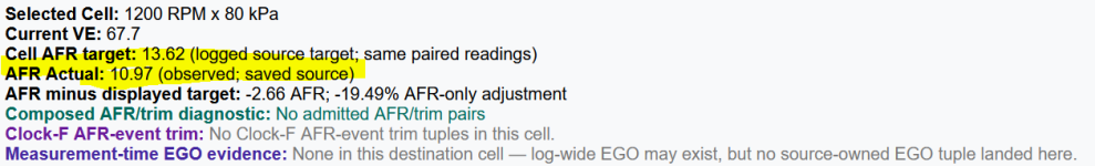

Wes... I am looking your log over tonight, just wanna give you some insight on what my tool reads , there is a lot of info to go over I like to take my time with this, so I am gonna work on it in parts since your table is so out of shape...

I am still with you, refining the deceleration filters, in the tool. that is the reason that your bottom rows are at 100 ego is correcting air on throttle lifts, i have it most of the way there I mean i can do things manaully but i would rather have to tool see the issue. I have that mostly worked out,
Autotune is correcting the air when on the way back to idle. I am filtering all the crap, and trying to make sure that i correct only steady state data even my tool was showing this as lean before my last update. I am trying to get this thing where some one can drive log and do one click fix, as it stands now its close. I will go ahead and send you a table pretty soon.

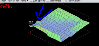

The table was such a wreck, that the changes I did I just gave EGO authority over your entire table.
Need a longer drive. If something seems off stop the drive. revert to your old table. Honest it was so out of whack it makes me nervous. The Tune I uploaded I changed a lot of things interpolated vertical from the sparse hits I did have, and like i said gave the entire table ego authority that just makes me feel better.

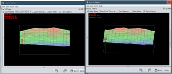

On the left the day we started and this latest version .

Out of curiosity, what was a "wreck"? I know I was playing with the reqfuel, as when I entered all my info into the calculator, I was seeing 60-90ve at idle. I was playing with the reqfuel-ve table scaling to try and get those numbers down. I felt like I was doing something wrong, but the car was running and driving (probably poorly, but nothing excessive). I figured any wonkiness was just a matter of tuning it out, but maybe I was building off a screwed up baseline?
