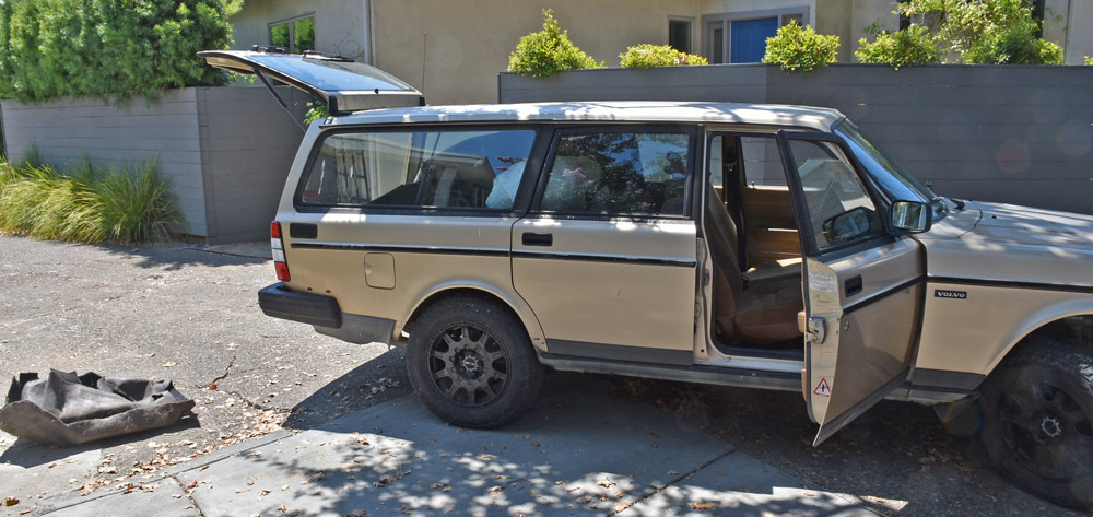

Flew down to San Francisco, and picked up this https://turbobricks.com/index.php?threads/lifted-t-1992-245.379118/
on Monday. Drove it home with a brief stop in San Rafael for some parts.
Had a couple hiccups along the way, standard old car stuff.
  • Wastegate line split
  • Car started overheating
  • Expansion tank sprung a leak
  • Somewhere around Wyoming, it started dying at idle. This got progressively worse. (ECU set a 1-3-3 code for TPS, possibly related)
But in the end, I got it back to MN.

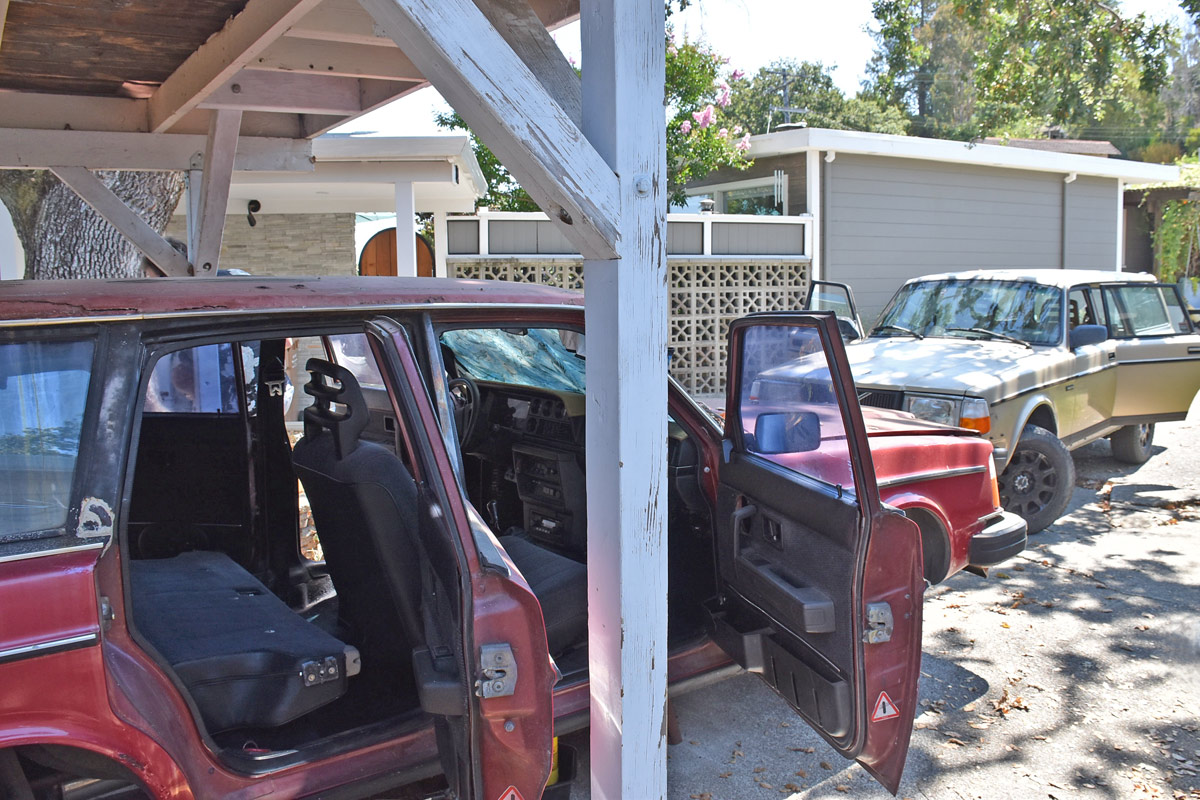

Nicely understated... :lol: that included most of a black interior from my oceanside rust bucket. I had expected to help Pinguin and his co-pilot dismantle their interior and complete a color swap, to keep the cargo area empty for other things on a long ride home. But they said no big deal, we've got room, we'll just toss it all in the back. :omg:
Less than an hour later, they're loaded up and gone. Glad it all worked out.
