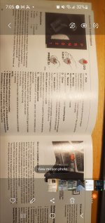

I didn't see any marks on engine to indicate it was a b21. I recall decoding the vin to see it's a B23F (though maybe I'm mistaken on how I deciphered the vin)? Do we know if any cars with a three speed had a b23f? My car has original manual and it implies that OD was just an option and didn't mention carbs.

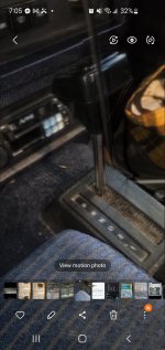

Judging by the shifter... I think this car came with a BW55 tranny and had b23f engine.
Regardless of what was original, it's definitely a AW70 tranny now... Not certain if engine is original.

Some pictures would be appreciated. I'm definitely confused as hell trying to picture a 1984 B23F car with a 3 speed automatic. :???:
My thought is that perhaps it does just have an AW70 with a failing/failed OD solenoid, and someone in the past has replaced the shifter with one from a 3 speed car for some reason. Unfortunately the VIN doesn't tell you what transmission the car came with, only the engine code.
It's definitely a 3 speed shifter, AW70 tranny and B23F. It makes the most sense that the tranny was swapped at sometime (300000km on car). But they didn't swap the shifter (which is a bit odd). And the selenoid failed or never worked. Looking online, I can't seem to find a selenoid... I'll try finding the wires and applying 12v. Though, someone spliced a blade fuse into the overdrive/rear defrost fuse location... Someone also installed cruise control, but I couldn't get it working (seems to all be there).
