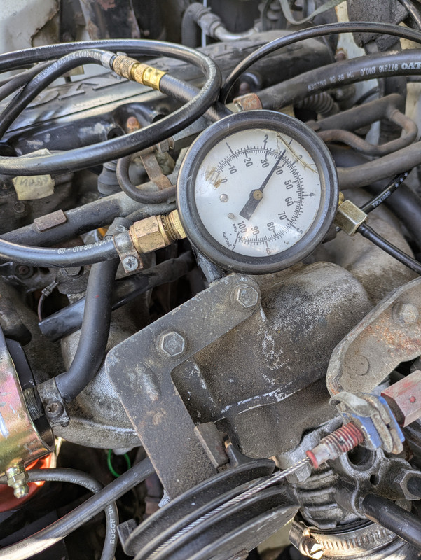

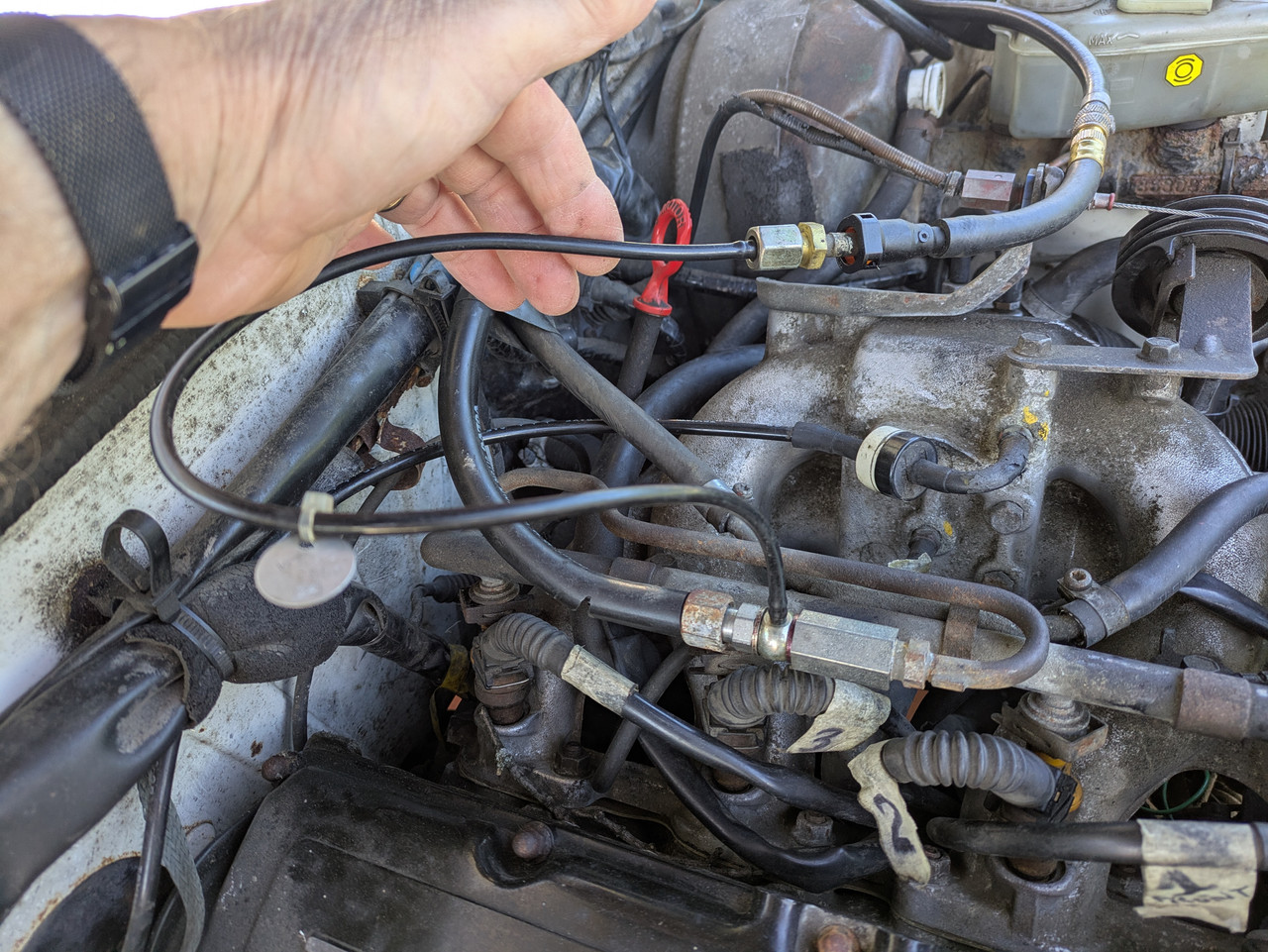

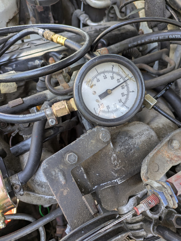

How did you install the fuel pressure tester and where?
I’m extremely interested in how you got this to work as I cannot find a port suitable to thread into my tester.
I'll add a pic later. It's an old Volvo tool, that goes between the rail and the fuel line with a banjo T that feeds the gauge.
Volvo 9995116
Includes the male/female I/O to branch the feed line, and the nitrile line ending in the same union joint, which is where I added the generic gauge line
9995265 rail/hose adaptor
