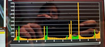

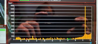

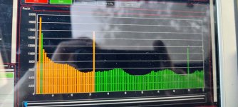

had a lot of issues with no start - no cranc sync. Lots of interferance from something. Changed the sensor, didn't do anything.
Went trough a lot of things.
Then tested by pulling the car, well the signal was better.
It was a bad starter bearing that caused the rotor to hit the stator and causing the issues - it was still the original 300K driven starter on the engine. New starter in and no more issues.
Now it starts perfectly.
