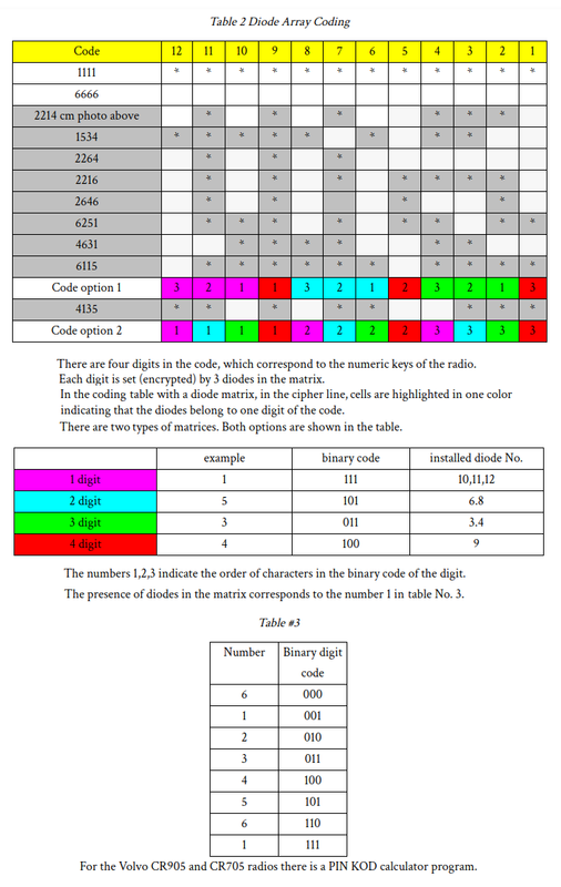

Unless the Internet is lying, your radio code is still set by soldering a bunch of diodes to the circuit board inside. If you pop it open, hopefully you see something like the picture below.
If so, you're in luck. You can either make notes of where a diode is or isn't (to get the original code), or take them all out and use 6666 as your new code.
^^^ out of curiosity, do you know the code for the radio pictured? Or how the diodes map to the code?
Google image search finds a Russian website as the source of the code:
Translating to English with Google Translate:
"The photo shows an example of coding radio CR-603, PIN KOD 2214."
Apparently it's not a straight binary number - each digit is coded individually and the locations of each binary digit are somewhat scambled. There's a table on the website which shows the arrangement. The table is kind of awful and so is the translated Russian, but I've managed to decipher it I think.
In this particular case:
Digit 1: Diodes 10, 11, 12: 010
Digit 2: Diodes 6, 7, 8: 010
Digit 3: Diodes 2, 3, 4: 111
Digit 4: Diodes 1, 5, 9: 100
So decoding the binary:
2 2 7 4
But also according to this Russian, "111" in the matrix is actually "1", not "7" ("000" is 6 and "001" is also 1, FYI) so the final code is:
2 2 1 4

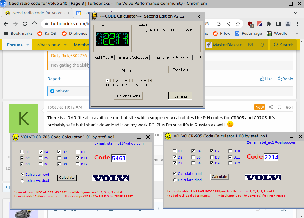

There is a RAR file also available on that site which supposedly calculates the PIN codes for CR905 and CR705. It's probably safe but I shan't download it on my work PC. Plus I'm sure it's in Russian as well. ;)
Probably contains the same DOS programs I've had here since late 2001.
The upper "CalcGen" version lets you switch the diodes around, in case you started counting from the wrong end, while the 905 version gives a different code for that sequence. Maybe it uses the "other" version of the matrix?
