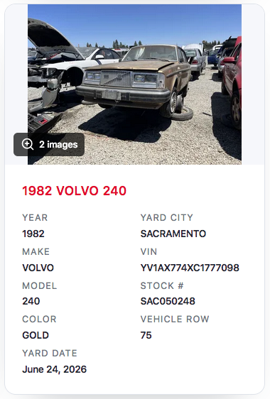

My guess = Sacramento i-pull-u-pull
Anything left of it? I considered looking at the front suspension, but I just discovered its existence a couple days ago. I figured you vultures would have picked it clean long since... especially if there was any sort of July 4 sale pricing...
idk I just pulled, front airdam, insulation, pass kick vent, grill and headlight surrounds. I was in/out in 14 min and the suspension was all there. I have a v6 front sway bar if you need that
