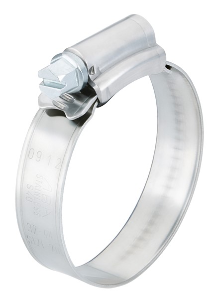

I had a set of NOS silicone radiator hoses that came with the 77, installed those with the stainless ABA clamps
does anyone know where to order these individually ? this place has them but you have to order 10 minimum
IPD sells ABA clamps by the eaches.
