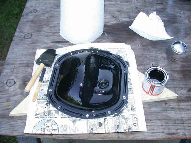

While I was down there at the diff I realized I should probably just change the fluid.. but then I realized the gasket on the pumpkin was leaking. Sooo… image0.jpegimage1.jpeg
Figured if I’m going so far as to pull the cover I should just strip it and paint it before remounting and refilling! I’ll post pics of that when I’m done
Is that an aluminum cover or a steel one? I'm about 20 min south of Hanover. Just the mention of "twinax" caught my curiosity. Plenum rated??:p
From http://cleanflametrap.com/pumpkin.html
it’s aluminum! I’ve been surprised how much is used in these vehicles as I always thought they were just dumb steel boxes. Where you at in md? I just moved up here from New Windsor and work in Sykesville. I honestly have never heard of plenum rating as I’m mostly a lab rat and stuff I build never makes it into the Feild so I only care about basic function.. but it’s pretty heavy duty white wire!
