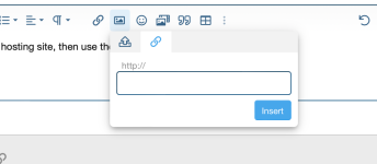

AFAIK you have to use an image hosting site, then use the IMG/URL to add it. You can directly upload small images, like screen partials
