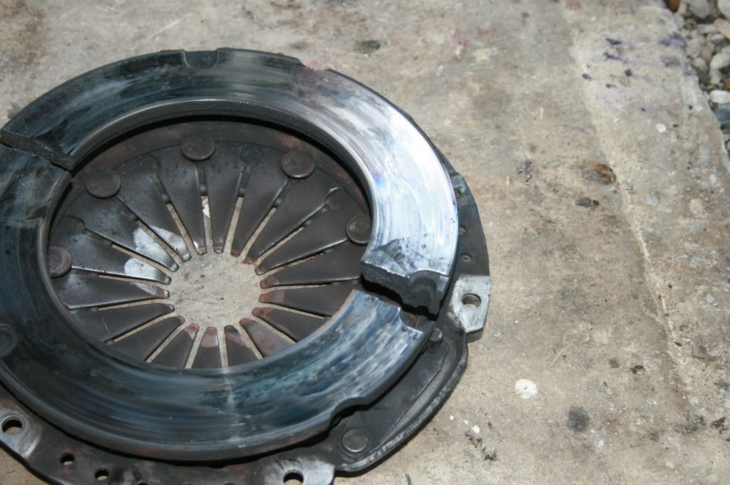

For the last week I have had problems getting the car in gear. It has been getting steadily worse. Yesterday with the pedal all the way to the floor it will not go into 1st or reverse unless I turn the car off or speed match the gears. I had to drive to school and just when I got there I pushed in the clutch and there was a pop and the pedal didn't return to it's normal position. It is sitting about 2-3 in off the floor and whenever I press the pedal there is a whirring sound like something metal is pressing against the flywheel.
I went to a mechanic Friday and they said the clutch is shot and there is a spring and shavings laying around when they opened it up. I was only there for like an hour so I am kinda skeptical about what they "opened up" in that time and were able to put back together in 10 min. Before all this I was having the same problem and I went to my mechanic back home and he just adjusted the clutch cable and problem solved for like 2 months.
So what do you guys think it is? The mechanic quoted me 1400 for the clutch job (400 for parts and 1000 for labor) and I don't have that kind of money right now. So I need to know if this is either something I can fix (if it isn't the clutch) or if I need to get a beater until I can afford to get it fixed.
. If they found a spring inside the bell housing, the clutch plate must have disintegrated or somebody left a spring in there.
