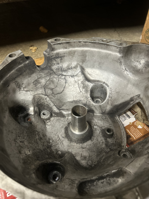

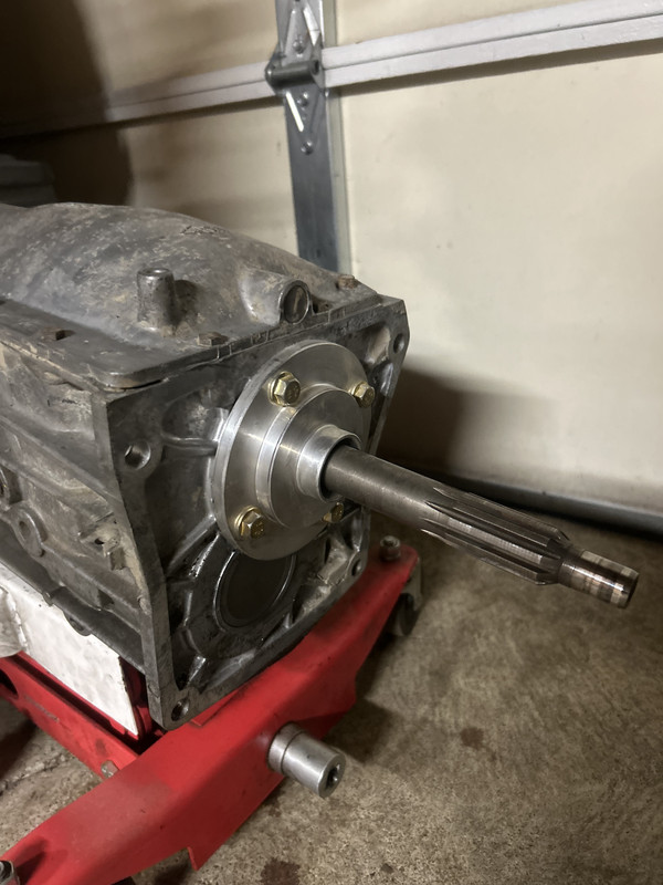

I want to post some info on the Deeworks Kit with the custom bearing retainer and bearing sleeve installed. The OD of the throw out bearing sleeve is ~1.258 and the ID of the threaded sleeve for the bearing is ~1.433. I assume the stock sleeve on the stock retainer must be a tighter fit than this; I do not have one on hand to check.
Also, a hole would need to be drilled and tapped for the anti rotation stud. I assume in this original post, Carver has used this plate with the stock retainer and has machined the large hole in the bellhousing to allow use of the stock retainer that works with the hydro bearing. In Stiggy Pop's post, I am unsure what adapter plate is being used, but I see that he has the same issue here with the stud (or lack thereof). I'm curious as to how that problem was solved, as I don't see a solution in the pictures.
I believe my current options are to see if BNE can machine my bellhousing to make it work with the Deeworks plate, and then install a stock bearing retainer. I think this gap could be remedied with another sleeve that fits over the sleeve in the bellhousing to make a snug fit. I do not have access to a lathe until January and want to keep this project moving though. Or, I just get a stock hydraulic setup using the clutch fork.

Deeworks custom bearing retainer:
Deeworks throwout bearing sleeve in the bellhousing:
Here is the seemingly excessive gap between the Deeworks bearing sleeve and the threaded sleeve from the Tilton Bearing.
