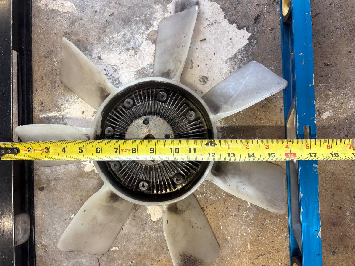

4cyl redblock '81+ Plastic fan blade overlaid on B280F fan blade:
B280F fan blade 16.5"⌀ (nominally w/crude carpentry tools).
4cyl Redblock '81+ Fan Blade ~15.5"⌀

Lacking a diesel radiator picture for both 200 & 700 and the fan shroud for late ‘81- 260 that uses the larger plastic clutch fan (pictured) to compare w/ the 7/9 B280 fan shroud (pictured).
I want to say the V6 sits ~ 1” lower in relation to the radiator in 2xx, unsure with the wider radiator if the fan is offset more toward the driver side on 200 vs. 7/9 on the wider V6/D24 radiator models like it is on the 4cyl clutch fan models?
Fan center line comparable distance from crank center line in SBF & PRV-6. Many SBF fans are ~PRV6 size ( trim the shroud fan blade opening larger if need be, looks doable given the shape?).
