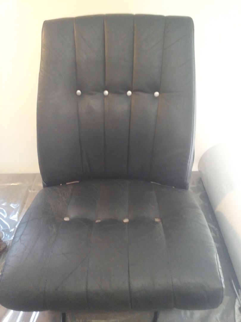

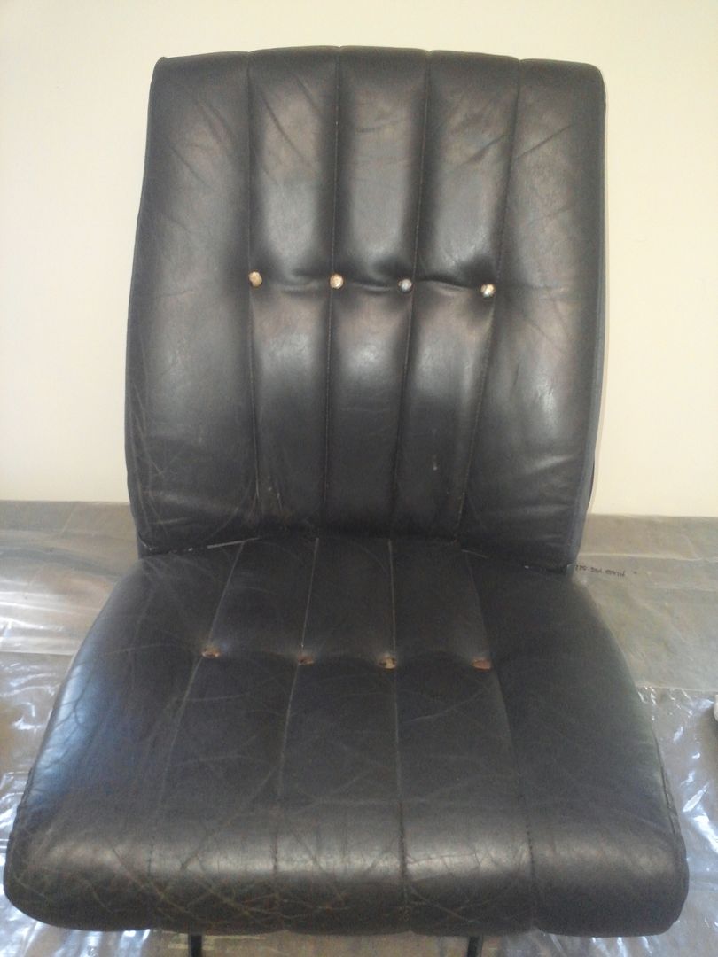

The passenger seat is about as bad as my leather gets even after the Rejuvenator and Pristine Clean and where I started. This photo was taken before the old dye stripping and what I was trying to bring back from the dead.
Here is the whole passenger seat before starting.

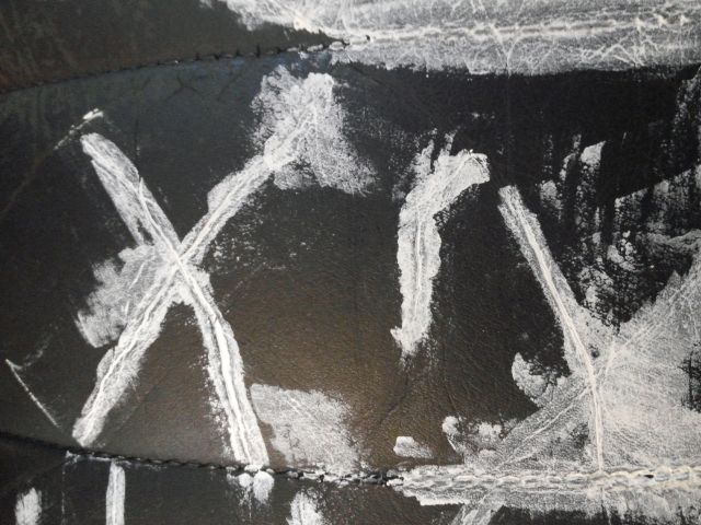

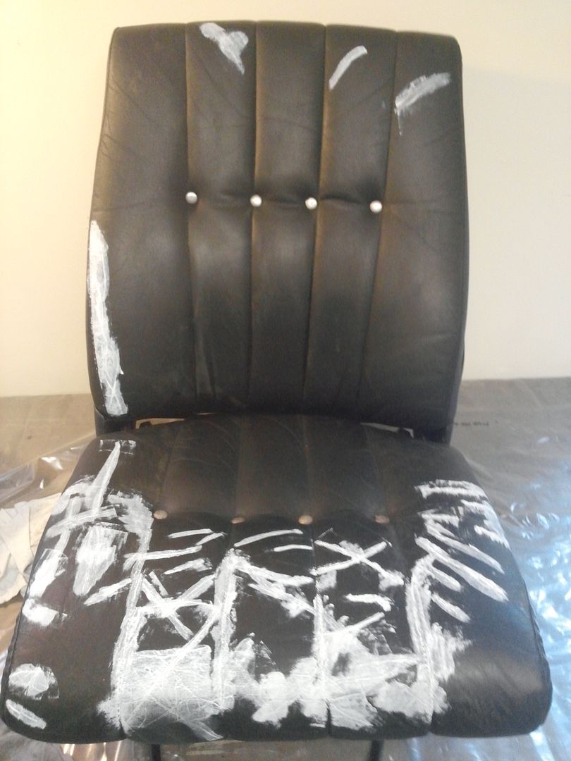

. . . and an hour later after stripping:
I was amazed at how much of the surface dye the solvent removed. It does not appear to be petroleum based but sure does loosen the black stuff and even quickly removed what was left of the black finish on the steel buttons. The leather cleaned in places to nearly the original brown tanned hide color. The majority remained with a black color but seemed to be at the point that little addition black pigment was coming off on the cleaning rag with additional application of the Prepping Agent. The Leatherique instructions say to use 600 grit wet or dry paper with a block but I had some of the finest grit auto paint scuff pads which might be more like 400 grit and that worked much better than the paper. I was careful not to scratch the leather.
I used a damp cloth to clean the areas scuffed with the solvent and rinsed it in a bucket of water. What came off the leather was a lot of dye/lacquer finish that not only blackened the rinse water but left a lot of sediment in the bottom of the bucket. George at Leatherique suggests using only a slightly damp cloth to pick up the residue and not to add dampness to the leather.

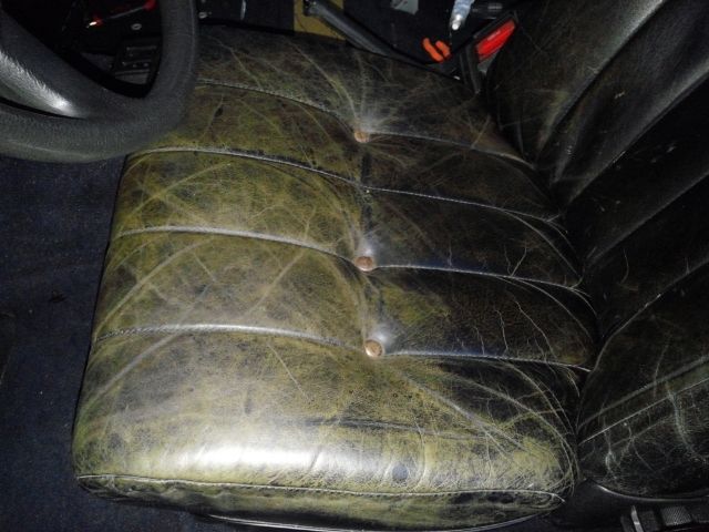

There were no real through-the-leather cracks and this was the worst area of the entire interior. The seats have been soaked with the Leatherique Rejuvenator, cleaned with their Pristine Clean extensively at this point and cleaned with their Prepping Agent. The leather is back to nearly hide condition and in places the original black dye has been removed so as to show the brown 'tanning' color of natural leather.
Dye would probably suffice for my project but I have a small jar of Leatherique's crack filler. The instructions say to paint the filler into the cracks with a small brush but it is impossible to keep inside all the lines. Then I resorted to a small plastic squeegee to get the filler into the cracks. Of course, that left a lot of the un-cracked leather with white filler on it. The thought being that if the finish dye is going to color the white filler in the cracks then it will color the filler left on top of the leather. Leatherique suggests adding a drop of dye to the filler when working with dark colors but I used so little filler that there was a concern that it would be thinned too much. Even with all the repairs in the photo I probably didn't use a half teaspoon of the stuff.
Then I got the 600 grit paper and block out and finished sanding the leather surface to a final finish ready, I hope, for the dye.

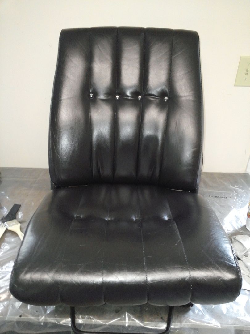

This is after one coat of the dye but it is still damp to the touch and has a shine that reduces as the dye dries:
And here is the driver seat that started out in better condition and has dried for several hours:

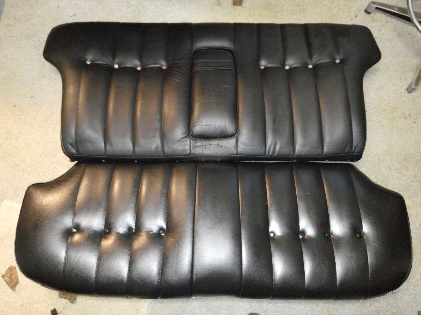

At this point I took on the rear seats that, as I mentioned, are in much better condition than the more used front ones. I took Leatherique's advice and quit using a damp cloth for Prepping Agent clean up and moved to paper towels . . . lots of paper towels. Three scrubbing efforts still produced some black lifted off but a substantial amount of the leather was getting back to its original tan condition. I then tried the alcohol cleaning that had been recommended and even more old dye came off. That was enough cleaning.
Here are the rear seat and back after application of dye to the seat and the back cleaned and ready for finish tomorrow morning.
I have to comment that the leather looks even better in person than depicted in the photos.
