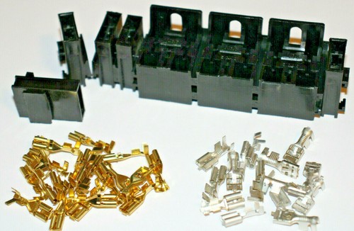

Forgot I also wanted to share this. Most of the generic stackable relay holders I would find online didn't have matching fuse holders but luckily found this ebay seller, has a few different kits and options. Bought the kit linked.
I have these, they are great, also different wiring size options for the pins for the dutch supplier I use: rdae.nl
