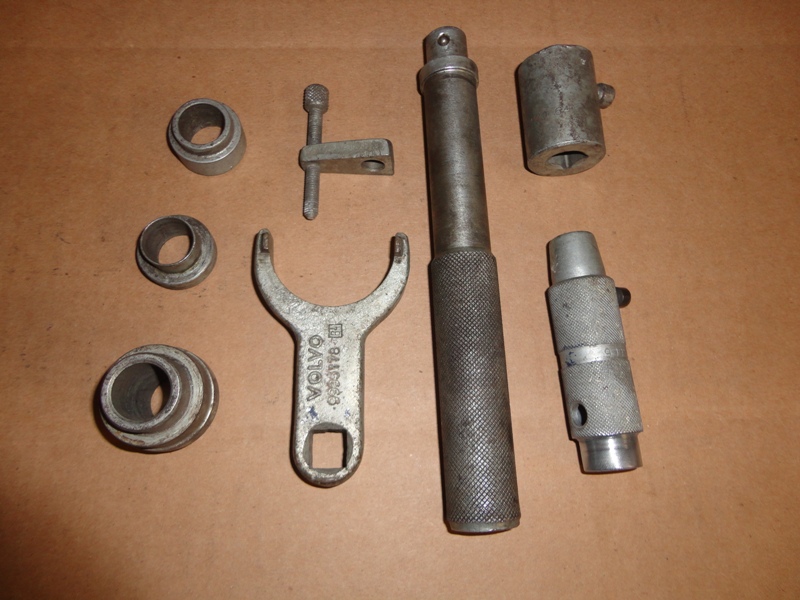

The greenbooks available online don't cover the ZF racks so I scanned it and uploaded it to my server.
Hit me up if you want to borrow the ZF rack tools

I rebuilt my zf last fall with the vp rebuild kit. I posted some crappy pictures/ made a post here of the rebuild. Yes u will def need to borrow those tools. I had to weld some junk together for that big tube nut. I think all in all with new tie rods i spent $200
